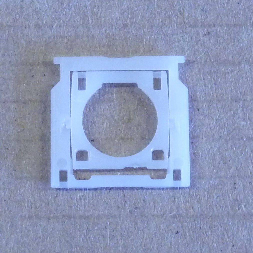

Earlier today, my "T" key popped off! Now, I have extended warranty, but I'm not in a country where there are Apple stores. It's a late 13 MBPr, with key mechanisms that look like this:
Now, I watched this video:
and when he latches the bottom portion, he then pushes on the top portion and there's a click, which is non existant on mine. I then put the "T" back on, and it's very wobby and comes right back off. Anyone have any advice? I don't want to spend $10 on a replacement mechanism when I'm not sure that's the reason.
Could you photograph the connector on the keyboard? Are you sure none of the metal brackets are bent? (This is somewhat common, and still easy to fix)

For anyone that will read this in the future, I ended up ordering a replacement plastic mechanism from the ebay seller the_macbook_pro. (cheaper than other options) It arrived in a week and 2 days (from the day I hit "Buy it Now") and it worked! My T key is sitting where it's supposed to be without popping out!
