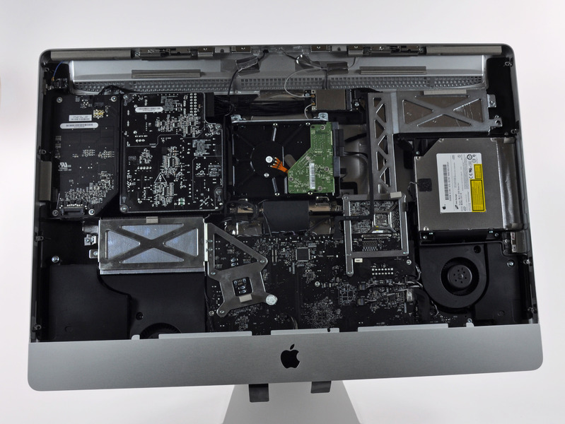

    Could be. I mean whats that behind the screen in the lower right?
    [​IMG]
  17. spcdust macrumors 6502a
    spcdust
    Joined:
    May 6, 2008
    Location:
    London, UK
    #17
    Looks like a cooling fan directly below the Superdrive.
  18. Kronie macrumors 6502a
    Kronie
    Joined:
    Dec 4, 2008
    #18
    Exactly, and is that the GPU or the CPU just to the upper left if that fan?
  19. tomacintosh thread starter macrumors regular
    Joined:
    Aug 25, 2005
    #19
    Thats the GPU on that side, with the heatsink extending up the left hand side above the SuperDrive.
