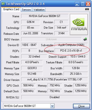

Just noticed this on my uMBP 17" (the first 17" version), while running XP in Boot Camp.
GPU-Z is reporting that the 9600 M GT is running with only ONE PCI Express lane! NVIDIA control panel is showing the same thing!
Am I seeing things, or is it really only using 1 lane? The chip definitely supports x16.
See attached screenshots.

Just checked on my MPB (Santa ROsa model with 8600M GT)
And it shows PCI-E x16 @16
Sounds weird that the 9600m GT should run @1x,
could be a bug in GPU-Z tho.

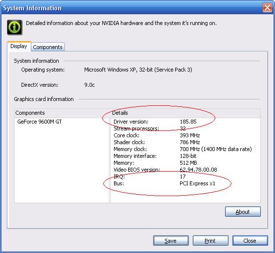

I just updated to the latest NVIDIA reference drivers for notebooks, 185.85, and I'm still seeing the same thing.
I'm guessing Apple must've crippled the # of lanes in their BIOS emulation layer. OS X shows the chip as running with 16 lanes.

Calm down 🙂 Apple is definitely cutting costs here and there, but I doubt this is the case here. It's much more likely that the driver is reporting the number of lanes incorrectly. Using 1x PCI-Express causes a massive performance drop in graphics performance, unlike the SATA downgrade reported in the other MBP.

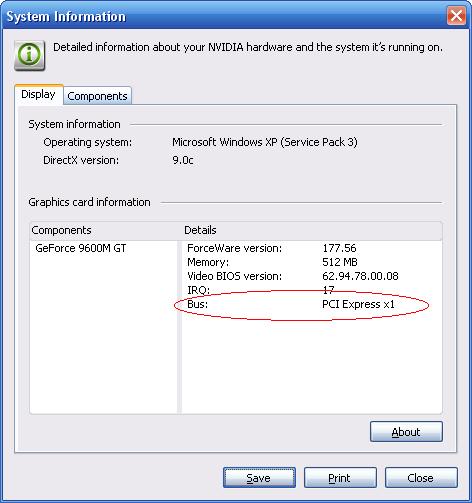

Already updated to 185.85 (latest notebook reference drivers available). Still showing x1 PCI-E lanes.
I wonder now if it's a difference between the original uMBP 17" (the one I have) vs. the new revision.
The only other thing I can think of is the NVIDIA chipset drivers. I checked NVIDIA's site if there were updated ones, but I can't seem to find the right ones.

Well I think I found the culprit.
I removed all Boot Camp related drivers and software from Add/Remove Programs then reinstalled them. Suddenly I had x16 again!
But as you guys and gals may know, the default driver settings cause the 9600M GT to run at full speed all the time, which heats things up quite a bit. So I had previously applied the registry hack described here to downclock the GPU. This apparently causes the GPU to run at x1 speeds. To get it back to x16, I have to 1) remove the registry changes, then 2) go to the NVIDIA Control Panel and toggle PowerMizer off, then on, then off again.
Personally I'd rather have the system run cooler and with better battery life than have full speed all the time. But at least I know I can switch it back to x16 if need be.
The only thing I'm wondering is if the GPU automatically switches to x16 under high demand, like gaming. Obviously I can't see the GPU-Z screen while playing a game, so I can only wonder if that's the case.
