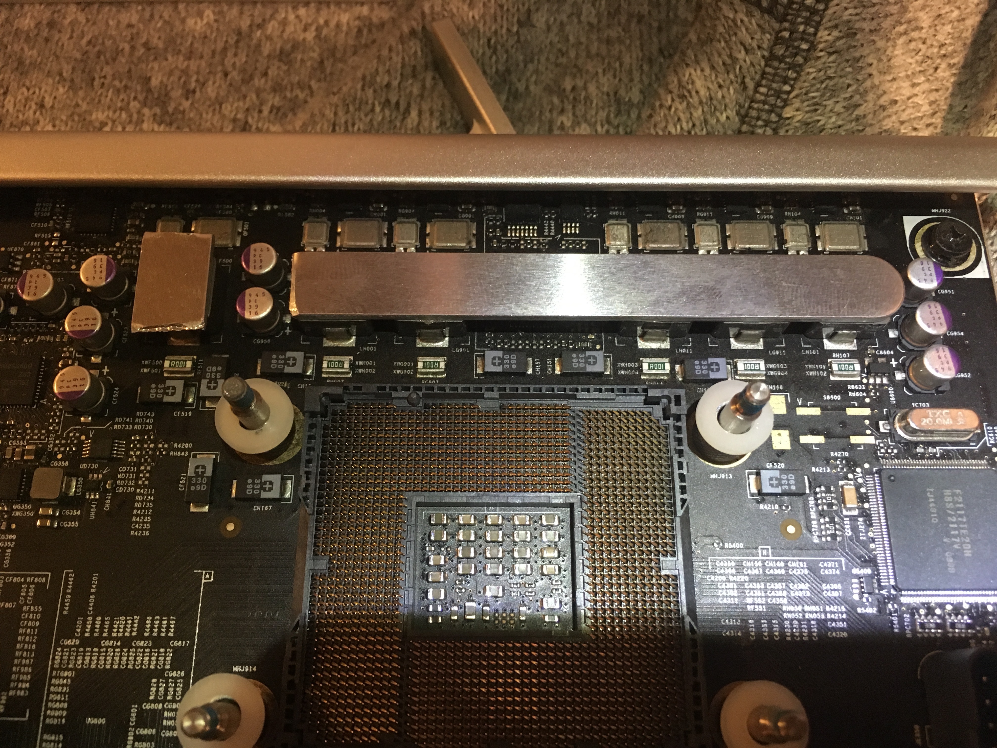

I did not have any thermal pad to bridge the gap over those other chips under the heatsink (not sure of name). So I went to the craft store and found some aluminum bracelet blanks that look exactly like popsicle sticks, but aluminum. I cut these, put a bit of thermal paste under them, and they perfectly bridge the gap to the thermal pad still on the heatsink (see pic). I'd guess this is much better than doubling up on thermal pad.

I do like that chunk of ally as a heatsink 🙂
