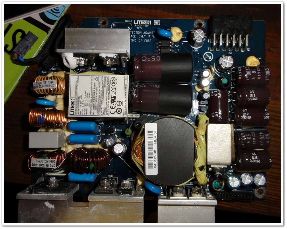

Well I pulled the iMac apart today and extracted the power supply as it does not appear to be the power switch. Looking carefully at the back of the board I found a surface mounted component that has overheated and discoloured the surrounding board. The solder has also melted and solidified out of shape where it is soldered onto the board.
Here are some pictures showing what I mean.
The highlighted area is where a component looks to have been badly overheated.
A close up of the component.
Identifying label.
Component side of the PSU.
I've been looking for ways to test the PSU without any luck, does anyone know which terminals turn it on and what voltages should be between the various terminals??
Also I can't identify the component, does anyone have that info?
Everything else on the board looks OK including all of the caps...
I've found a number of companies selling the power supply but before I order one I was hoping to get confirmation that its definitely defective...

I received the powersupply from DV Warehouse and installed it tonight.
Success!!! She booted right up and works perfectly.
