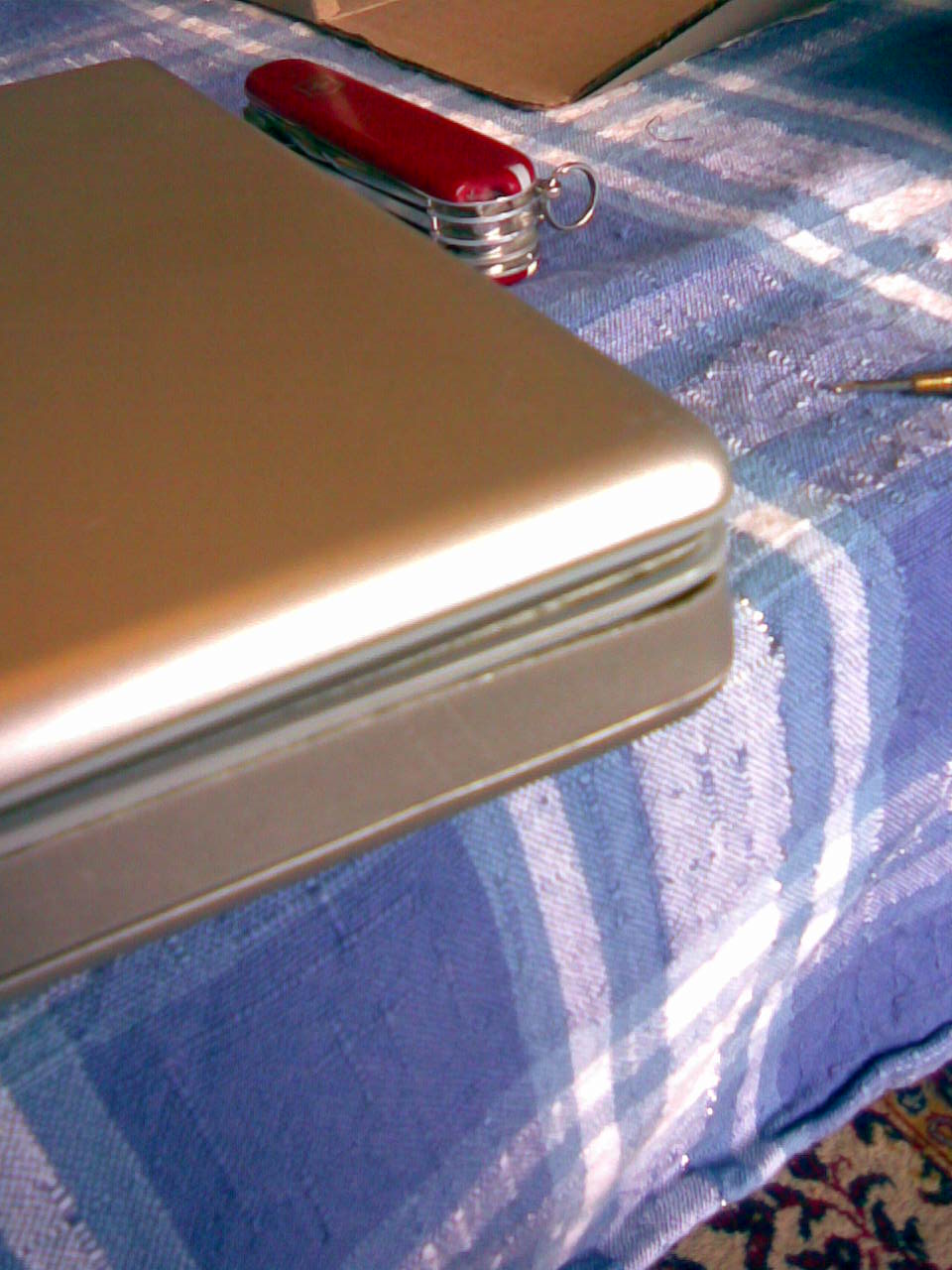

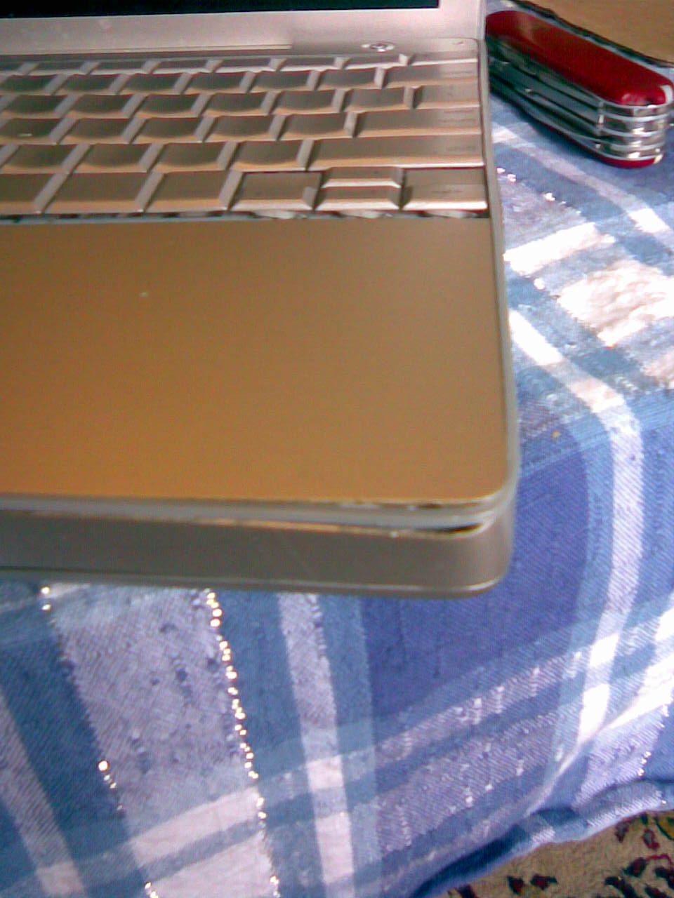

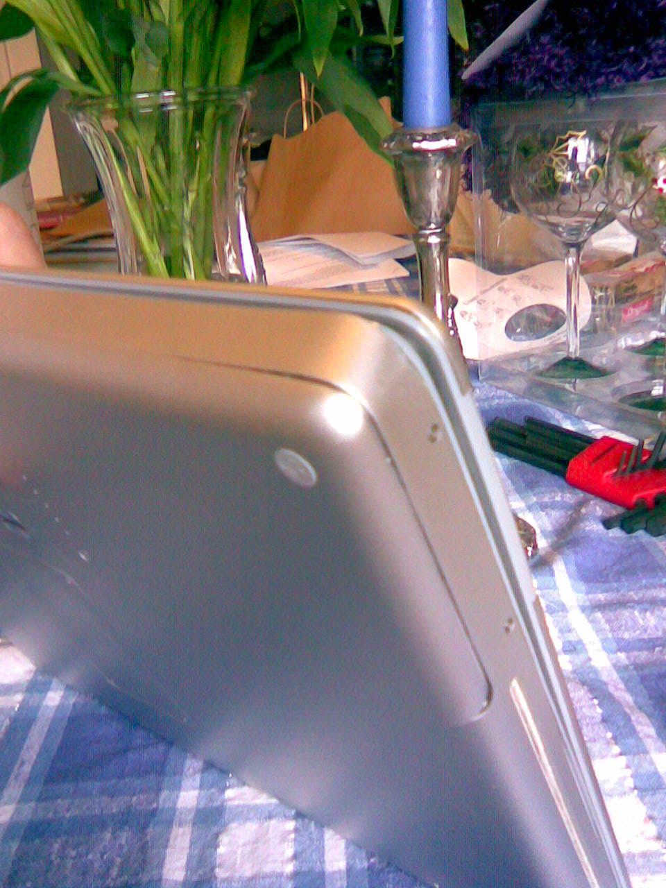

Getting a look at the inside of the case, there doesn't appear to be any real damage or loose cables. So, I'm left to wonder what the problem/damage really is. The dent in the case (where it hit the floor) is right next to the battery bay, so there wasn't anything right there to be damaged.

Sorry to hear about your loss.. do you have any pics of the damage?
No. I was a bit focused on getting the HD out to retrieve the data. I had a HD crash a couple years ago, and the loss of data was devastating. I'm glad that it looks like my wife will be spared that, at least...
Was the PB running when it hit?
I believe that my wife had just closed it, so it was in the process of sleeping itself. However, I don't think it had finished the process, as the fan was running when we picked it up off the floor, and didn't stop until I did a hard shut down.
Okay, so now that my wife's PB is back together, I've taken some pics:

IT LIVES!!!!
It took a bit of figuring, but it turns out that the problem was that the Airport card had been knocked loose! As soon as it was properly seated, the computer started right up. No more panic on boot!

They're pretty expensive.. at east they were. I once dropped my first PowerBook and had similar damage. I looked into new bottom casings and it was in the $300 range for the part, more if you want it "installed", just incase you're worried you won't be able to take apart everything and put it back together nice and aligned.. Apple quotes $600 to put a new one on for you I think. There are some third parties that will do it as well.
Aesthetics aside, my PB was fine! I actually opened it up and used a ball-peen (sp?) hammer and a few different improvised padded tools for knocking the corner dent back out. It made it look alot better but I don't know if I'd reccomend it... I don't think I was thinking rationally at the time.. but I was able to make it look pretty good in the end.
