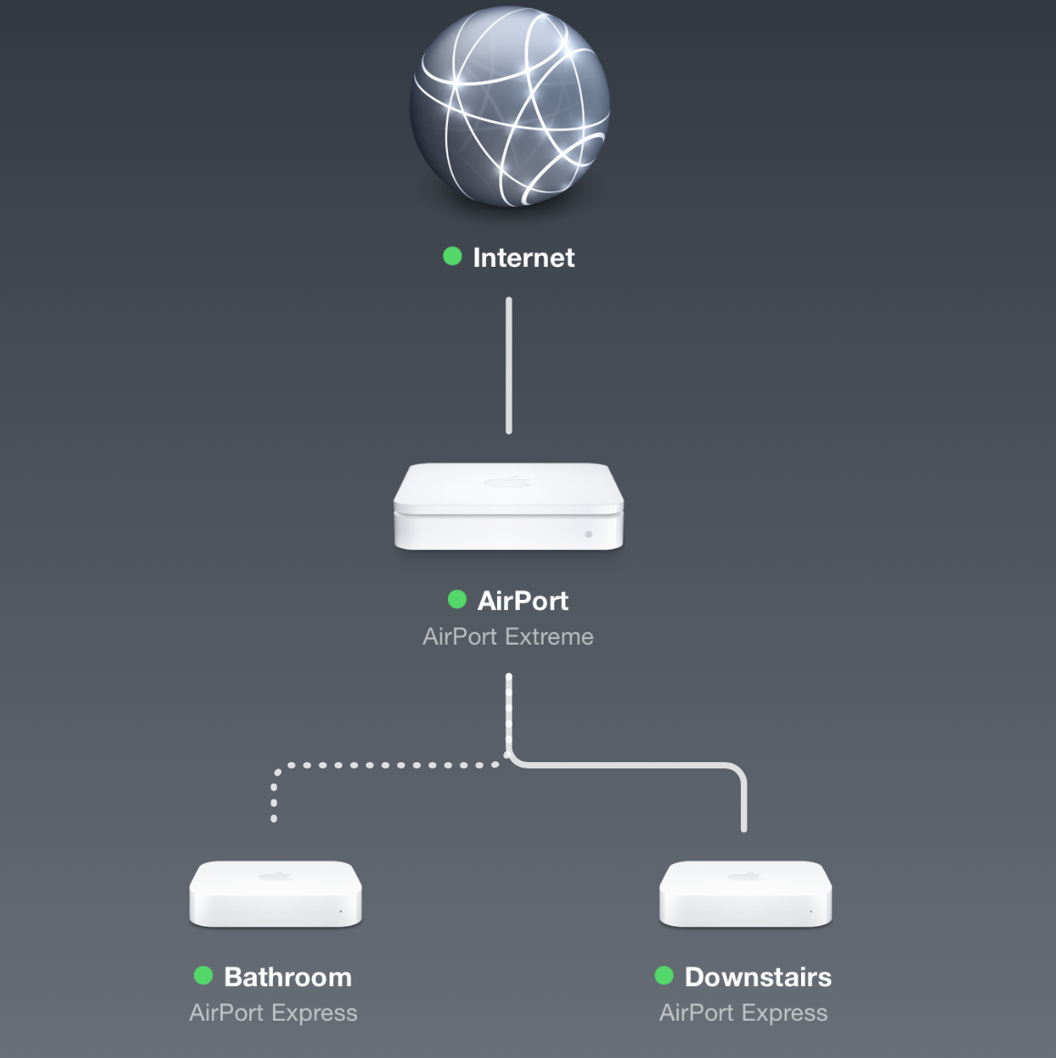

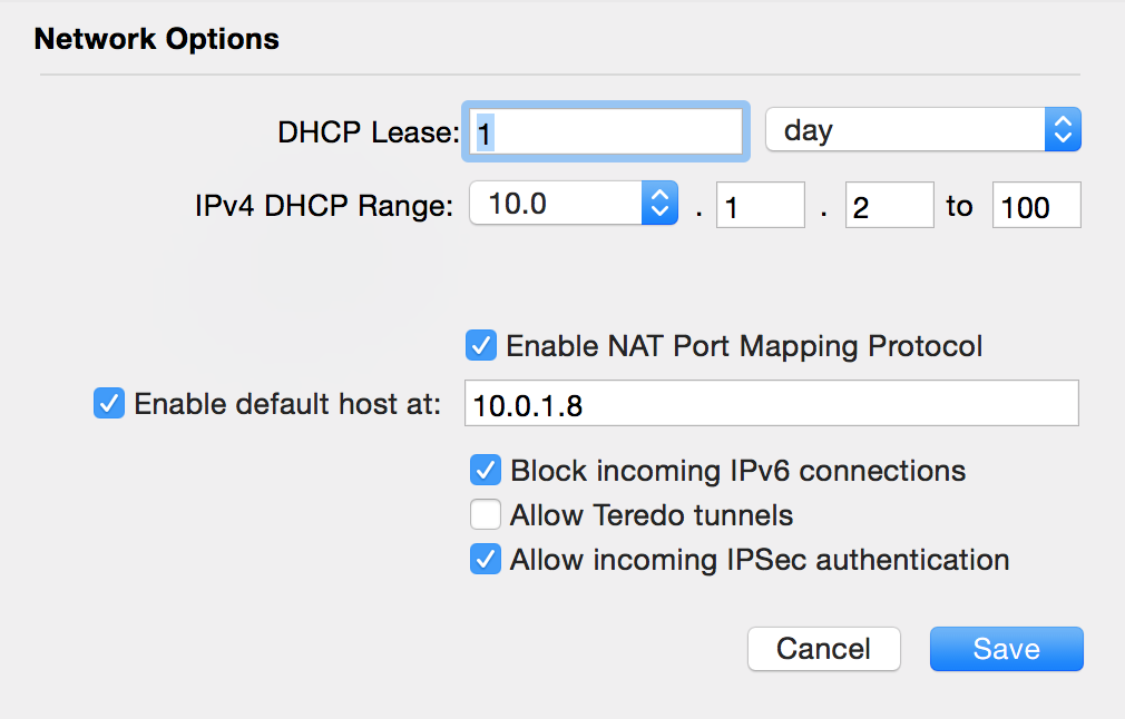

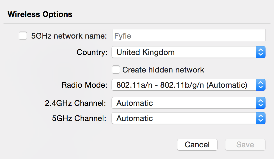

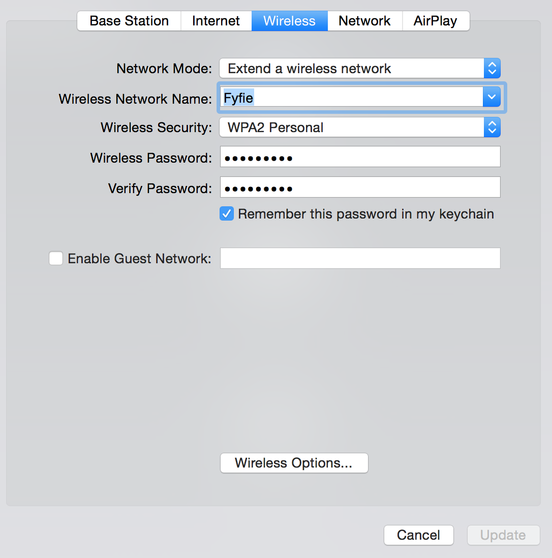

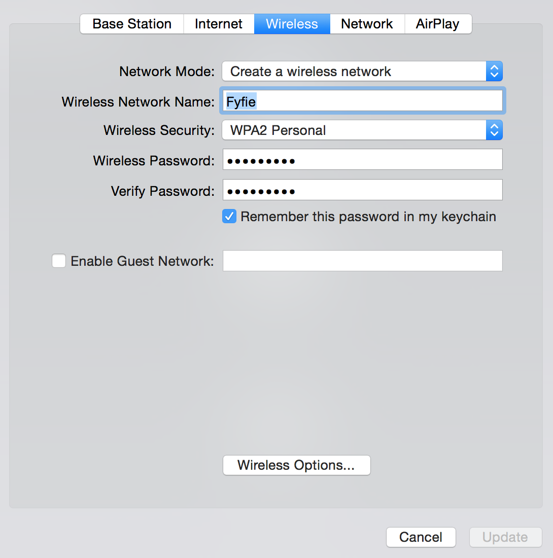

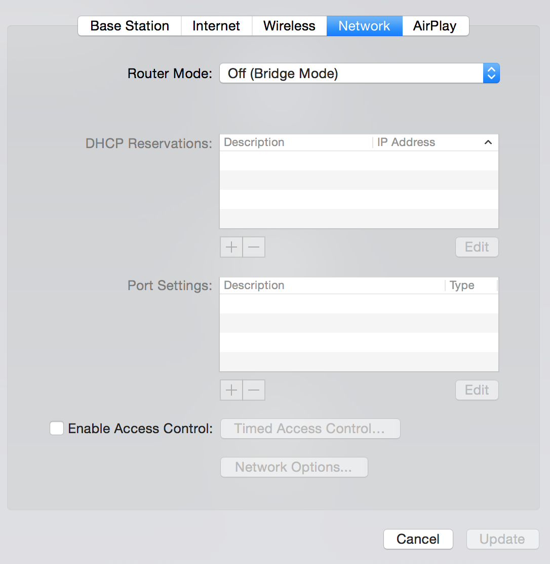

Hi,
Thanks for taking the time to reply. Here is my current set-up. I hope this can help clarify in some way.
For the downstairs Airport Express I have it hard wired using an Ethernet Power Plug.
The bathroom Airport Express is currently 'Extending a wireless network' through WiFi.
I'm unsure if I should be checking the '5ghz network name' or amending the channels in any way to help? I see you suggested entering a different name for this network. Can this be left the same or should this be named something completely different? I'm also not sure on the signal strength/noise levels i'm receiving. Do these look okay?
Regards,
MoFish
Airport Extreme
Airport Express (Downstairs) Wired Via Power Plug
Airport Express (Bathroom) WiFi
