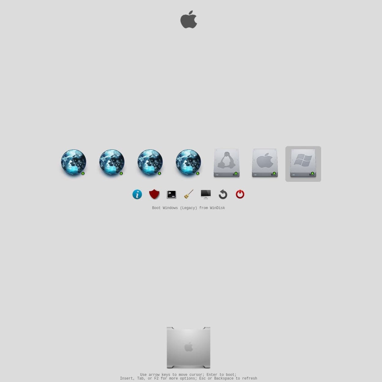

This is a guide to setting MyBootMgr up for configuring and installing RefindPlus and optionally, OpenCore, to multiboot Classic Mac Pros (3,1 to 5,1) as well as equivalent Xserve (2,1 and 3,1). With OpenCore present, the setup involves chain-loading Mac OS from system optimised OpenCore instances via RefindPlus and loading other items directly from RefindPlus
This Post is the Only Required Reading
Relevant items from the thread are added here
The RefindPlus|OpenCore setup created by MyBootMgr is benign and can be implemented and removed without changing any fundamentals. As a result, the setup can be safely tested; subject to ensuring that it is implemented on a physical disk that only contains data, or as a minimum, one that does not hold the default natively bootable Operating System. This permits disconnecting disks to isolate issues, if required, while still being able to fully operate the host unit afterwards

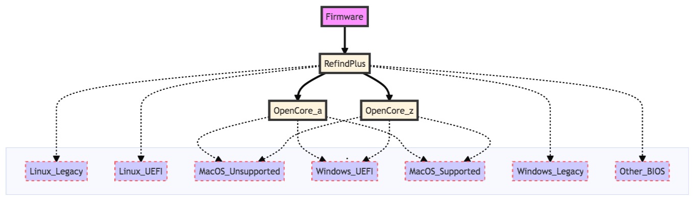

MyBootMgr provides maximum flexibility levels and sets things up to suit specific setups and preferences based on the specific hardware in use. The setup provides multiple operating system pathways that largely remove the need to keep emergency/recovery discs/sticks; as the pathways permit bypassing OpenCore to boot into supported Mac OS instances directly and on demand. This dramatically simplifies maintaining OpenCore as well as other items
While OpenCore is far more powerful and can provide multi-booting along with several other features, configuring RefindPlus is a lot easier and it is very difficult to break things when it is the default boot item. RefindPlus is primarily focused on starting boot loaders and it does this task consistently and reliably. Issues faced with running complex tools such as OpenCore are easily recovered from by simply restarting RefindPlus and selecting alternative working options
With this arrangement, OpenCore would handle booting Mac OS and there can be multiple instances as mentioned. A path to Mac OS via RefindPlus should be maintained to support easy recovery from issues. This arrangement supplies all of the power of OpenCore, fully tamed by the simplicity and flexibility of RefindPlus; which MyBootMgr can set up alone, without OpenCore, if preferred
More on the BENEFITS of the Setup​
MyBootMgr creates up to five (5) OpenCore instances depending on selected specification runtime options. Additional instances can be added by duplicating/renaming generated OpenCore folders and then amending the configuration files

RefindPlus is primarily a tool for starting UEFI programs up
As a program is the same whether loaded via the Finder, the Dock, or automatically on Mac OS boot,
so is OpenCore the same whether started from RefindPlus or automatically on Mac start up

  • In RefindPlus
    • The default OpenCore instance is always mapped to Keyboard Key '1' on start
    • The "Updates" OpenCore instance is similarly always mapped to Keyboard Key '2'
      • Some implementations may have up to three (3) additional instances (See Note below)
      • Installed operating systems are mapped to Keyboard Keys '3,4,5 ... 7,8,9 ... C,D,E ... W,X,Y' (See Note below)
        • If you have an external disk or a disc drive with a "Valid OS", this will come in at Key '3' and displace others
        • To boot such disks/drives, attach the disk or disc drive, restart your machine and press Key '3'
        • You try using Key '3' (without such disks) to boot Mac OS to get the keyboard shortcuts from the debug log
      • NOTE: App_Helper:- ConfigFactory may generate 2, 3, 4, or 5 OpenCore folders, depending on the selected implementation options. Hence "Key 3" above, based on a two folder setup, may be Key 4, Key 5, or Key 6 instead

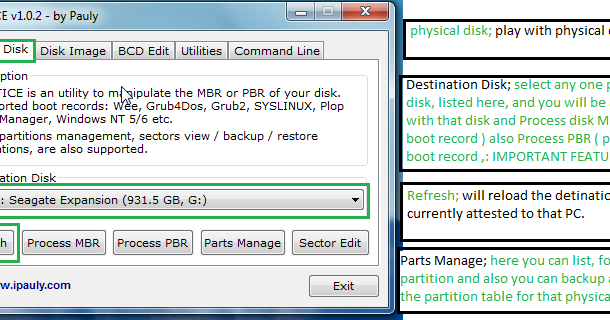

By the way, do you know how can I install Windows 10 in UEFI mode, to boot it from OpenCore? Some simple detailed guide, like this one? I had MBR installation of Windows 10 on the separate SSD, I used command mbr2gpt, converted the disk, and now when I try to boot Windows from OpenCome it boots, but results in error no bootable drive; what is interesting that I can boot in safe mode. And none of recovery options help. So I thought better I reinstall Windows 10.
If you refer to the same "Notes" section, you will find information on installing Windows which would answer your question.
I had MBR installation of Windows 10 on the separate SSD, I used command mbr2gpt, converted the disk, and now when I try to boot Windows from OpenCore it boots, but results in error no bootable drive
OpenCore does not support Legacy Windows. It could be that the conversion did not take.
You may need to re-examine the BCD store inside the ESP partition and make sure it points to the correct partition. You can use bootice:
