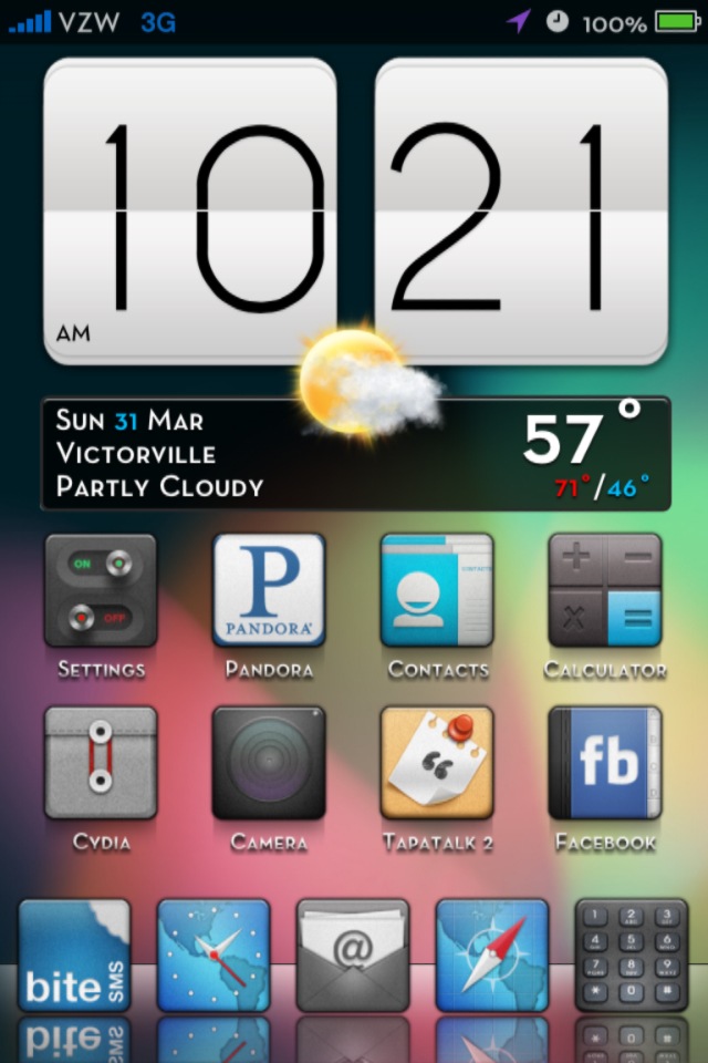

I had a feeling..... Forecast works and I have bought it, but it's just too dang ugly. Lol.

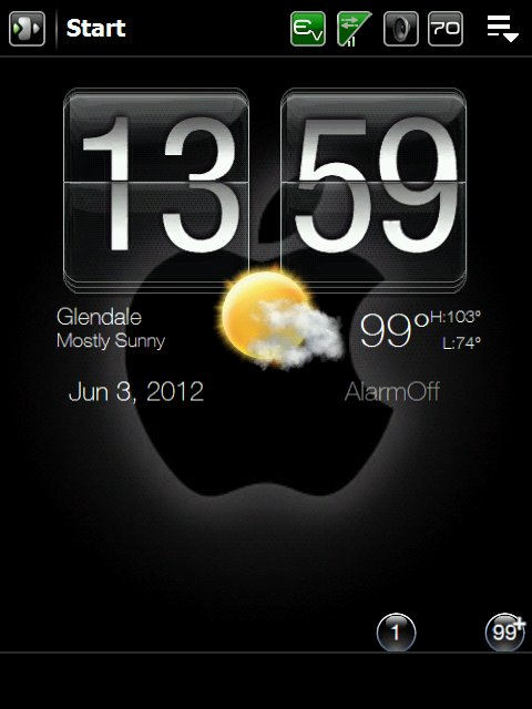

LOL! Admittedly, it's not an HTC Weather clock like on my Touch Pro, but I think it's better than the standard weather widget. 🙂
Once I removed the MyLocation app, the widget found my location. I think this is weird because I don't have MyLocation installed and I haven't entered a city code.
It may have it's own internal thing. I tried it yesterday. It picked up my location as Glendale, which is actually where I work, but 10 minutes from home where I was at the time.
