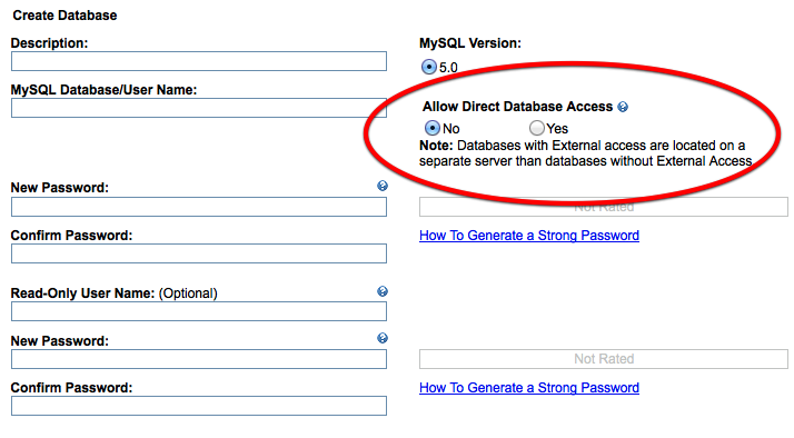

@aceiswild
Are you aware that to access GoDaddy databases remotely you need to enable direct database access?
Not all of their hosting accounts allow this. You can check if yours does by trying to create a new database. You should see an option to allow direct database access.

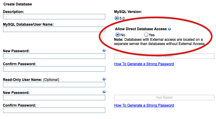

@aceiswild
Thanks for the help all. Very useful. Now i know what ports are open to which I will be doing next. Thank you Nuxx. You mentioning worked!! It was my fault for not allowing access. I must have skimmed through when i created my database and missed that option. And I don't think it says anywhere else if Accessing is enabled after you create your Database. But it works now! Time to get back to work.
Cheers!
