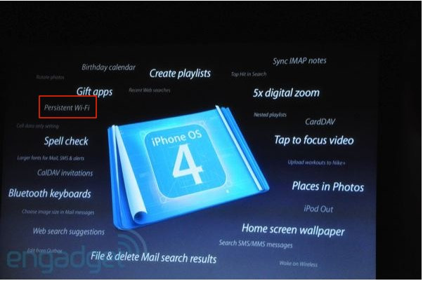

Do I recall correctly that OS4 has a feature to keep Wifi connected when sleeping? If so, upgrade to OS4 should help eliminate the mysterious use. For me, this would save 25% of the 200MB data limit per month.
It's supposed to be, yes. From Engadget (red box mine):
