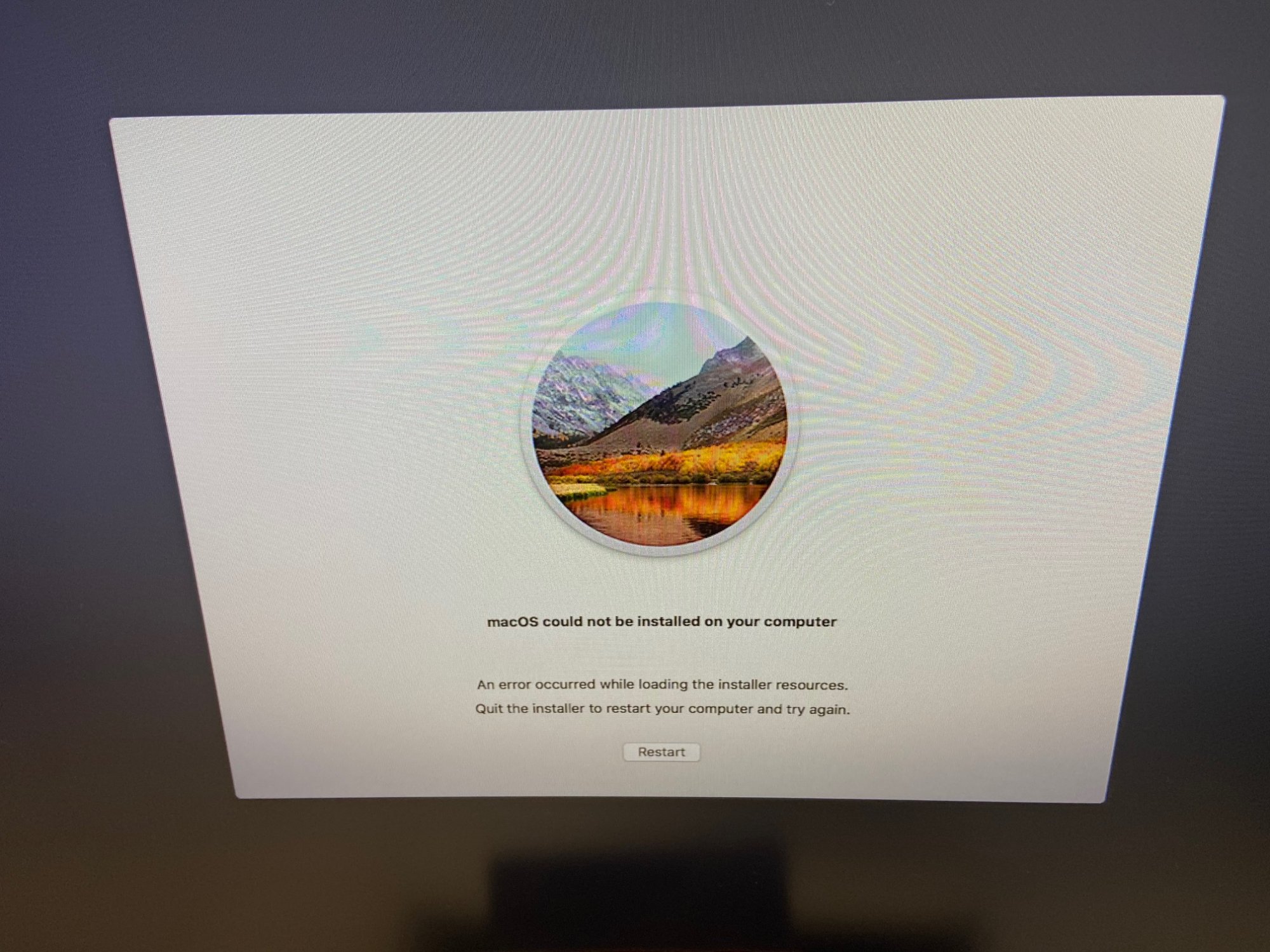

1. After I do the normal High Sierra installation from USB, and reboot to the OS, I get a message saying that "MacOS could not be installed on your computer - An error occurred while loading the installer resources...."

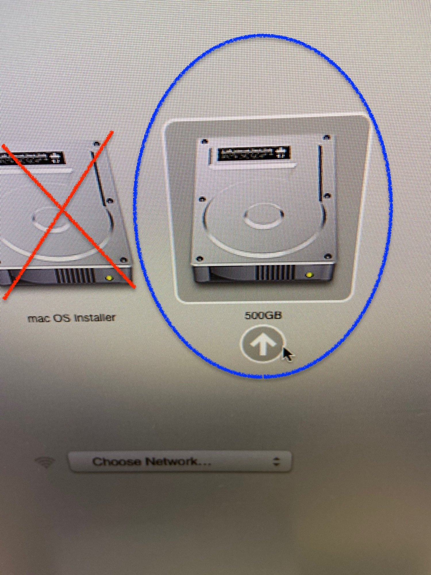

Then I restart, hold the ALT/Option key and then I see 2 startup disks: MacOS Installer & my 500GB SSD boot drive.
Booting into the SSD, it works perfectly fine and goes into desktop just fine. When I look in System Preferences for the Startup Drive, I can only see the SSD drive - I can't even choose to ignore / see the MacOS Installer boot disk I saw earlier....
How do I get rid of the "MacOS Installer" ?

These are the images:

maybe you got a bad installer image in the first place;
you still could try to install over the existing installation with a new USB Stick, you could also check out DosDude1 page to download a HighSierra image or make even the USB installer with the method he provides (although it is not needed in your case as the machine is natively booting into HighSierra.)

I have been able to now update the OS to 10.13.6 so that's good.
Unfortunately I keep seeing the Installer boot up message when I restart.....
Anyone ?

These are the images:View attachment 944636
Turn off wifi and unplug lan, then go to terminal and type "date 070900002018". You should be able to install the High Sierra normally without the macos installer part after and you should be able to update. Why don't you just use a 10.13.6 HS installer?

That is because your High Sierra usb installer date expired. I think.. try the date first and see how it goes..
