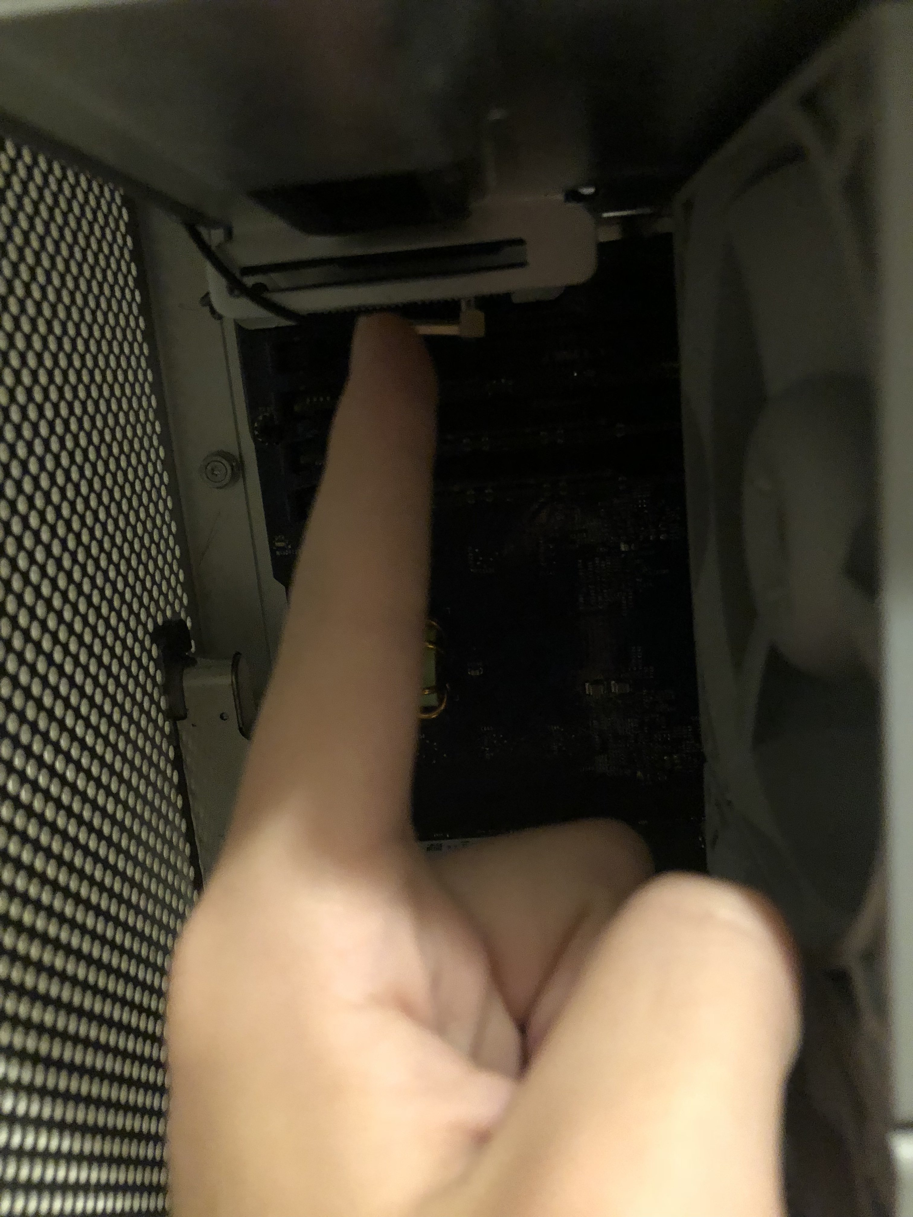

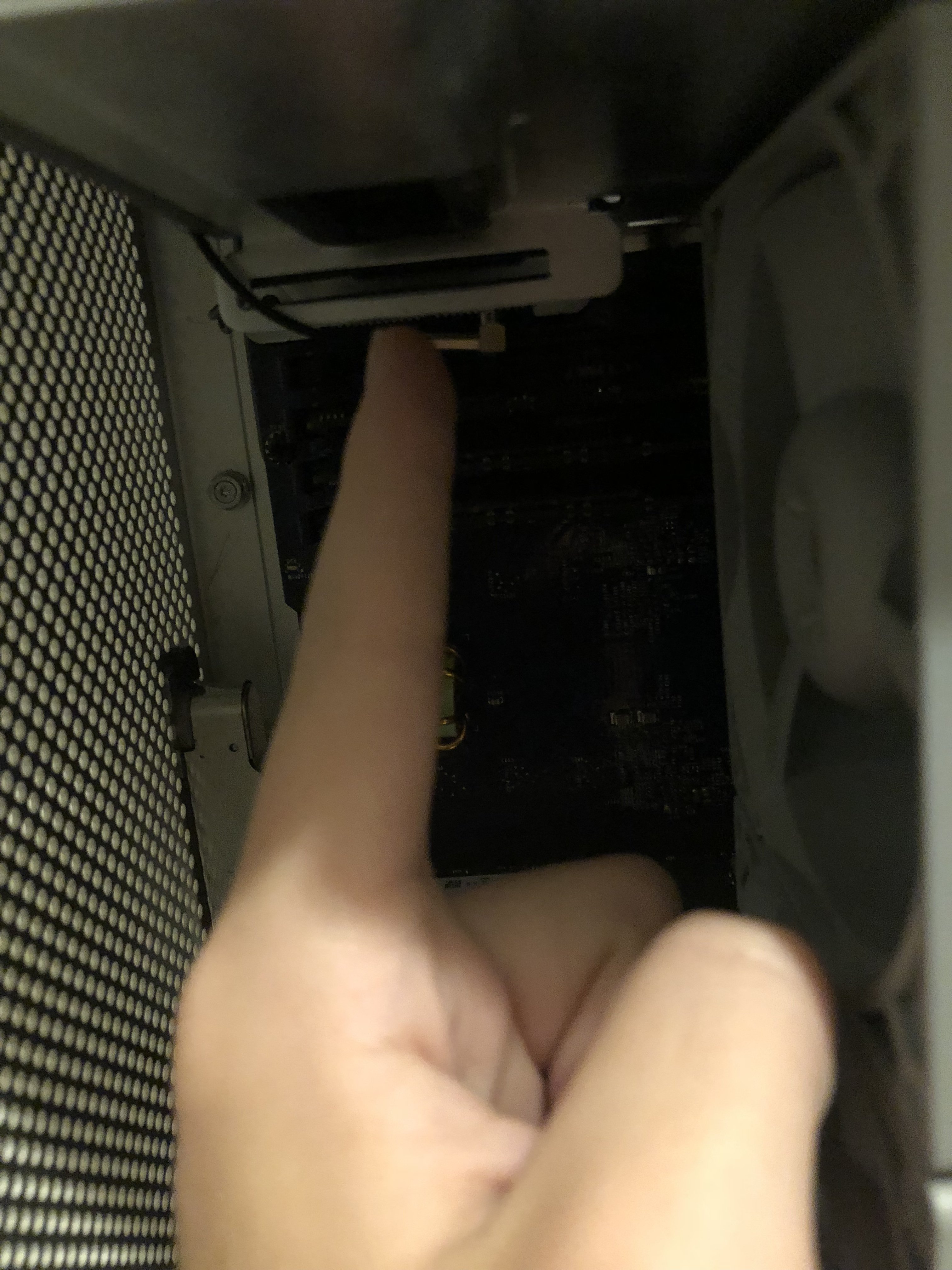

I discovered that something is missing from my powermac g5 and Idk what it is but I looks like it could be important and it is right above the ram slots and there are 2 cables not connected to anything but one of them is behind the speaker (the thing I’m pointing at has a port behind it)
View attachment 772661 I discovered that something is missing from my powermac g5 and Idk what it is but I looks like it could be important and it is right above the ram slots and there are 2 cables not connected to anything but one of them is behind the speaker (the thing I’m pointing at has a port behind it)
That's the AirPort card slot, those 2 cables are the antenna cables for the card. AirPort is Wifi in case you didn't know.
