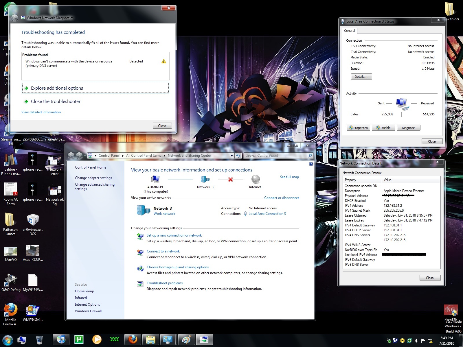

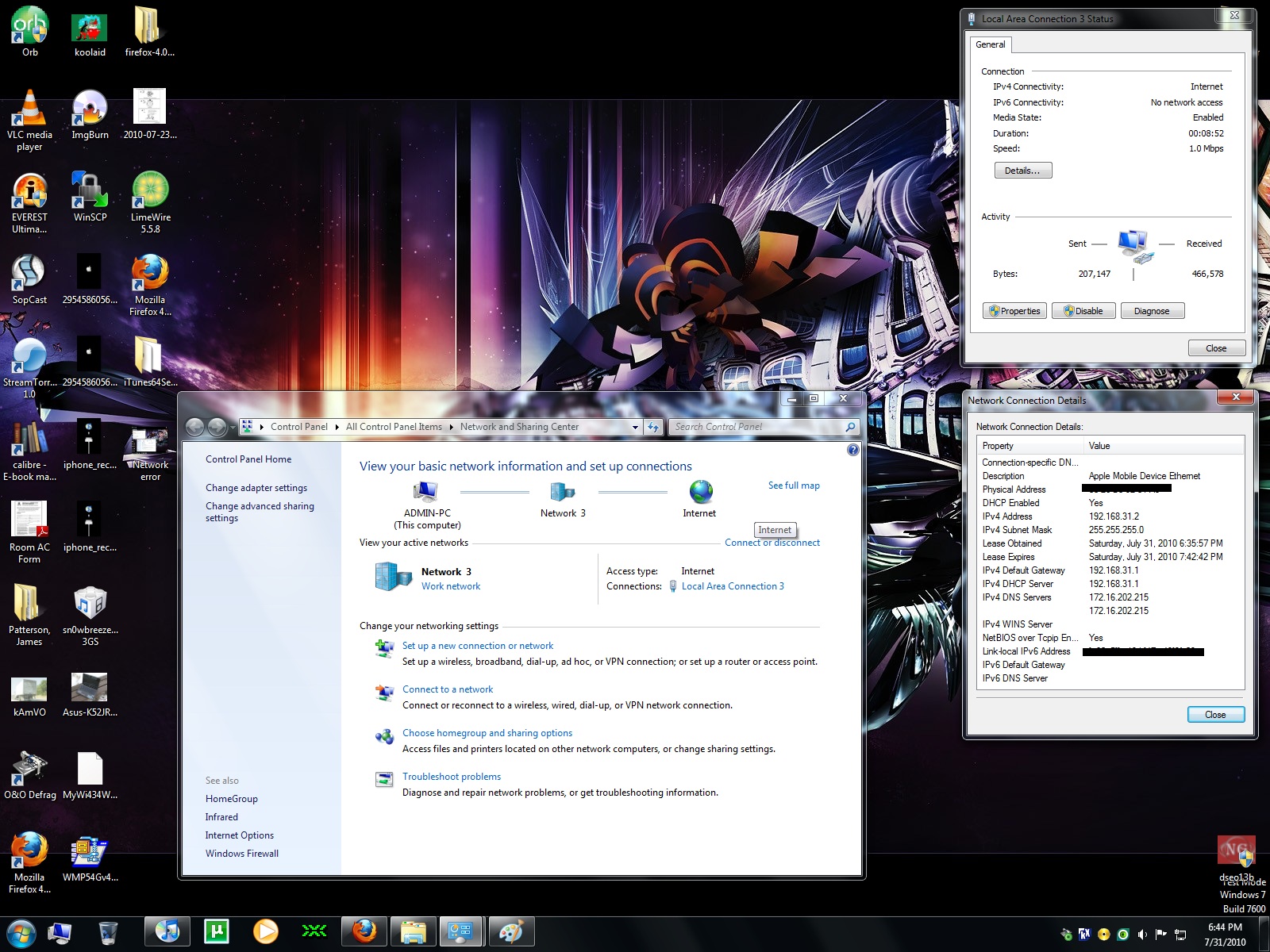

Here are some screen caps of the error with 3g (left) and with wifi (right) w/ error

It is a DNS problem.

In ddg5006's photo I can see the DNS is 172.x.x.x and I believe those are AT&T DNS server addresses. You need to change/add those DNS servers back to your home ISP's DNS servers. The fastest way you can find that out in windows is get on your computer that has the working connection to your home internet and open a command window and type in ipconfig/all The list that pops up will have a listing for one or two DNS servers, a primary and secondary, they may be listed as 1 and 2, I can't remember. Write those down.
