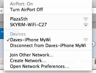

I also noticed that the iPad connects like it is a normal wifi network while the MacBook shows it as a device rather than a network and when it connects it goes from the wireless icon on the MacBook to the ad hoc connection. Is that normal?

Shows up as a device on my MacBook

This is how I got my 2012 MBpro to work.
On MBpro:
System prefs>Network>Wifi>Advanced>TCP/IP tab>Use DCHP
You cannot use any form of manual ip (DHCP only)
In Mywi:
Under WIFI HotSpot tab, Security must be set to "None".
For hours I have been trying all sorts of combinations and this has been the ONLY way I can get somewhat stable performance.
