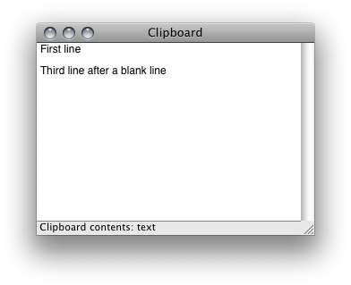

I am trying to set up an applescript that removes all the empty lines from my clipboard. I came up with this script
Code:
do shell script "pbpaste | sed 's/^\n//' | pbcopy"
I have tried the regex s/^\n// with a perl one-liner and it works fine.
However, every time I try to compile the applescript in the AppleScript Editor I get
Code:
//' | pbcopy"
The \n is removed and replaced with a blank line, and the script will not work.
How do I get this to work? 😕
Thanks
The script seems to do nothing when I do \\n.
(To try, copy something with a blank line, add the script to AppleScript Editor and run it, and then paste your clipboard and see if the blank line is gone)

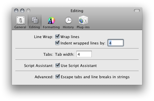

Go to preferences-->Editing and check Escape tabs and line breaks in strings
Thanks that did the trick!

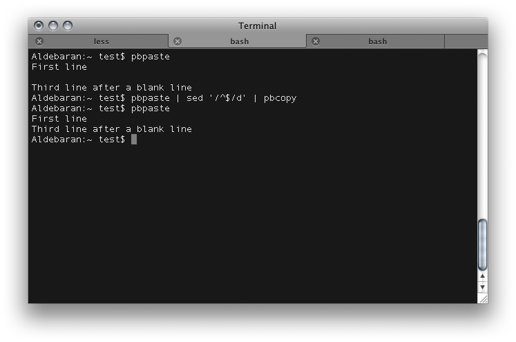

Although, for some reason my clipboard is empty after running the script, makes no sense. Oh well another night at google
Try this :
Code:
pbpaste | sed '/^$/d' | pbcopy
