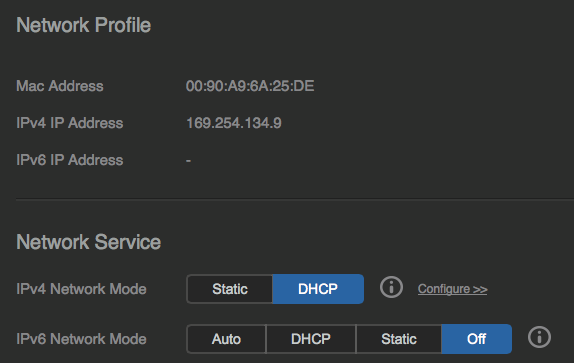

For the first few weeks my shiny new NAS worked great, but I've noticed it's getting worse and worse at connecting and staying connected. Unless it's actively being accessed it seems like it'll dismount within around 15-30 min - which is really frustrating when you walk away for a coffee or something and come back to find final cut has completely lost it's mind and disconnected all your media and render files!
As it stands I have:
WD MyCloud EX4 -> Netgear ProSafe 5 port gigabit switch -> nMP
Connected using afp. The only other device plugged into the switch is my old MP tower, which I power up occasionally to access old files. The nMP connects to the internet via airport.
Screenshot is of the NAS control panel. Am I setting it up wrong? Is there a more reliable way of doing this? Or is my nMP having ethernet issues?

So the main router is an AirPort? I would configure the NAS to use a static address as the address you show in the screen shot (169.xxx.xxx.xxx) is an out of range. It is not getting an address from the AirPort, the router.

That 169... address is a Automatic Private IP Addressing address devices assign themselves when nothing else either static or DHCP has assigned an address. The problem is nothing on the network knows where that is. Pretty good explanation of it here.
... and yes there may be a conflict if you pick a static IP in the range of the routers DHCP addresses. Look in your router settings and see what range of DHCP addresses it uses and pick an IP just above that range. For example on my Time Capsule router it uses the DHCP range 10.0.1.2 to 10.0.1.100 so you could use 10.0.1.101 for the NAS and not have a conflict.

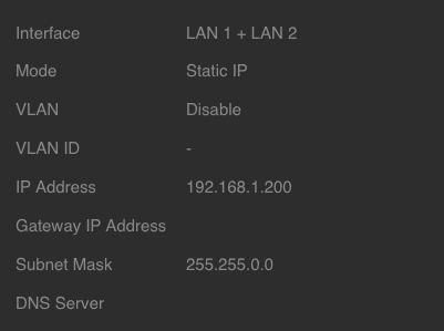

New NAS settings:
Update:
Now I can't connect at all. NAS settings as above.
Do I need to change the settings on my network preferences?
Try going to Finder --> Go --> Connect To Server --> typing (afp://192.168.1.200) minus the parenthesis...
EDIT: Did this ever work with the nMP using AFP or only on the old one?
Tried that, just timed out or replied with an error that the server could not be reached. Typing the IP into safari also failed to connect to the admin dashboard. Performed a hard reset back to factory network settings...

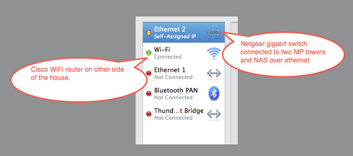

What have you got for an IP address on that ethernet connection there on the MP? It will not have a DHCP supplied address either since it is not connected to a router. You would need to assign a static address here too outside the DHCP range.
Right now the IP on Ethernet 2 is 169.254.5.163 and the NAS is 169.254.134.9 (the WD EX4's default).
Right now they're directly connected which seems to have improved reliability a bit. It still disconnects if the computer sleeps and fails to automatically reconnect upon wake.
