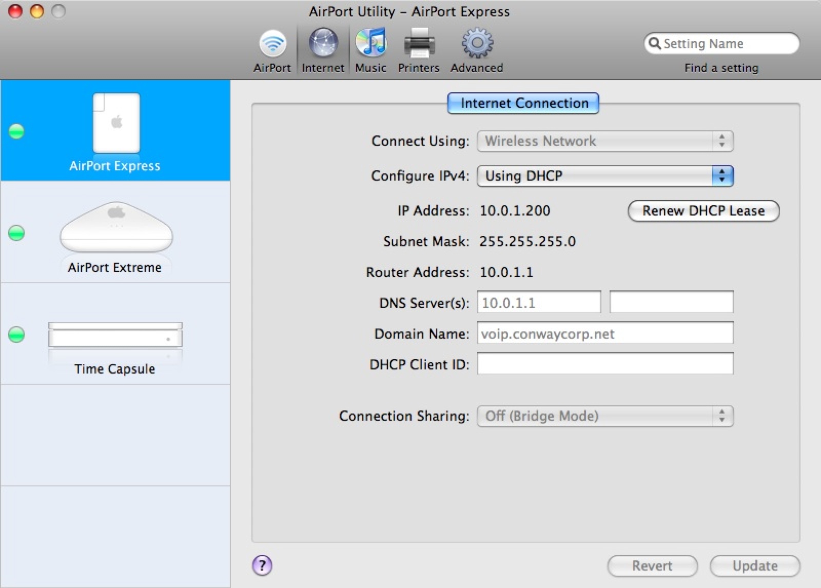

Here you go:
Change "Connection Sharing" to "Off (Bridge Mode)" in the Internet settings pane.
jaw04005--I actually tried that before starting the thread, but it didn't work. When I set AirPort to bridge mode, the MacBook cannot connect to the internet (no IP address!) OR the NAS drive.

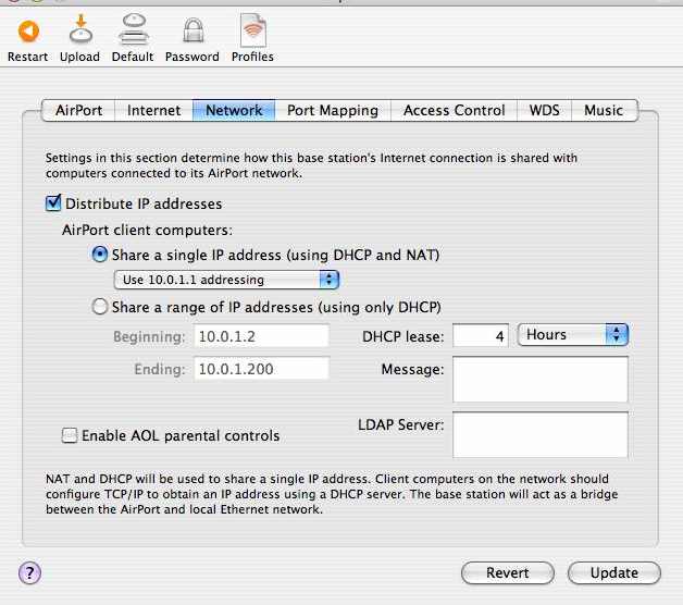

By the way, my window looks different from yours. I do not have a "Renew DHCP lease" button in AirPort Utility (it appears only in Network Preferences).
Here is how mine looks like:
If you unclick that button on the top that says "Distribute IP addresses", then your WiFi and ethernet networks will look as one.
