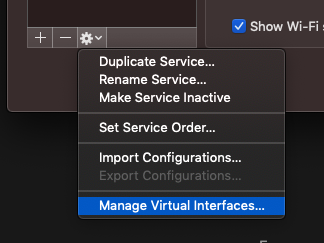

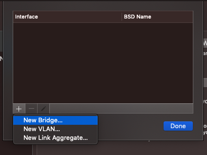

The process is still the same. Open Network Preferences and select Manage Virtual Interfaces from the additional setting dropdown.
Then, add a new bridge and add your Ethernet and Thunderbolt Bridge to it.
Once you do that, both interfaces are going to disappear from the connections list and be replaced by the bridge. All the IP and other network setting for the host Mac are applied to the bridge. If you use DHCP, it should pick that up within a few moments of clicking Apply. If you manually configured any setting, you will need to apply those fresh to the bridge.
Remember, internet sharing needs to be off or you'll end up with a double NAT and a headache.
Plug in your Thunderbolt cable. The other mac should see the connection and should see DHCP from your router and connect/configure just like any directly attached device.
If you delete the bridge later, it is important to note that the individual network connections will not come back by themselves. You'll have to click the plus '+' button and add Ethernet and Thunderbolt each back on the host Mac.
