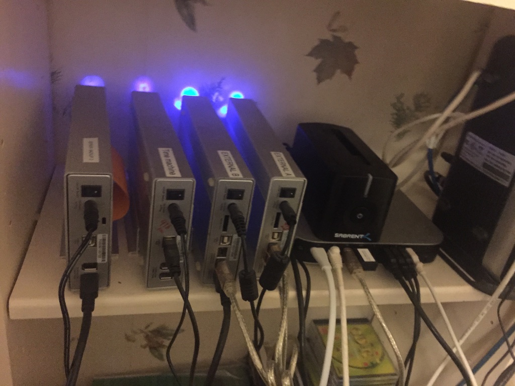

I'm sold on a Mac mini server and use Plex. Over five years now and just recently switched to a new (2012 quad core) mini. Of course I'm doing a lot more than just a media server with it. 13TB of disk capacity plus a toaster. http://almy.us/server.html
