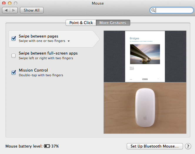

Talk about refusing to play nicely with other products. Once I installed Lion, my Logitech scroll wheel started behaving in reverse and there is no way to put it back.
Here's my Mouse settings after installing Lion:
Nothing to disable natural scrolling.
Your screenshot is in "More Gestures" pane. Switch it to point and click...its the first option.
