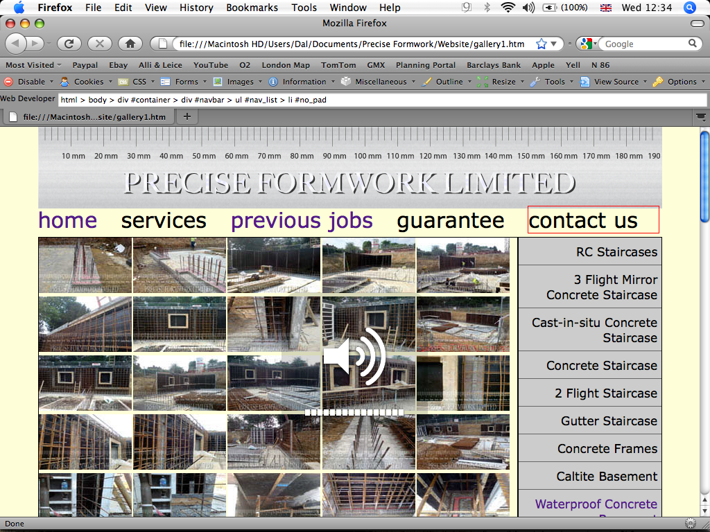

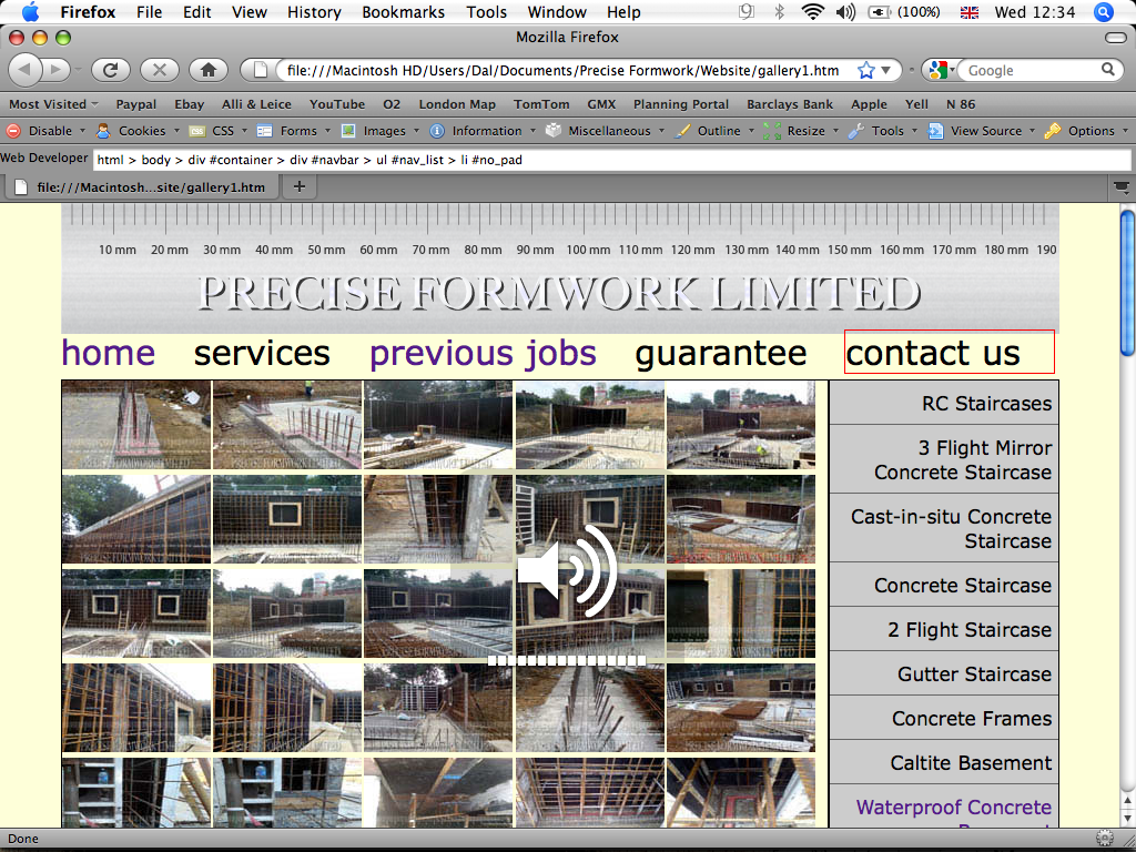

I'm trying to format 'contact us' as a different class/id so there is no padding on the right, I have tried reducing it's width in css no luck, tried floating right, no joy. I would like it to be flush on the right.
Just realised also that here I am sizing it all in pixels, but if the user has not the same font as I'm using, their substitute will not align correctly and look crap. EM's wouldn't solve this problem I don't think as that's just another scaled measurement.😱
CSS:
HTML:
#no_pad li {
padding-right:0px;
text-align:right;
width:150px;
#navbar {
padding:15px 0px 8px 0px;
#navbar ul{
list-style:none;
margin:0px;
padding:0px;
padding:0px:
float:left;
#navbar li{
font-family: "Lucidia Grande", Lucida Sans Unicode, Verdana, sans-serif;
font-size: 1.8em;
display:inline;
width:225px;
padding:0px 30px 0px 0px;
margin:0px;
line-height:0px;
HTML:
<div id="navbar">
<ul id="nav_list">
<li><a href="index.htm">home</a></li>
<li>services</li>
<li><a href="gallery.htm">previous jobs</a></li>
<li>guarantee</li>
<li id="no_pad">contact us</li>
</ul>
</div>
