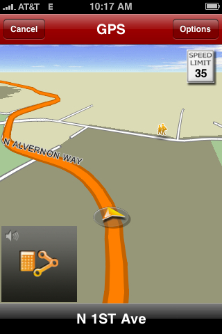

I have Navigon 1.2 but about 90% of the time throws this red bar at the top. My Maps applicaiton has no problem getting a GPS lock.
Is there a bug with this? I have iPhone version 3.1.

in a case? where is it mounted?
Some people have this problem, I would say it's more your phone than the app.
Keep in mind, the maps app will use triangulation and wifi to obtain your location as well as the GPS chip. I do not believe that the NAVIGON app will accept these methods for location and will go to the red bar.

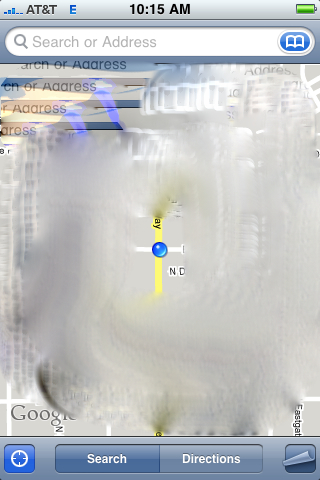

You can see that my maps app gets a GPS lock, but the Navigon is almost always throwing a red bar.
Actually, it doesn't look like your Maps app has a GPS lock. A GPS lock will show a pulsating blue dot with a ring extending from it every couple of seconds. If you just have a blue dot, that means your Maps app used cellular triangulation to get your location (WiFi will show a static ring radius around the blue dot).
