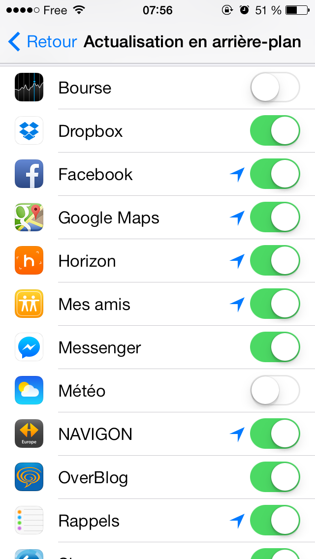

This is an old thread, but I had the same question as the OP. Has anyone figured out how to turn off the screen and still get driving instructions from Navigon. If I exit the app, the instructions stop and I couldn't find an option in settings for this. Thanks?
Found this thread via Google and I am having the exact same problem....Navigon turns itself off (power saving mode appearently) when my iphone screen goes off and stops all navigation....Very annoying and no way to disable it in the app settings 😡
I also found this thread via google a few days ago without finding the answer on the web, but I figured it out today. You have to go to
Settings > General > Background App refresh and enable it.
