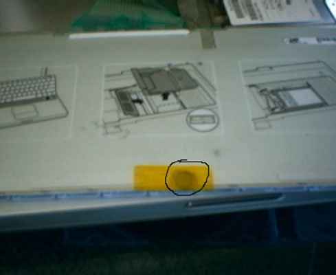

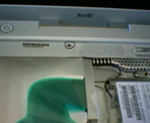

Well I don't know what ibook you have but my G3 800mhz has had sleeping problems when closing the lid for a long time on and off, and i finally realized that it was a little metal circle underneath the keyboard. when wasn't completly in the circle and wouldn't make contact the other metal circle tapped to the bottom of the actual keyboard it wouldn't sleep. This may be something completly different just though i'd thow that out there. here are some pictures in case that didn't make sense. but if take it out you'll see it won't sleep when you close it.
