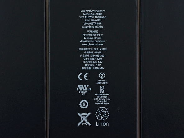

The ipad 3 and 4's battery is actually 11666 mah.
