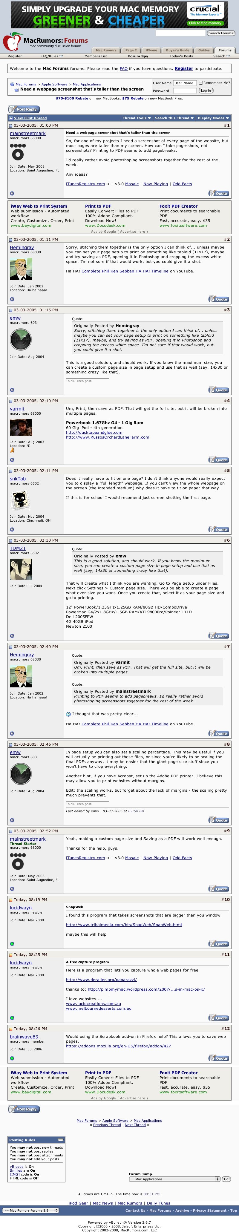

Super Screenshot seems to do the job, without you having to download a program.
It was pretty slow for me, though. Also, I guess your sites would have to be visible on the internet at large...
that's pretty handy too. I only downloaded the program cause the website was running on my local hard drive.
