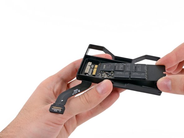

The ribbon cable is part of the SSD tray:
You can easily remove the SSD from that tray, then all you need is the (pricey...) enclosure, like the one listed from OWC. It's needed because Apple decided to use an SSD with an Apple-specific connector.
Yeah i meant the tray. Since the enclosure is expensive, i wondered if i could find a way to plug this weird output to USB using a convertor somehow..
