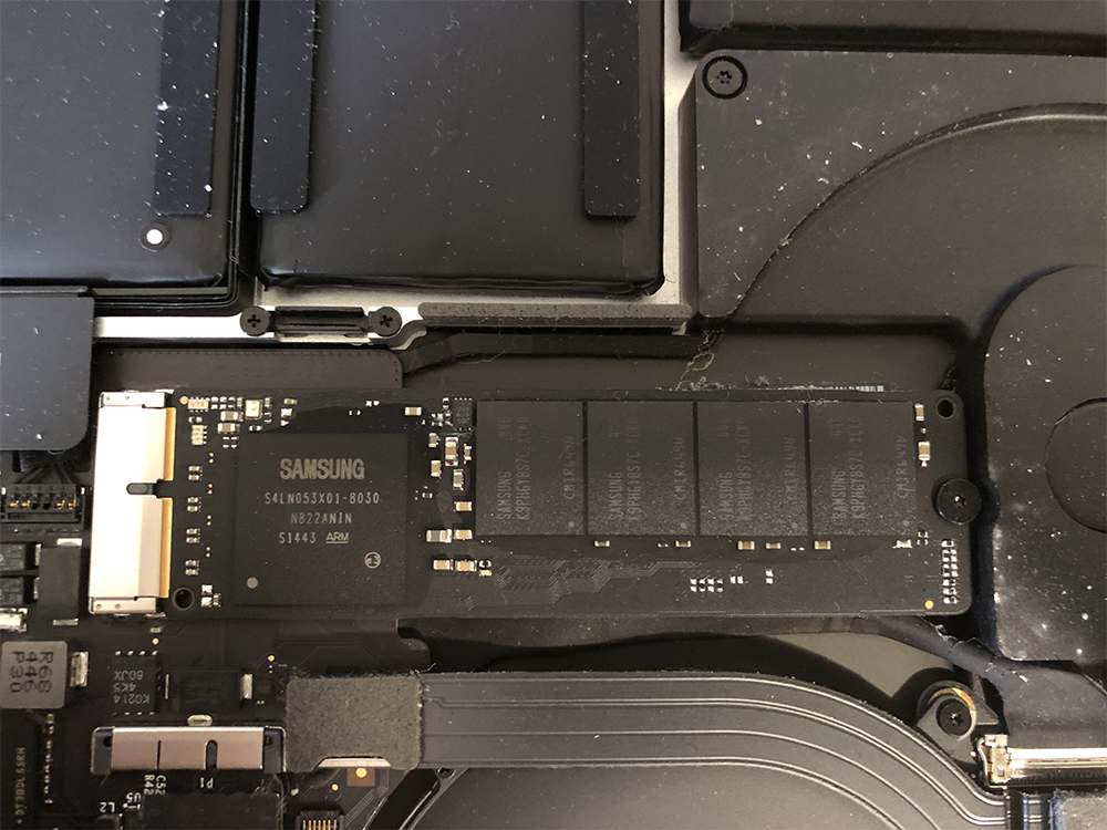

I figure I will just open up my MacBook Pro, remove the SATA Hard Drive, and retrieve my files that way. Thing is, once I got my MacBook Pro opened, I am looking at an M.2 instead of a removable SATA SSD Hard Drive. Which, in and of itself, still does not pose a problem, I will just remove the M.2, buy an adapter, and plug the M.2 into my older MacBook Pro, and retrieve my files that way. But again, after further research, I learn that Apple does not adhere to the normal/standard M.2 specifications, and, just any old adapter that I would buy, most likely will not work with my Apple M.2.

I am attaching a picture of my M.2 in the event that someone may know the exact, "M.2 to USB3" adapter/device to use. Yes, USB3, as neither of my units have USB-C.

As you have found, there is a blade drive inside.
However, it IS NOT a standard m2 or nvme blade.
Rather, it's an Apple-proprietary design.
There are only a few 3rd-party enclosures into which it can fit.
I believe Other World Computing sells one, but it will cost you 75-100.
