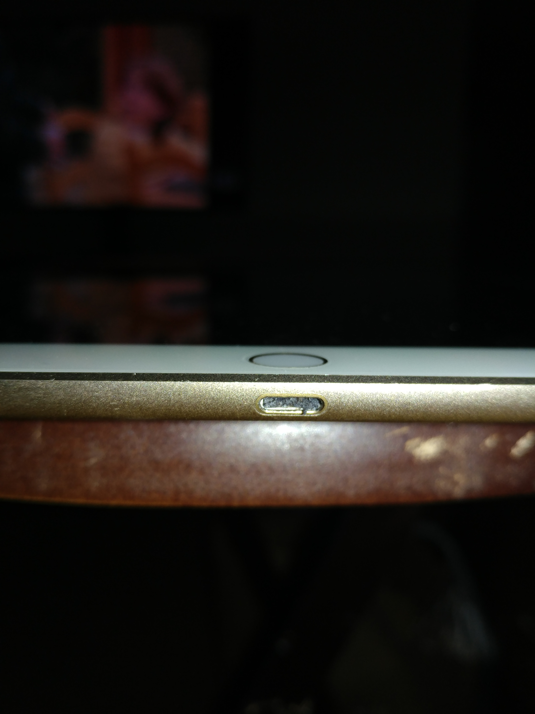

Make sure your device is completely powered down before sticking anything into the port for extraction. Could you post a pic of it? I've had charging cables snap off while still inside but I've never seen one break off flush. Good luck!
Reactions: Cameroncafe10a
Just because I haven't seen it mentioned yet;
Oh, I do. I never have it on when I'm messing around with it. Here's the pic. Hard to get a good one.

Trying glue on end of nail file. Letting it set now. Will try to remove it in an hour. Doubt it'll work, but we'll see.
Tried it all. Nothing worked. Heated up a needle. Didn't work. Gorilla glue on nail file, didn't work. Wedging two needles on each side, didn't work.
Part of the problem is the front side of the plastic is getting beat up so less to grip to.
You should definitely be able to get it out with the things mentioned above.
You will get it out eventually just keep trying a be as careful as you can.

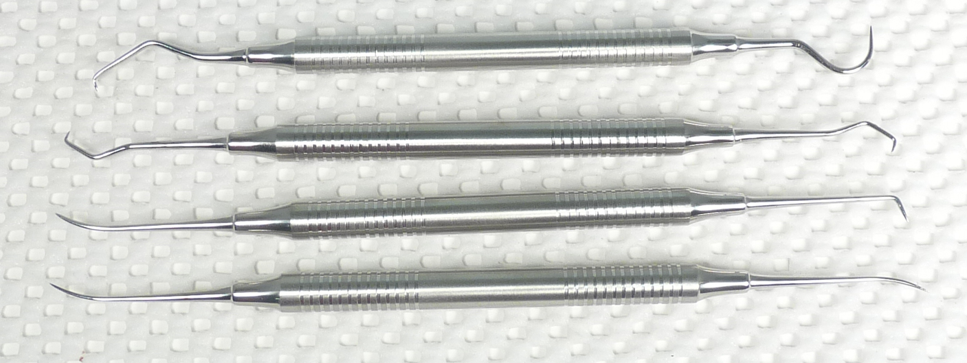

You mentioned that you tried all the listed suggestions, but that was posted right after the idea for the dental pick from walmart, so I'm not sure if your post included that one. If you haven't already, I'd give that one a try if it were my iPad. They are pretty cheap, really sharp & they give you some grip. I would be surprised if one of those wouldn't be able to dig into the plastic & then give you enough leverage to pull out the broken part.
