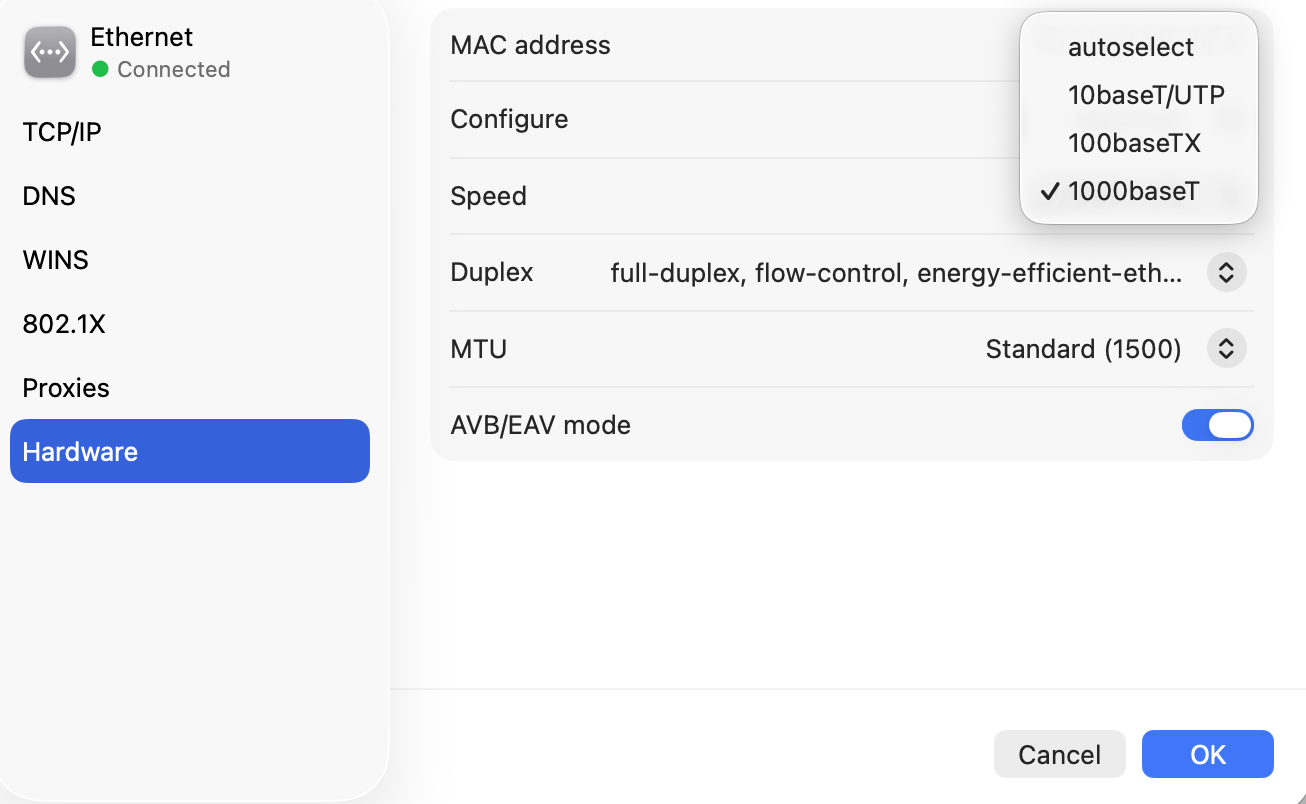

I propose a test:
Open System Settings -> Network.
Select ethernet and click "details".
Click "hardware" and in the resulting pane, choose to configure manually.
Now, set the ethernet port speed down to 1gb.
Click OK.
Probably might be a good idea to shut down (power all the way off) and then reboot.
After rebooting, do you have a connection?
Again, you may have tried this already, but if you haven't, might be worth trying.
If my "solution" does work, it might be worth asking AT&T if they have a more recent router that better supports 10gb (but you've probably already done this, too...!)...
