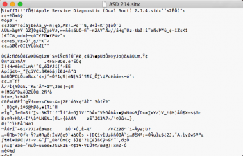

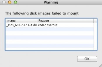

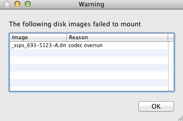

Not having any luck at all, redownloaded the file that LightBulbFun supplied also a new copy of Stuffit expander and now I'm left with this message when attempting to expand the file.
Good thing there is no rush on the need for this ASD file.

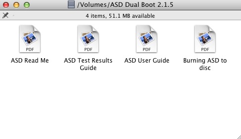

Again another link that leaves me lost, four pdf files telling me I need to burn a CD which I knew, but no image for a burn source.
When you mount the .dmg you wont be able to see the system files as they're hidden - just the pdfs. If you burn the .dmg, the disk will be fine.
If you want to enable seeing hidden files in Finder, in Terminal type:
defaults write com.apple.finder AppleShowAllFiles TRUE
killall Finder
To change back to normal:
defaults write com.apple.finder AppleShowAllFiles FALSE
killall Finder

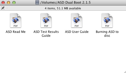

This should be the correct link:
http://www.dreamsupport.us/downloads/apple-mac/Apple_Service_Diagnostic_Disks_25_GB/ASD Dual Boot 2.1.5 (2003)/
You should get a file (after you unzip the download), _ssps_693-5180-A.dmg
Follow the instructions "Burning ASD to disc". I just tried it with Disk Utility, and made a CD with ease. I don't actually have a MDD G4 to test it on now, but the burn completed without any errors. I would expect it to work for you, also.
I do realize that it can be confusing. The .dmg, once it is burned to the CD, will give you two different bootable diagnostics partitions on the same CD. One boots to firmware, and is the main hardware test. The other is an OS boot (looks like a MacOS boot, to some degree), which then gives you other hardware tests. Some of those test how the hardware communicates with software.
OK fellas, I've got this figured out now and have a boot-able service disk, thanks for bearing with me on this while I stumbled through the process.
