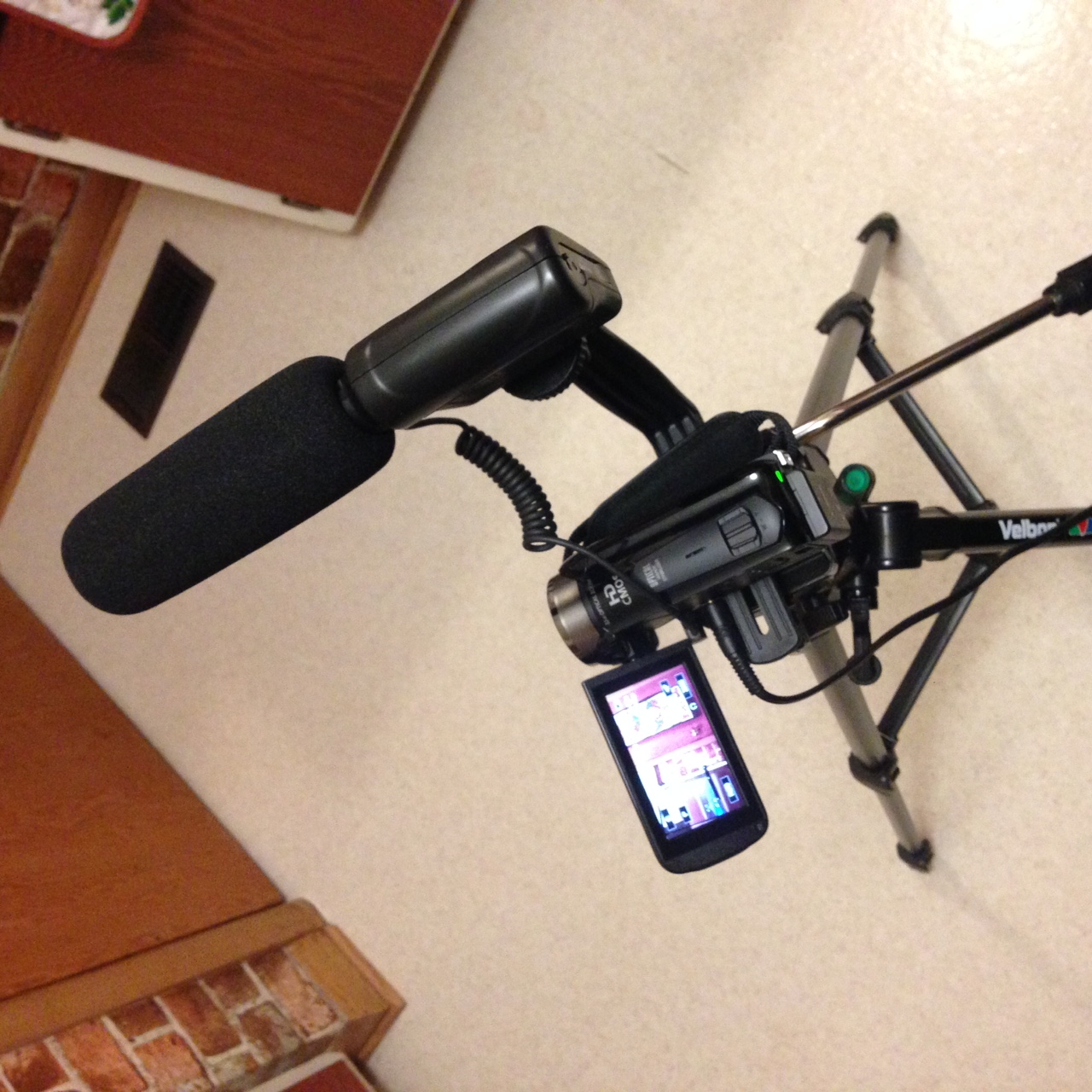

I bought a Canon Vixia HF-R50 after Christmas and it meets your requirements. So far I'm very happy with it. You can usually find it in a $299 package deal with a case, SD card, and spare battery. I'm using mine with an external bracket-mountd shotgun mic; low-priced camcorders tend to skimp on audio in favour of video quality. So far after a bunch of test recordings and one live band I'm very pleased with the results. It seems to have the same brains as Canon's "prosumer" G20/30 camcorders including selectable AVCHD / MP4 compression. Recommended.
