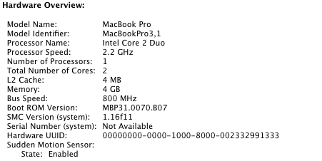

Hello there,

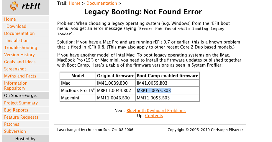

I've been searching and searching without success for an active link to download the Firmware for MacBook Pro's 15" 2008 - MBP11.0055.B03 but all the ones I find are dead.
This is to enable Legacy Book on rEFIt and install Ubuntu/windows 7 on boot camp. Link: http://refit.sourceforge.net/doc/c4s1_notfound.html
Can any one help ?
Thanks in advanced.

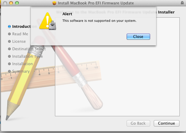

Thank you for your quick response.
I get the fallowing error:
"This software is not supported on your system"

Found this on the apple boards, but the links are dead.
LexSchellings Dec 11, 2013 2:48 AM
in response to Victor4
Another PS:
There was a firmware update for MacbookPro 1.1, called EFI Firmware update 1.2: MBP11.0055.B08 (MacBook Pro 15 inch)
If it is for your computer, it should normally show and install via "Software Update".
Read here about the firmware update itself:
http://support.apple.com/downloads/MacBook_Pro_EFI_Firmware_Update_1_2
Read here for installing:
When you do not have any of the issues it addresses, you miss nothing by not installing.
Never "force" a Firmware update on a computer that does not install it by regular procedure.
- https://discussions.apple.com/thread/5654338?tstart=0
Your model Macbook never had an EFI update. It came from Apple with the ability to boot into Windows via Boot Camp.

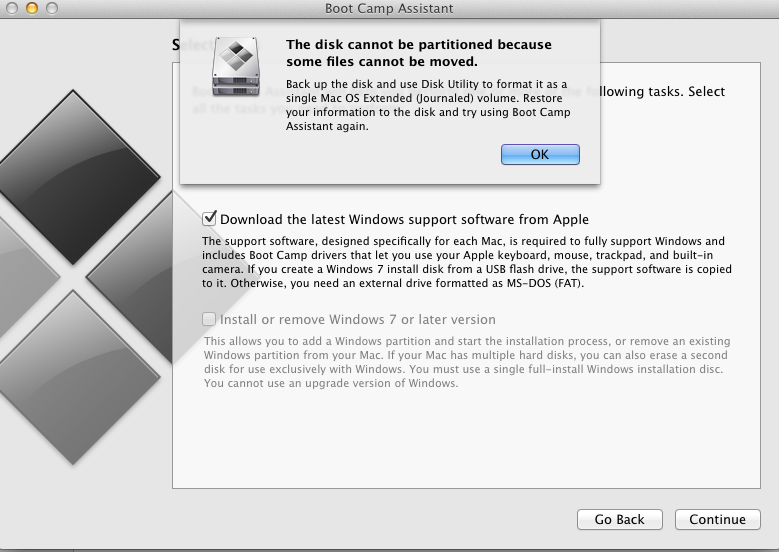

I have fallowed this instructions to create a new bootable USB. but I'm trying to run Bootcam again and get an error. "This disk can't be partitioned because some files can't be moved." (Image)
I have tried to repartition the drive using the Disk Tool from the recovery partition and no luck! (Very frustrated) I don't want to reformat everything!
