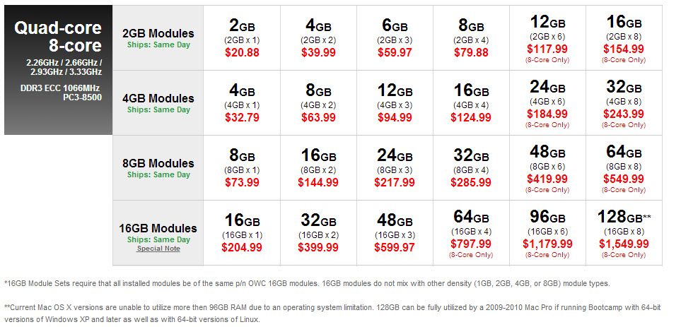

Hopefully this helps. 1333MHz memory will NOT work. You will require -> DDR3 ECC 1066MHz PC3-8500 instead!! and remember they must be MATCHED to each other (same manufacturer, etc)

This is actually incorrect. The RAM that will work is DDR3 ECC 1066MHz PC3-8500.
If its worked for you, it could also be possible based on the VOLTAGE of the RAM. But the above mentioned 1066MHz are confirmed to work.
1333MHz RAM will work just fine @ 1066MHz in your MP.

No Problem. BTW, if you do need to find out where I got this info -> http://eshop.macsales.com/shop/memory/Mac-Pro-Memory#1066-memory
If you had the MacPRO 5,1 then you can use 1333Mhz RAM but seeing that you had a 4,1 1066Mhz is your only option.
