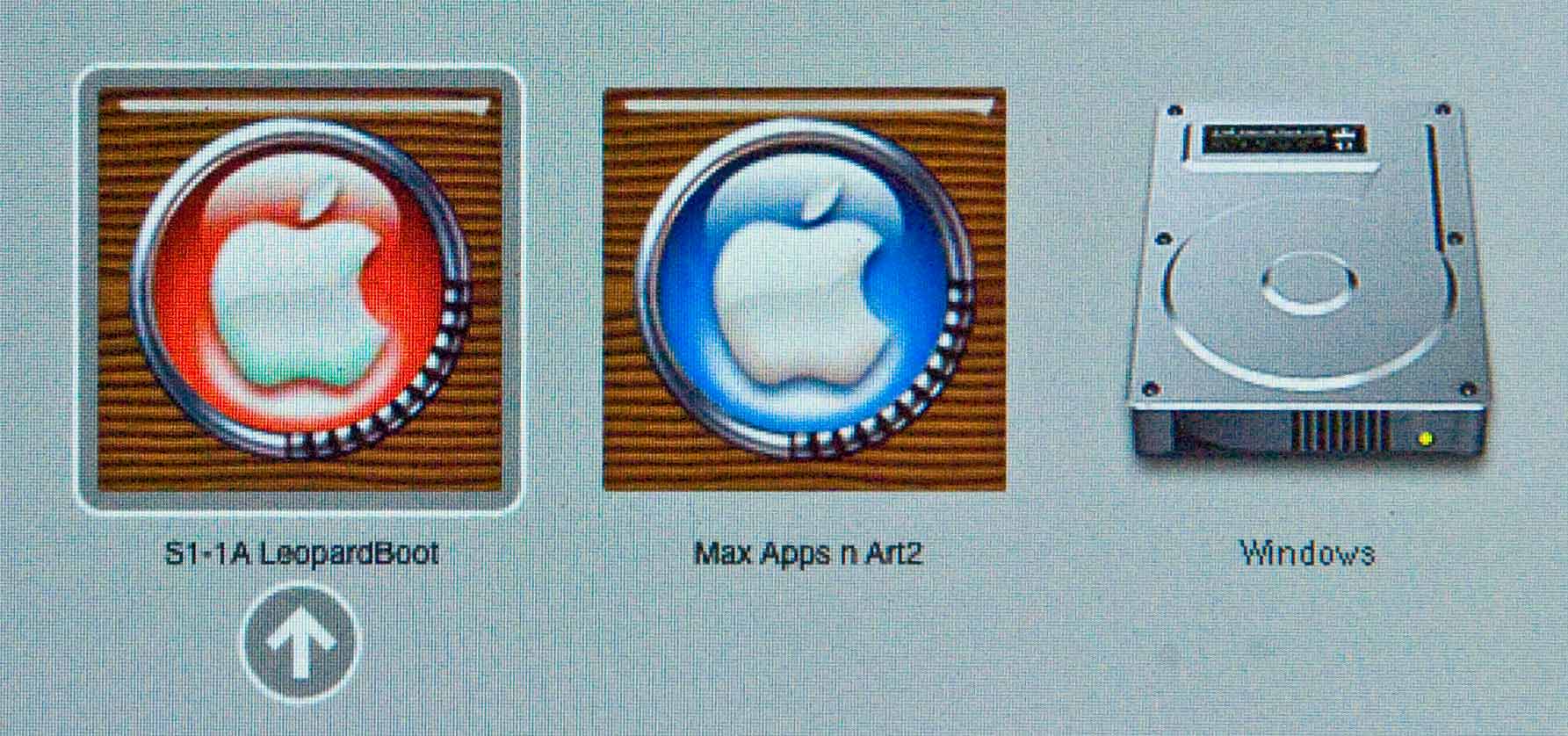

Also in the Option version of startup, any custom icons you have applied to the drives show up as well as the changed names, such as this on my desktop (had to shoot a picture, as screenshots don't work that early in the startup sequence BTW!)--

Oddly enough, the external volume shows on the desktop and in Finder as "clone_imac," which is what I named the partition. It also displays the orange firewire drive logo.
I've seen a lot of photos similar to the screenshot you've posted, but mine looks quite different on both my machines (G5 iMac and G4 PowerBook).
I see a rectangular button on the left with a "refresh" icon, and a rectangular button on the right with a "right arrow" icon. In between these are the two identical "Macintosh HD" icons. On top of these hard drive graphics is an old-style OS "X" (the thin, blue "X" with serifs). The selected drive is slightly darker, but there is no arrow underneath them indicating which one is selected. Here is an example I found on the web (this one just showing a single drive)...
Any ideas why this is different? My guess is it's just because I'm using older machines.
