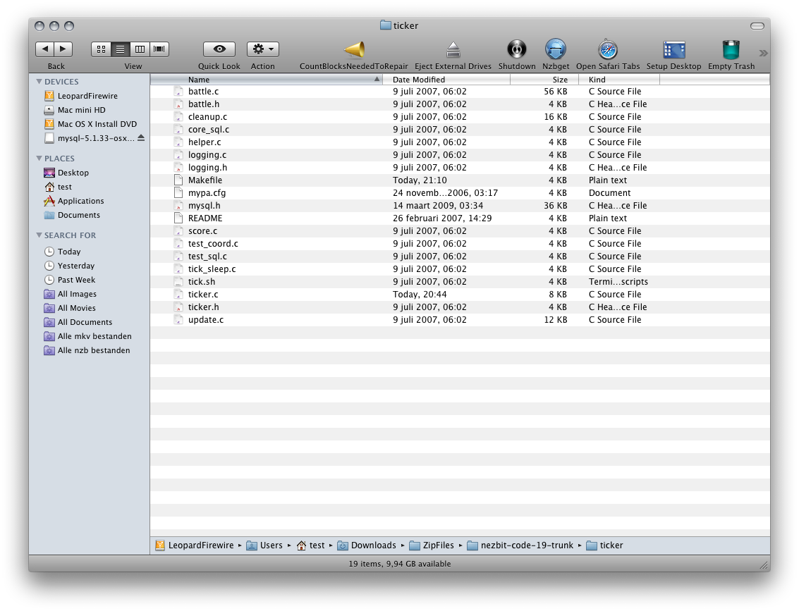

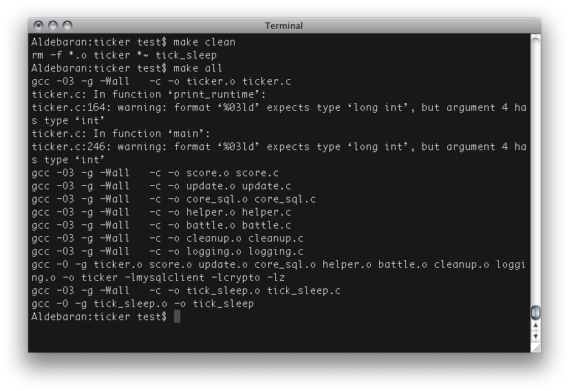

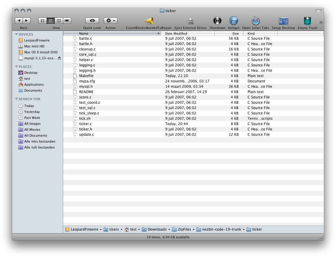

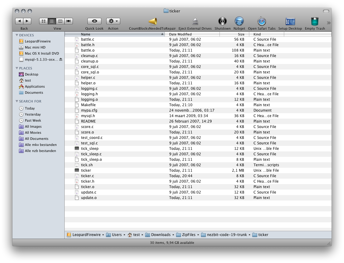

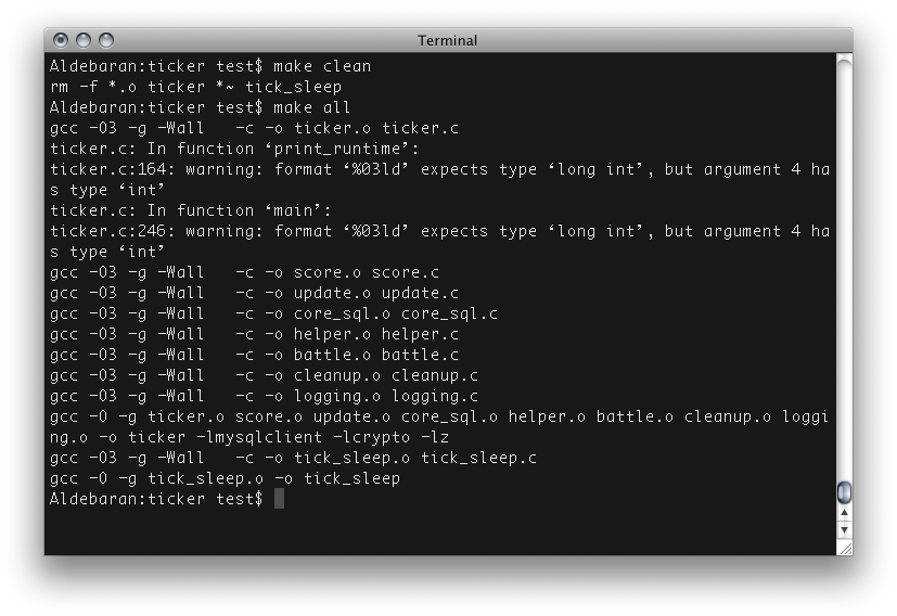

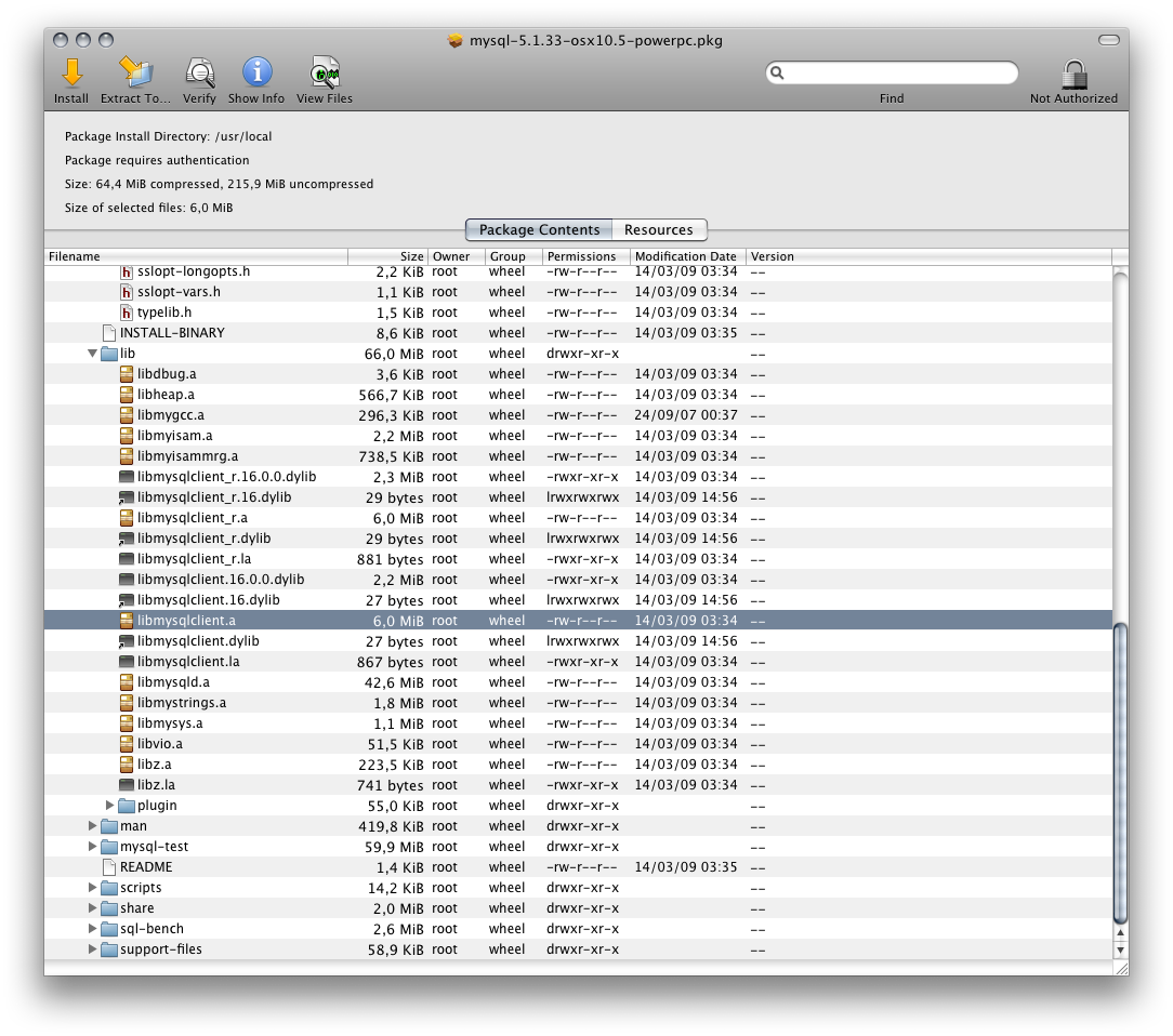

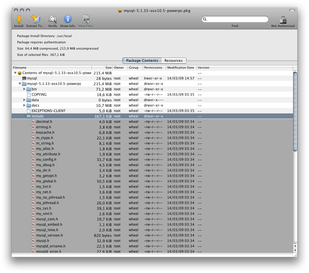

I compiled it on Leopard 10.5.8 PPC. These are the steps I did :
  1. Downloaded mysql-5.1.33-osx10.5-powerpc.dmg from http://dev.mysql.com/downloads/mysql/for my architecture. Yours will probably be different!
  2. Downloaded nezbit-code-19-trunk.zip from the link you posted.
  3. Opened mysql-5.1.33-osx10.5-powerpc.pkg from mysql-5.1.33-osx10.5-powerpc.dmg with Pacifist.
  4. Created directory mysql in /usr/include eg /usr/include/mysql
  5. Copied all header files from the include folder in mysql-5.1.33-osx10.5-powerpc.pkg to /usr/include/mysql
  6. Copied the libmysqlclient.a file from the lib folder in mysql-5.1.33-osx10.5-powerpc.pkg to /usr/lib
  7. Changed the -lcrypt in the LIB = -lmysqlclient -lcrypt -lz line in the Makefile to -lcrypto
  8. Cd to the folder where you unzipped the nezbit-code-19-trunk.zip file.
  9. make all
