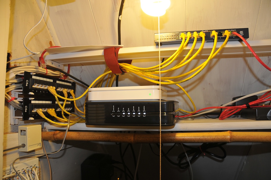

I'm setting up a gigabit network for my home, but I'm running into some difficulty. My iMac still reads that I'm still running 100 Mbit/s. It's not obtaining GigE speeds based on my current setup. All my equipment are GigE capable and are using 5e cables:
Based on the GigE Switch, the LED from the router to the switch is obtaining GigE speeds. However, from the switch to the 5e patch panel to the outlet to the iMac, the LED reads that I'm getting 100 Mbit/s.
What may be causing this? Is it the 5e Patch Panel from Leviton that came with my home that's holding it back? Its a Category 5e patch panel so it should be compatible to GigE speeds. I'm lost. Any help is appreciated. Thanks!
-Justin

1. I've tried that. It didn't work.
2. The Cat5e cable are handmade and have been checked with a cable tester that it was all working correctly. However, the cable is a bit finicky. It would disconnect suddenly when its jostled around—like any other cable though.
3. I'm afraid it might be the panel. Upon further investigation, I'm able to achieve GigE speeds when I hook up my Macbook Pro directly to the GigE Switch avoiding the panel all together.
Like I mentioned before, the panel is set up as a Cat5e panel so it should be compatible with GigE speeds. Maybe it's an issue on how its setup. (See images below to see punchdown terminals layout looks like:
My iMac is hooked up to a Cat5e outlet from my room which is connected to the command center with the Leviton 5e patch panel. The panel is then connected to the GigE switch which is then connected to Airport Extreme Base Station. Then, the Base Station is connected to the Cable Modem.
Thanks for your help!

It looks like the cables being used are not twisted pairs neither do they have shielding. Run those over longer lengths and you get auto negotiation problems and sort alike. 1gb speed will only be reliable on proper twisted pair cables (crosstalk) and shorter is better although with good cable the max length is close to 100 meters.
The grey flat cables on your picture are not capable of running 1gig connections period.

From the picture and your description, I would most definitely suspect the handmade patch cables. I have never had a properly made patch cable "disconnect suddenly" when jostled, with one exception. At my last employment (where we handmade patch cables by the 100's), the gofer snuck in some incorrect cubes (the RJ-45 plugs). I never knew before that that they made cubes for stranded wire that are different than cubes for solid wire. When you use an incorrect cube, it does exactly as you describe, lose connection when jostled. Monoprice (and many other places) sell high quality, inexpensive patch cables in lots of lengths and colors.
All the suggestions are good, but if you didn't punch down with a proper punch-down tool, consider investing in one, and then repunching. They aren't too expensive. The plastic ones that come with jacks and inexpensive patch panels will indeed work but a dedicated tool is better.
Something like this:
http://www.amazon.com/Tripp-Lite-N0...qid=1362327090&sr=8-3&keywords=punchdown+tool
Also, recheck the color coding. You'd hardly be the first person to punch down the wrong wire, or to accidentally mix up 568A and B.
And I strongly support the recommendation to get commercial patch cables. I used to make my own, and still do on rare occasions, but the commercial ones are more reliable, especially at gigabit speeds.

Are you suggesting I should re-run new cable with shielding in order to achieve reliable GigE speeds? If so, yikes! This job will be a lot tougher than I though it would be.
Btw, the gray flat cables are telephone patch cables. Not to be confused with the blue ethernet cable right next to it. Here's just a image I drew up quickly to make sure we're both on the same page:
True, it was my first time creating my own patch cables so my cables can be a bit sketchy. I'll check out some better quality cables. Thanks!

The terminals has been punch down by someone else—professionally I assume—before we purchased the house. Me being an amateur networker enthusiast, this may be a daunting task for me to do: to repunch wires. I'll double check again or possibly maybe routing my own cable from the gige switch to my room—to avoid the patch panel all together. It'll be a long cable, but I would know it'll get GigE speeds.
Again, thanks again for your guys help!
The cables to the rooms look OK to me, perhaps in that picture they don't appear as tightly wound/twisted and they should be, but no real reason to run shielded. Given that you are using quality cat 5e or cat 6 UTP cable, as you move up in standard, the cables matter less than your techniques. Less severe bending radius is allowed in your run, more distance from interference such as fluorescent lighting or motors, crossing power lines at right angles only, and only untwist a bare minimum of wire at the end to make your final punchdown or crimp.
I would simply replace the patch cables, and that will probably fix you up. Even if not, that's a good start.
Regarding the punchdowns to the patch panel. IMO those have too much exposed wire... I'm fussy. I bring the cable to the half way point and then punch down the center two first (orange & white-green). Get the blue cable as close as possible, then punch down the rest of them. This will yield the shortest amount of exposed wires. A proper punch down tool is a must. In all honesty, I don't even mess with 5e anymore, everything is Cat6. In addition I don't use the traditional patch panels anymore, but rather the one with keystone snap-ins. I find the headroom when tested with a Fluke DTX-1800 is much better. Quality patch cables from someone like Panduit or Commscope are better then what you can make yourself (most people don't have an AMP crimper or AMP connectors).

Sure, I'll grab some good quality 5e cables at Fry's or Amazon. If that doesn't work, I might just remap my network configuration to the following
Internet ==> Router ==> 5e Patch Panel ==> GigE Switch (connected after the patch panel, inside my room, using the RJ45 outlet) ==> iMac
The only disadvantage I see from this setup is that only machines connected to the GigE switch inside my room will have GigE speeds—which I'm totally fine with since I will be using it more often than others.
My intention is to eventually add a NAS to the GigE switch where my iMac have access to with GigE connection speeds. And if I do plan to make the NAS a cloud storage device from outside, the transfer speeds will be determined by my internet speed anyways and GigE connection wouldn't help at all.
Let me know what you think about this alternative solution.

I see what you're saying. The Gigabit Switch is the central point across your other devices in your network.
I'm about to purchase some bulk 5e cables from Monoprice and I'll keep you guys posted on the results. Thanks again for the clarification! Plus, the picture was helpful actually. Since I'm a very visual person, I enjoy seeing photos of other people's configurations.
Just an update – I've replaced all my cables into verified 5e cables (from Monoprice) and adjusted my network path to the following:
Cable Modem => Airport Extreme Base Station => GigE Switch ==> Leviton 5e Patch Panel => iMac
and I found out the reason that I am not achieving gigabit speeds in my room is from a bad RJ45 wall socket.
I came into this conclusion because I went to a different room's RJ45 wall outlet (that is connected to the GigE switch) and connected it into another iMac around the house (that is Gigabit compatible) using a 5e cable. From there, it successfully achieved gigabit connection from the wall socket.
Now, the new issue that I need to resolve is repairing a bad wall socket. I've never done this before, but I'm about to hit up Google and see what's up. Hopefully, it isn't bad.
Any tips or suggestions? or should I find a place that is local that is able to repair RJ45 outlets professionally (if there's any)?
Thanks again for all your help! I think about almost there! 🙂
Almost certainly the actual RJ45 port is a snap-in piece.
Get a new port, which should be less than $5. Why not get CAT 6? But 5e will be fine. These days, most hardware stores carry RJ45 parts. If you live in a town of any size at all, you'll have an easy time finding a new jack.
You'll need a small flat-bladed screwdriver -- the size needed to remove the screws on the faceplate.
Remove the faceplate, and when the whole thing drops forward towards you, look at the back. That's going to be the rear of the RJ45.
Use the screwdriver to pry up (or down, depending on how it's inserted) on the plastic tab holding the jack in place, until the RJ45 piece pops loose.
Look to see whether the plug is wired 568A or 568B, or just make a simple sketch of which wire goes in which slot.
Pull the wires off the old one. Assuming you have some cable length to work with, strip back the outer shell so you can have fresh wire ends. Don't use the part of the wires that have already been punched down.
The new jack's going to come with a simple plastic punch down tool. Brace the jack (because you'll be pushing down) and punch down the wires.
Snap it back into place. Remount the wall plate. Done.
This is a lot easier to do than to describe.
Not all brands of faceplates and snap-in jacks are interchangeable. In the worst case, you might have to buy a new faceplate to go with your new jack.
So I've replaced the bad RJ45 outlet with a brand new On-Q RJ45 plug. Now, everything is working flawlessly. I'm able to stream HDTV quality videos from my iMac flawlessly (no stutters whatsoever) with a successful gigabit connection.
Thanks a lot! I'm about to play around with a NAS and see how it performs under these new link speeds. Thanks again! You guys are awesome!
With a cheap line tester you should have been able to find the problem out in a matter of minutes. For less then the cost of hiring a professional to replace the outlet you could pick one up from places like Frys and Home Depot. Its an invaluable tool when punching down your own wires because sometimes they lift depending on how the plates and panels are put back in place, etc. Not to be confused with an expensive line tester/conditioner that tells you approximately where the break in the wire is located.
If you shop at places that have a good return policy, or if you just like to have spares around, you should pick up a few extra jacks and plates on your first trip to the store. Some spare wire, an extra jack, and the continuity tester would be good if you find yourself thinking a jack is bad.
Unless you're going for a crossover make sure your jacks are match your panel. If your panel is type A so should your jacks. Most likely it is type B. Many, but not all switches will auto crossover fixing the A/B mismatch.
The best advice no matter who is doing the job is to label the finished jack on the wall plate so it is easily found in the network closet.
