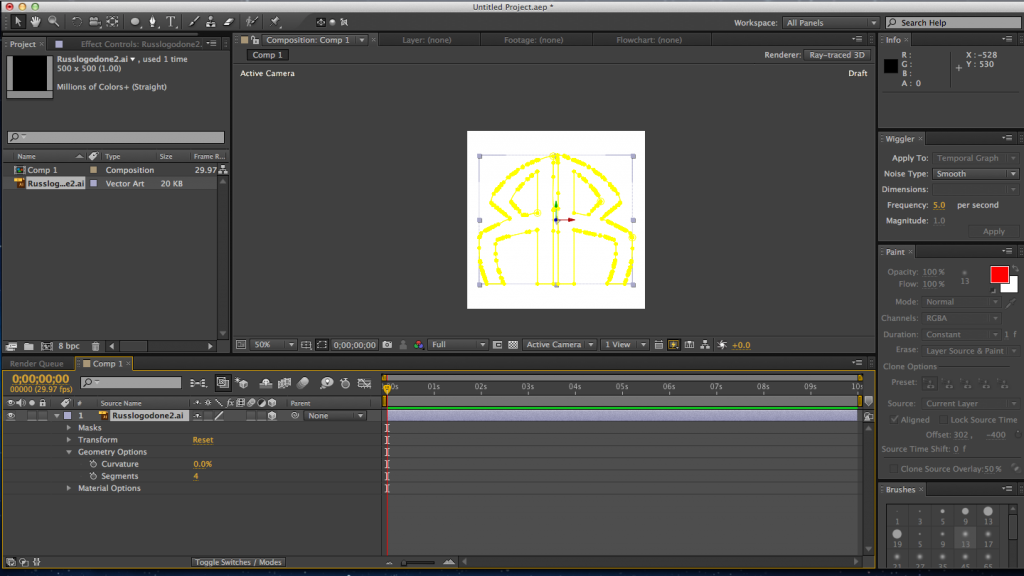

It still doesn't have the option to extrude. Is there something that I'm missing?
Heres what it looks like now:
I think that is the background of the AE comp, Is there a way to make that transparent?
It's next to where it says Active Camera on your screenshot. On the left there's a checkered button.
Although I'm not sure where to go from here. 😕 Considering I just tried to make a basic shape to see if the options would work that way.

The only thing that After Effects can extrude is text layers and shape layers, meaning that you need to be able to convert your graphic into a shape layer. For this, it must be a vector graphic format, preferably .ai. You CAN'T extrude an Ai file without first converting it to a shape layer.
NOTE: A "shape layer" is something very specific in After Effects, and not just a solid with a mask on it.
Import your .ai file into AE, drag it into a comp, then, with the layer selected, go to Layer > Create Shapes from Vector Layer. It will think for a minute, then create a shape layer version of your graphic. You will then be able to extrude the shape layer.
If it doesn't work, then your .ai file doesn't actually contain a vector graphic. From your screenshot, it looks like you might have chosen auto-trace instead of the correct option that I listed above.
If you can't do it, collect your project (file > collect files), zip up the folder that it creates, and upload it to your next post and I'll take a look.
I've attached a screenshot if that's useful to you.
I'm 99% sure that your issue is in what you're trying to extrude. If I were you, I would just quickly remake that logo in Illustrator (which is really the correct tool to use for logos), then save that and import it into AE.
