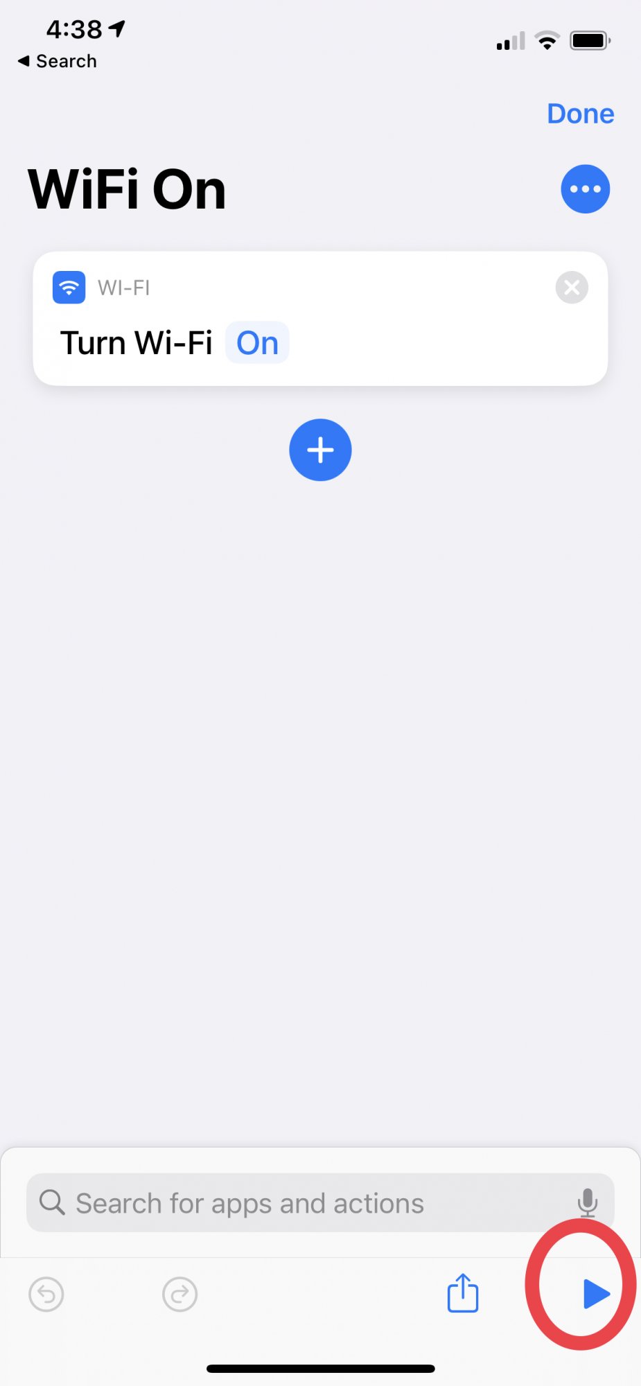

I don’t understand #12. How can it toggle but not toggle? Do you understand that, from that screen, you need to press the run button to activate the script?

1, When I said I toggled, what I did was toggle "on" and off" to make sure they switched, not realizing this was a choice rather than a toggle.
2, I see no "run button" that you mention but I assume "done" which is what I do see, is the same thing.
3, Turning WiFi on and off by using the control panel does not really turn it off, it just disconnects it from your wifi network. Try this..turn it off there but then go into your settings and you will see that WiFi is still turned on (and still using battery power...the status says that it is just not connected).
4 - So, now realizing that what I was thought was a toggle was actually a decisive action, I have created 2 shortcuts. One called WiFi On, the other called Wifi Off. What these do is actually turn wifi off altogether and not just disconnect from the network. Now I can have these two on my home screen. Not a big deal, but just a bit more convenient.

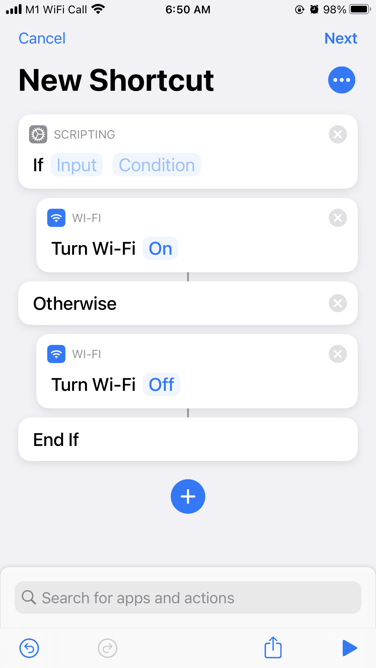

While we are on this topic, I thought of trying to streamline the shortcut but am stuck here. Does anybody know if it’s possible to have the system identify whether wifi is turned on or off and adjust accordingly?

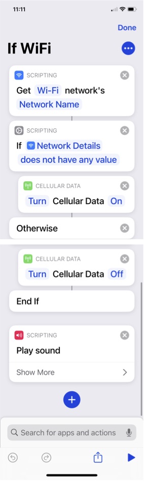

I have an Automation to trigger when I login to a known wifi network, which then triggers the following Shortcut...
I used an "IF" statement with the "get network info" in scripting (my example is for 'switching' cell data, but you can change it to wifi easy):
What we don't have yet is the reverse action in Automations/(passive Triggers): "IF not connected to wifi" command. I hope  will add it in an update. Most Automations have a positive action but not its opposite! ugh. this would open up ALOT of useful possibilities!!
