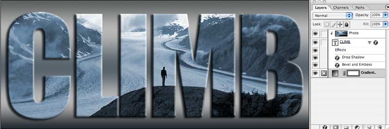

Open photo in Photoshop. Double click the layer in the layers palette.
Click on Type tool. Choose a fat type, like Impact.
Type something in big type. Put this new layer under the photo layer.
Select photo layer.
Press Command+G (or under the Layers menu, choose "Create Clipping Mask, or hold the option key down, and click between the photo layer, and the type layer below it).
You're done. Adjust type and photo as necessary. I like adding both a background layer, in this case a gradient, plus blending to the text layer.

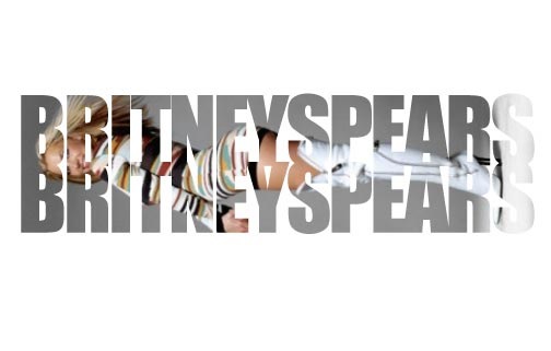

i did this in illustrator...and saved it real small filesize. thanks everybody for the tutorial 😀
