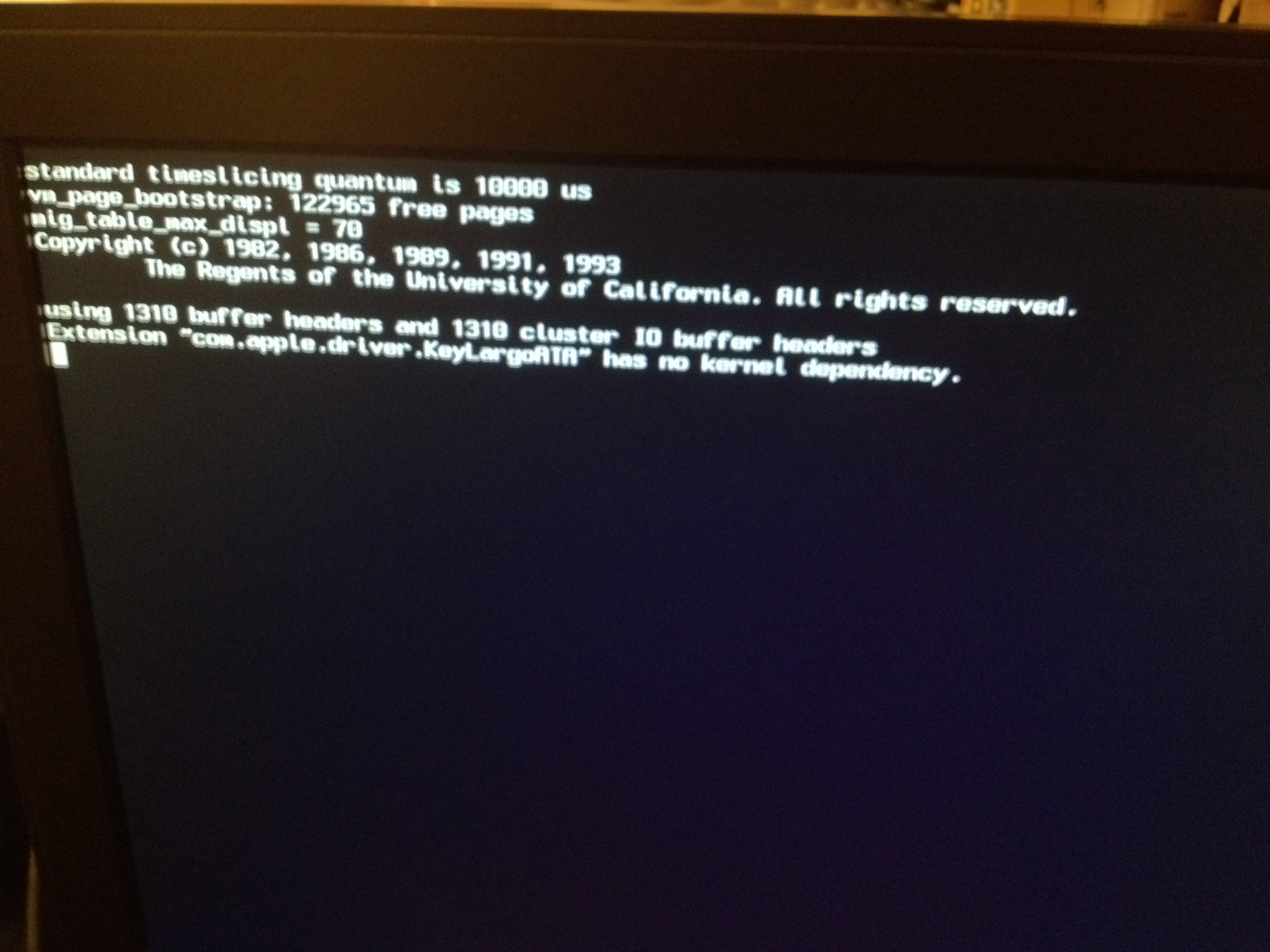

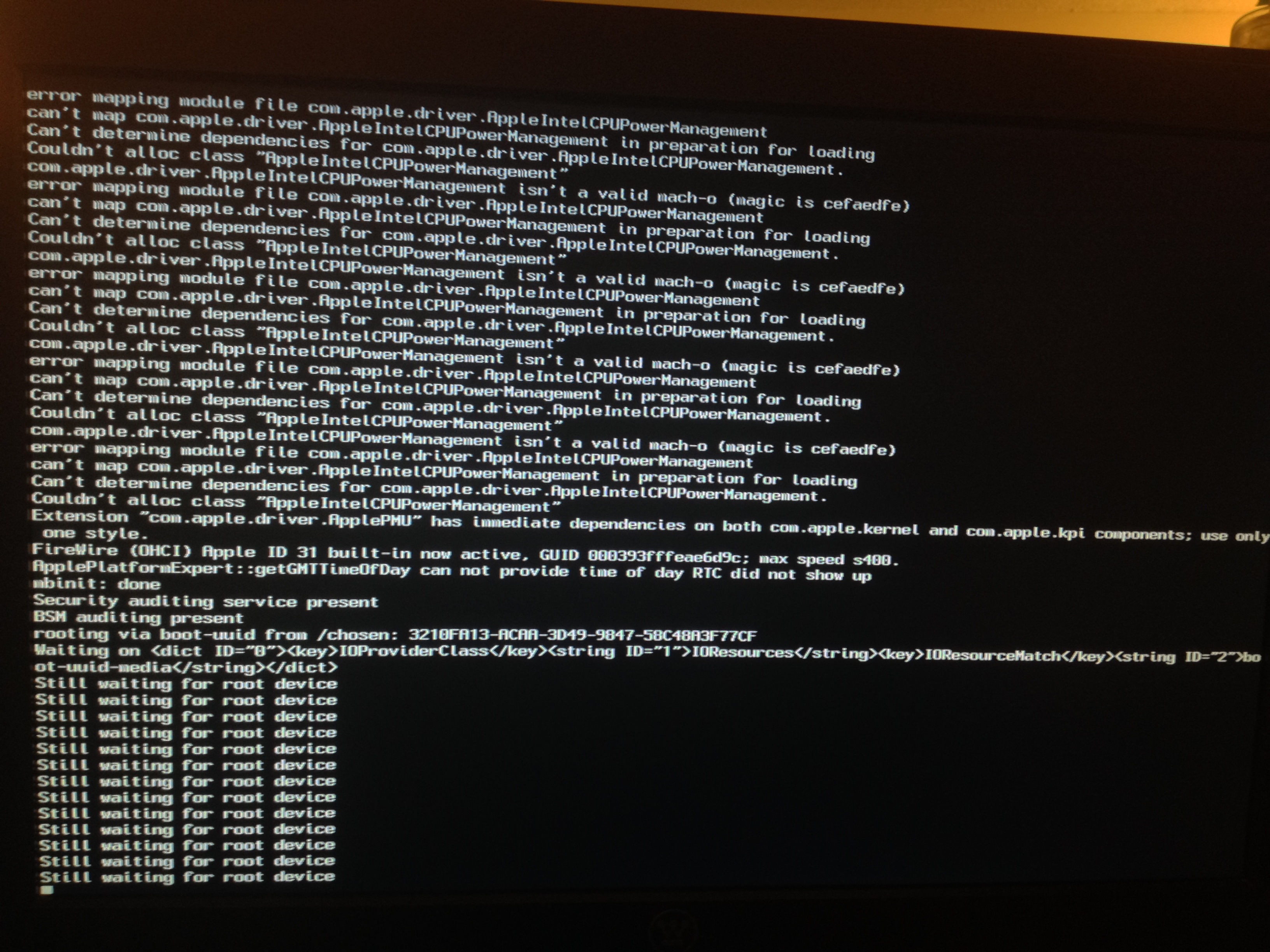

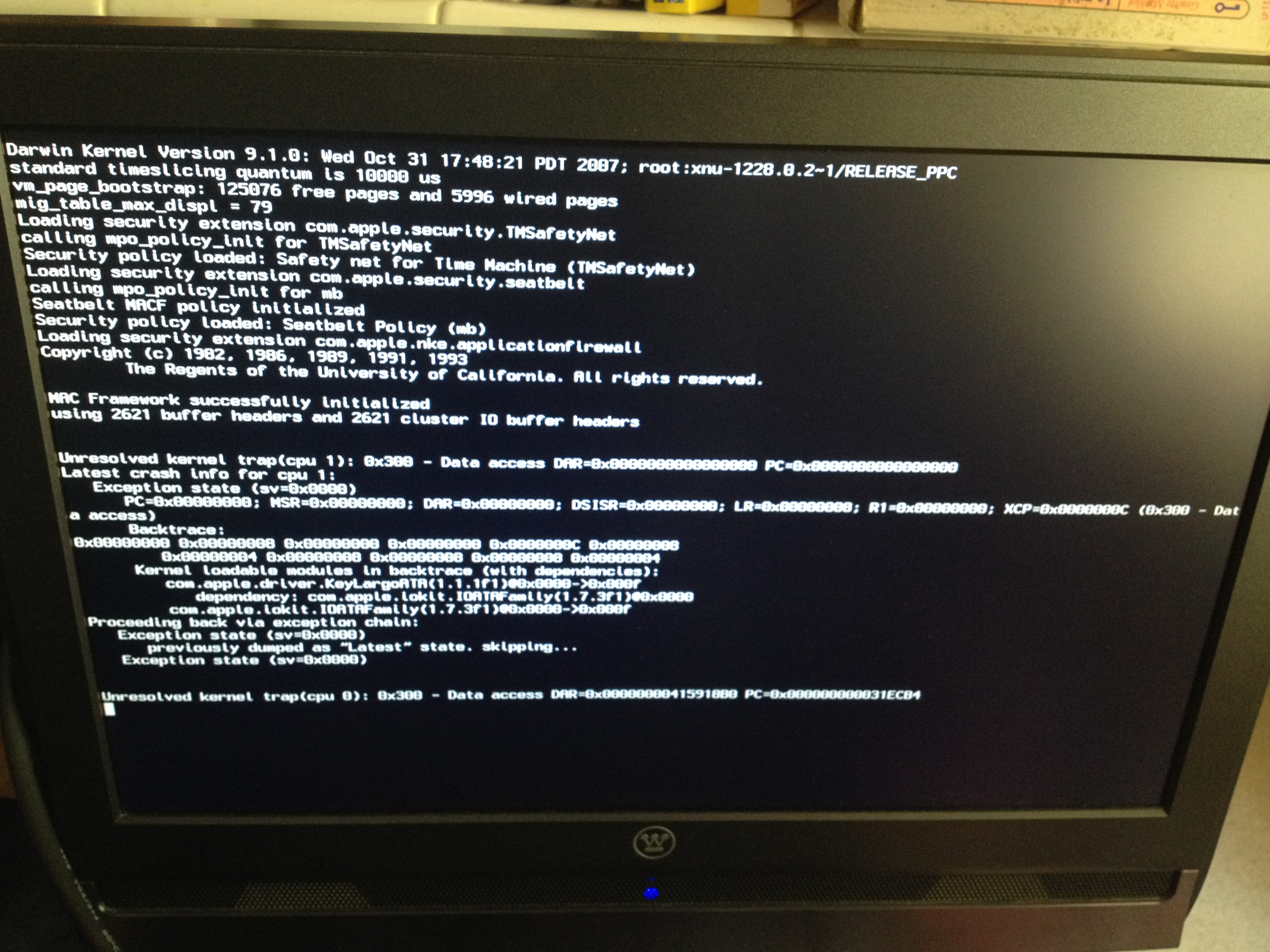

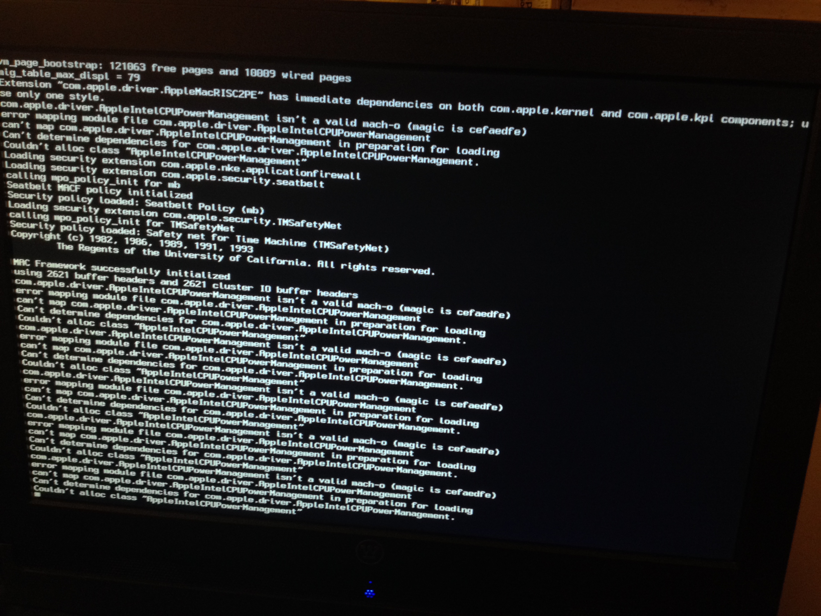

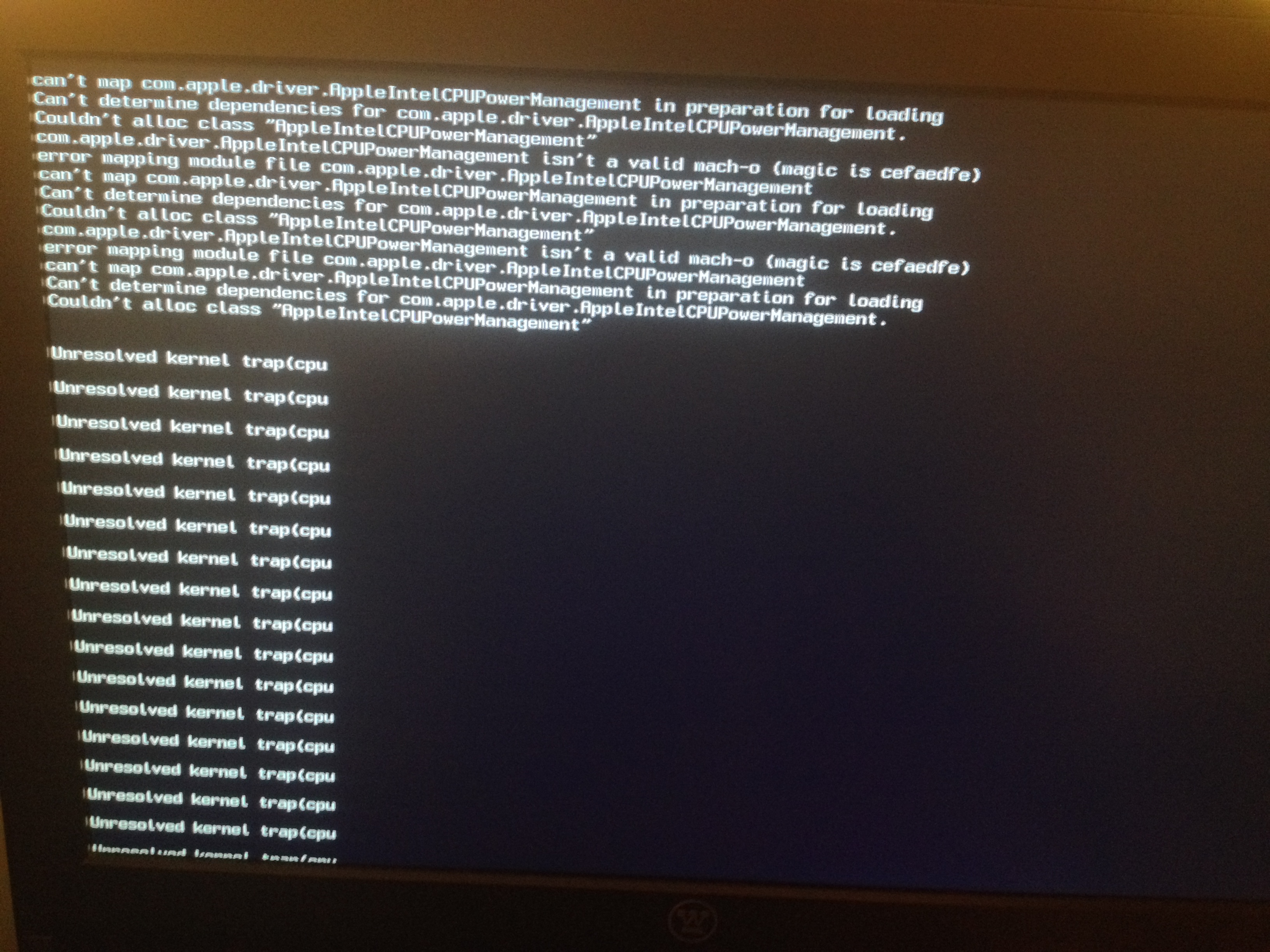

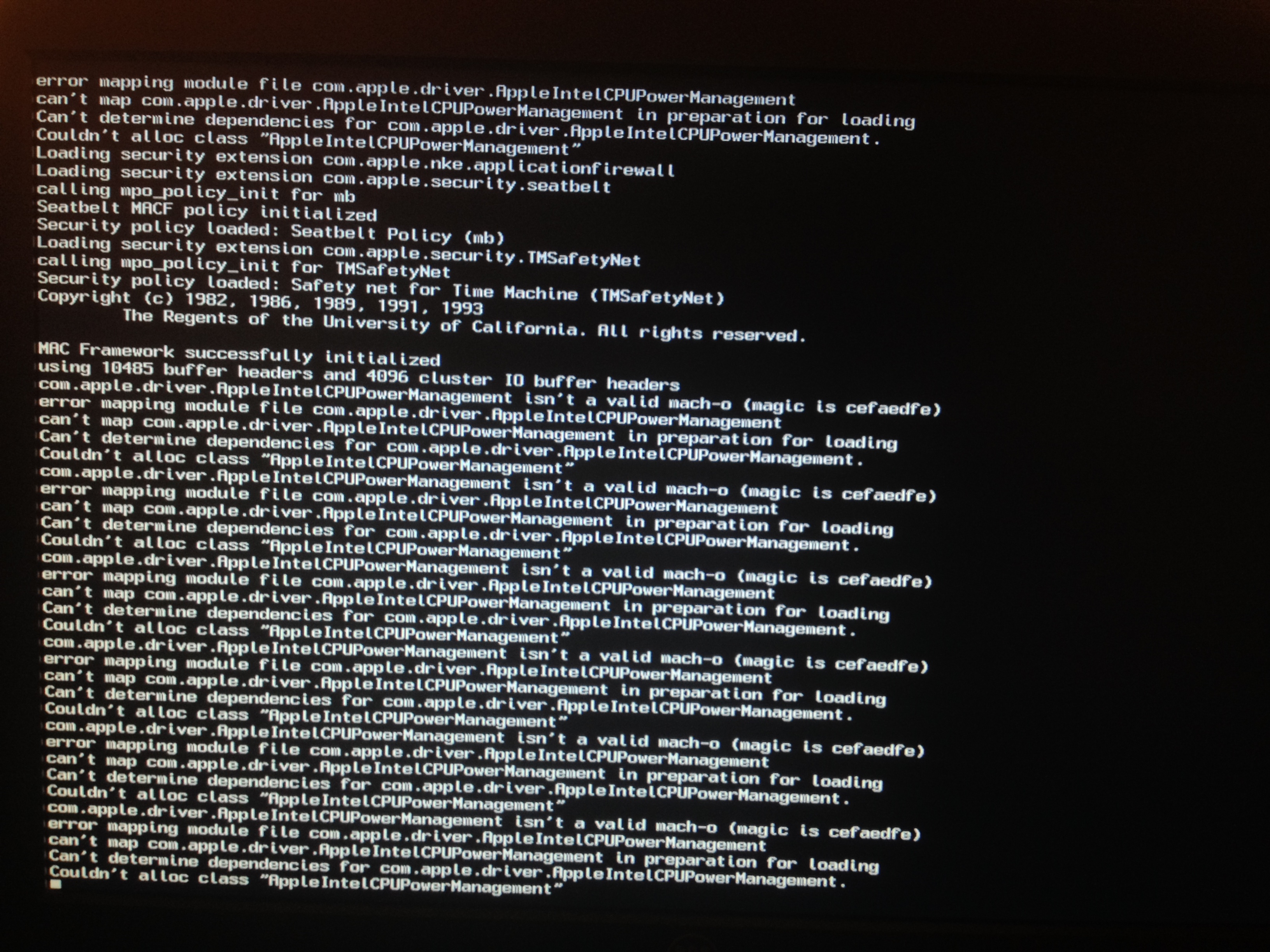

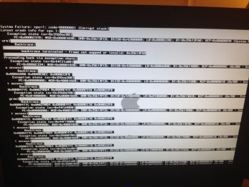

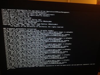

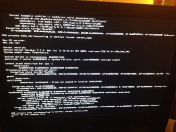

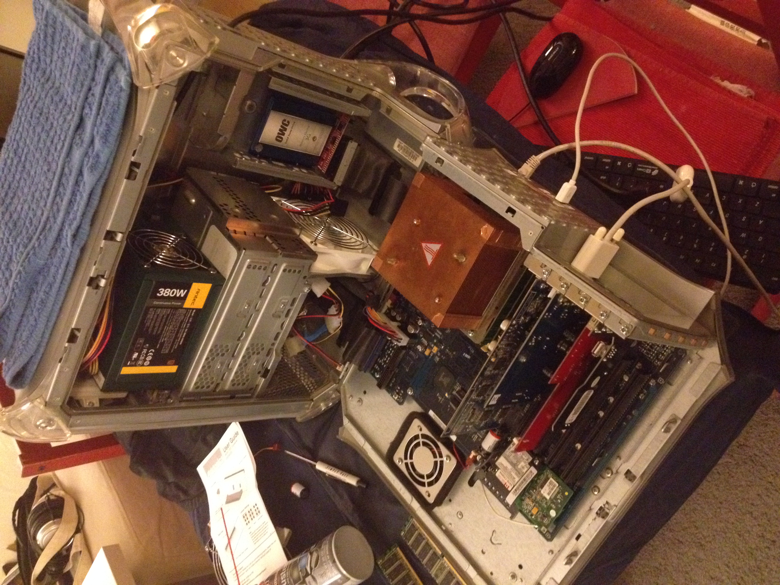

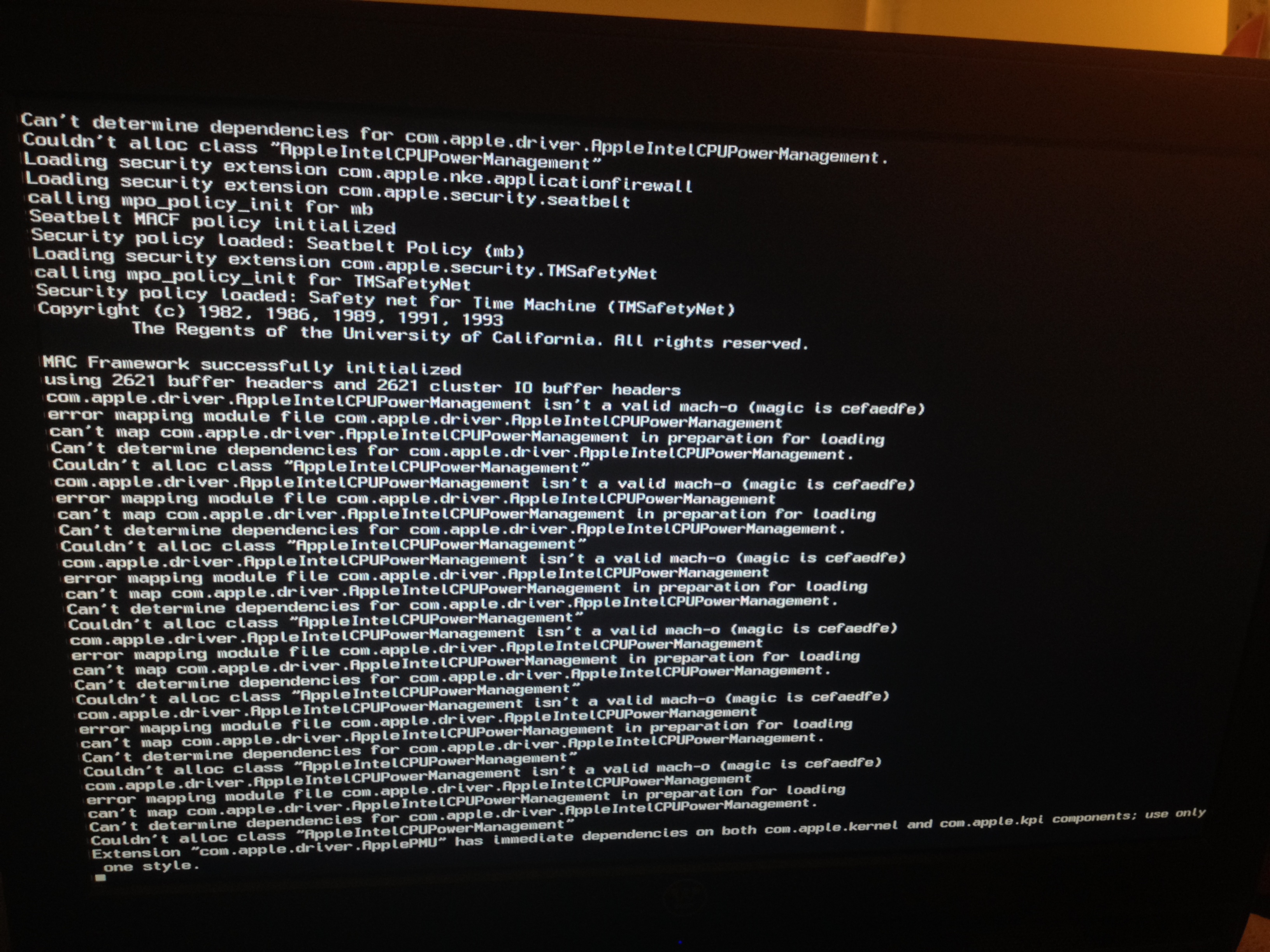

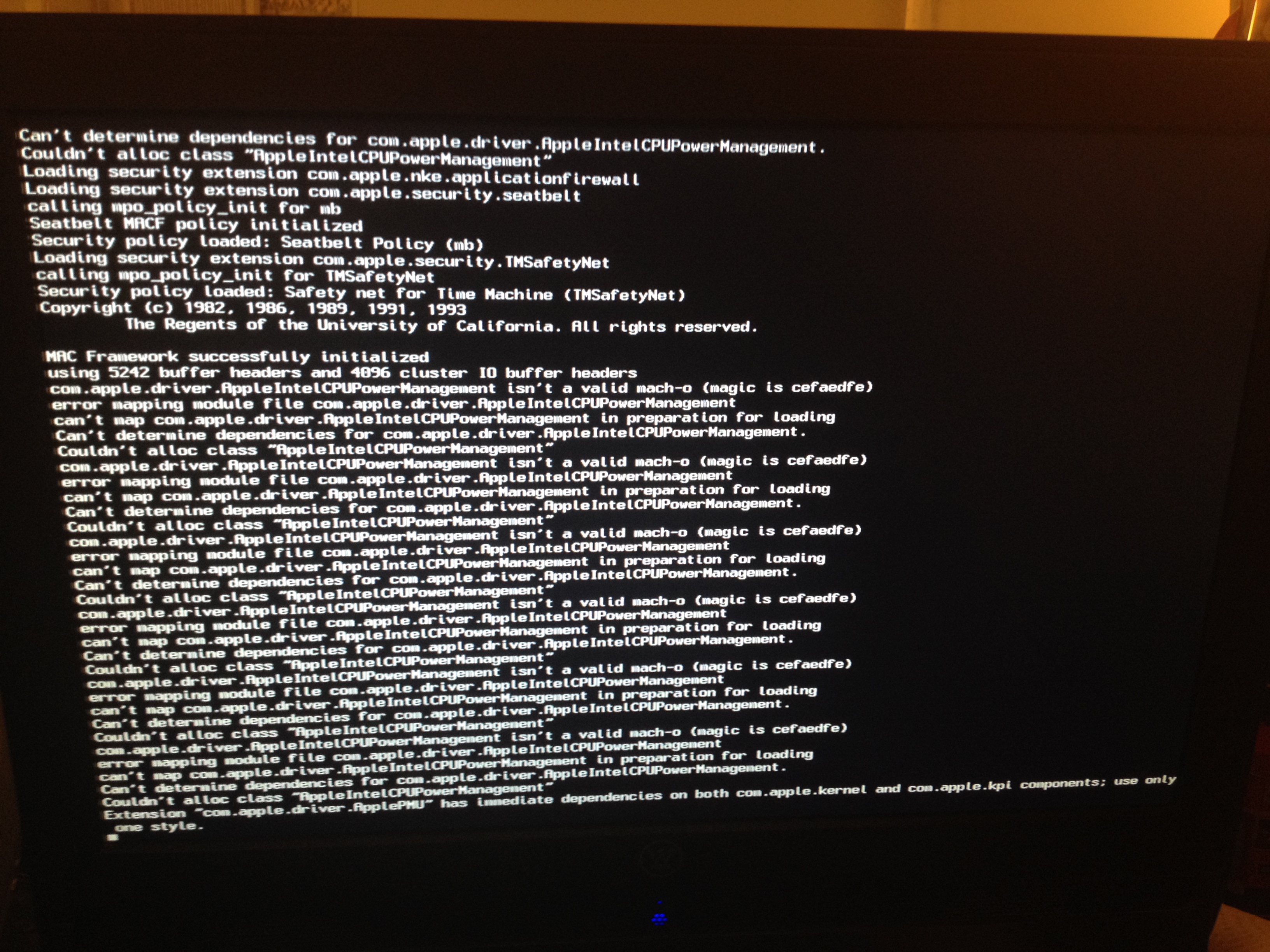

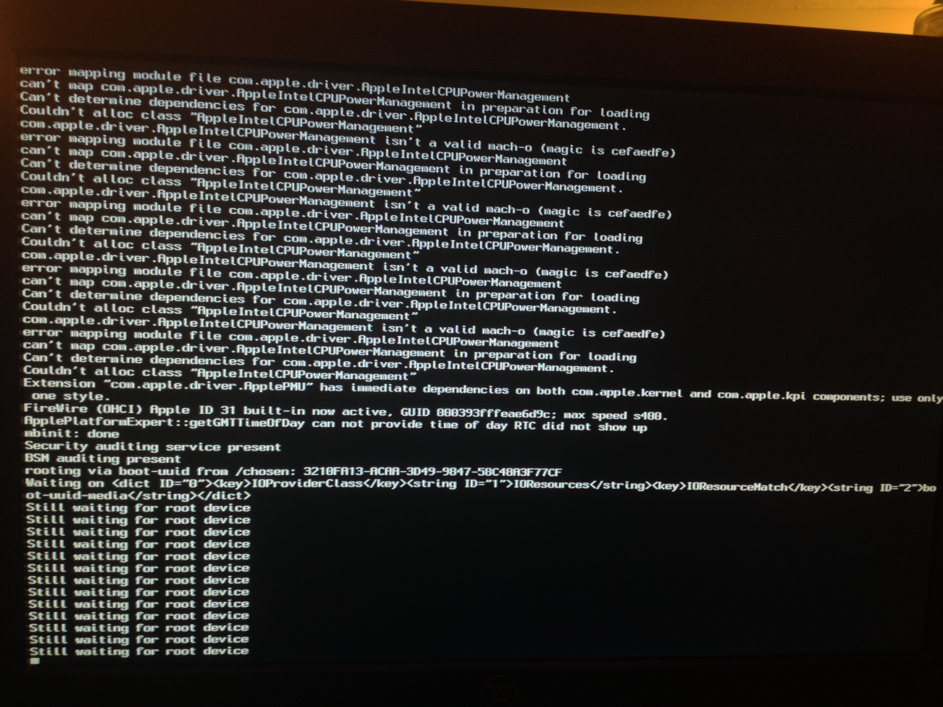

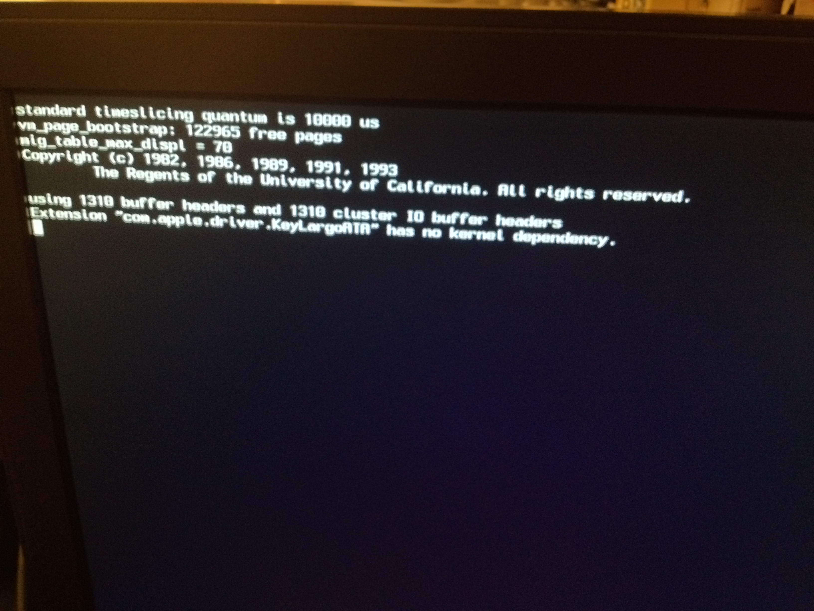

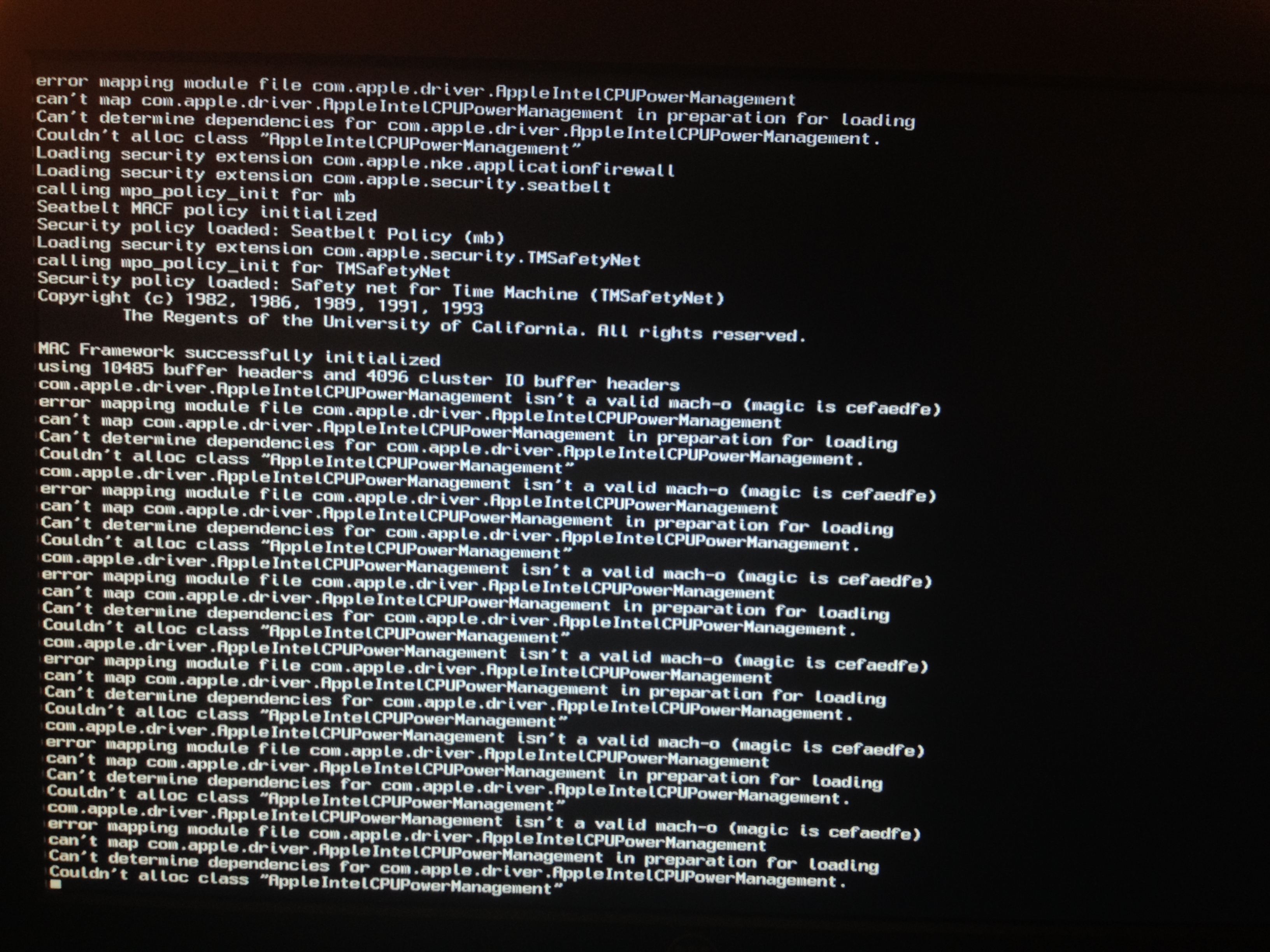

Hello everyone,
My trusted MDD G4 Dual 1.25 failed at booting a few weeks ago and, despite my best efforts, it wouldn't boot into anything without displaying a kernel panic. The only exceptions were Target Mode and Volume Boot (Option at Startup). I got a used motherboard off Ebay and it worked perfect for a couple of hours then it started to display the same issues again. I'm starting to believe it's not the motherboard but the processor which is the issue. I did a few Safe Boots and took a few pictures of the screen once the process had stalled. Please let me know, after looking at those, if anyting catches your attention. Thank you.
More Pics

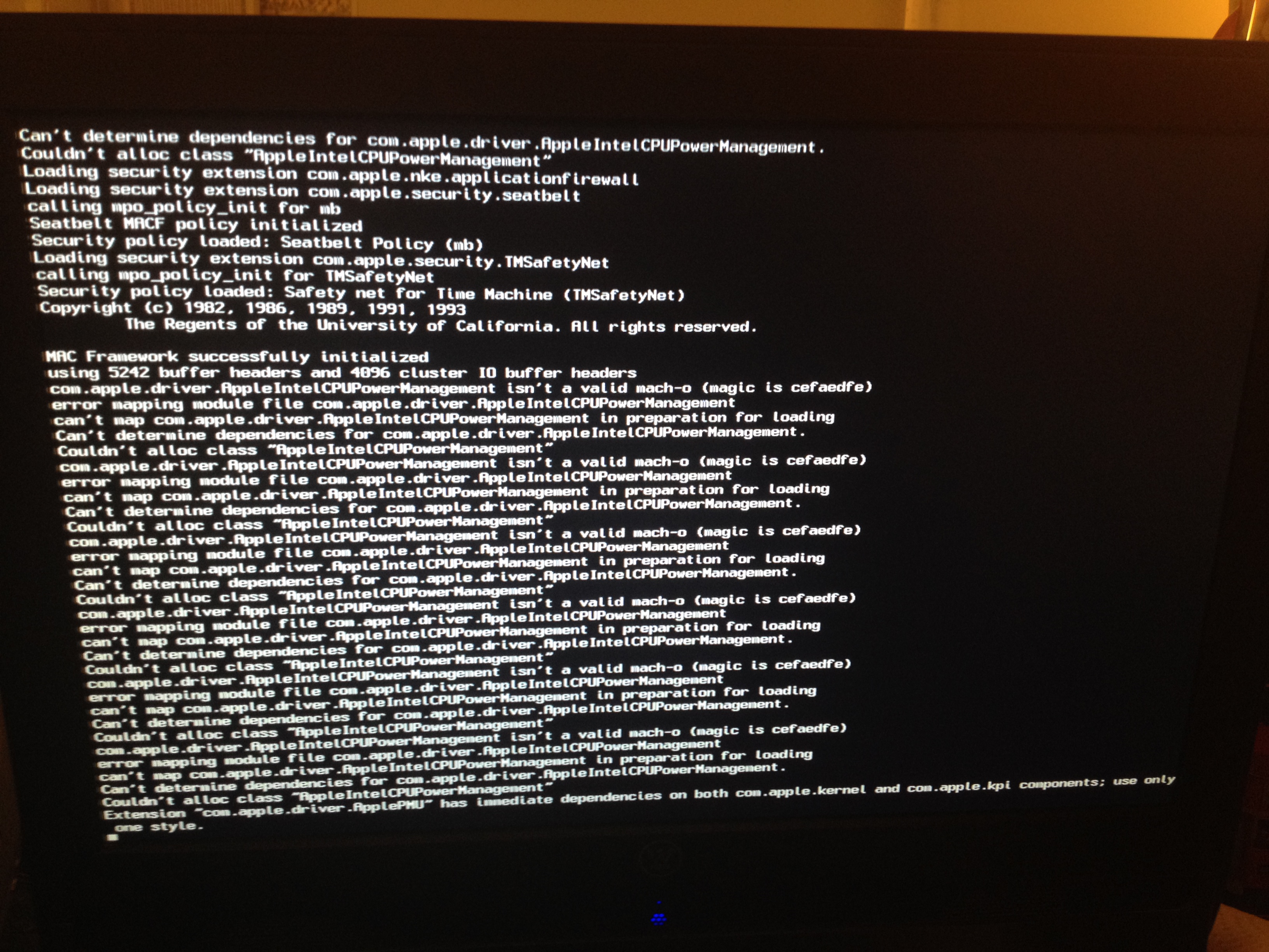

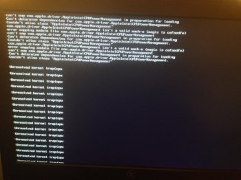

More Pics. Please note the MDD is down to 1GB of Ram, 1 Radeon 9600 (tried the 9000 but it made no difference) and an OWC SSD for boot (using a regular PATA boot drive made no difference either).

I'm going to take a wild guess here and say your install of OS X is corrupted. In that case, I would first back up any important files and then I would reinstall the OS.
I'm not very "fluent" at Unix, but some of the errors I'm seeing seem to correspond to corrupted permissions and/or a corrupted install.
Try one or both of the following if you can:
1. Boot the computer into TDM, and then connect it to another computer running the same version of OSX. Load disk utilities, then repair the permissions on the volume in your MDD.
2. Boot the MDD into single user mode(command+S). If it boots, it will boot to a command prompt. Once you see this, type /sbin/fsck -fy . It will take a few minutes to run. If, when finishing, you get the message "FILE SYSTEM WAS MODIFIED" run fsck again and keep doing so until it doesn't return this message.
If neither of these work(do both if you can), archive and install is probably going to be your best bet.

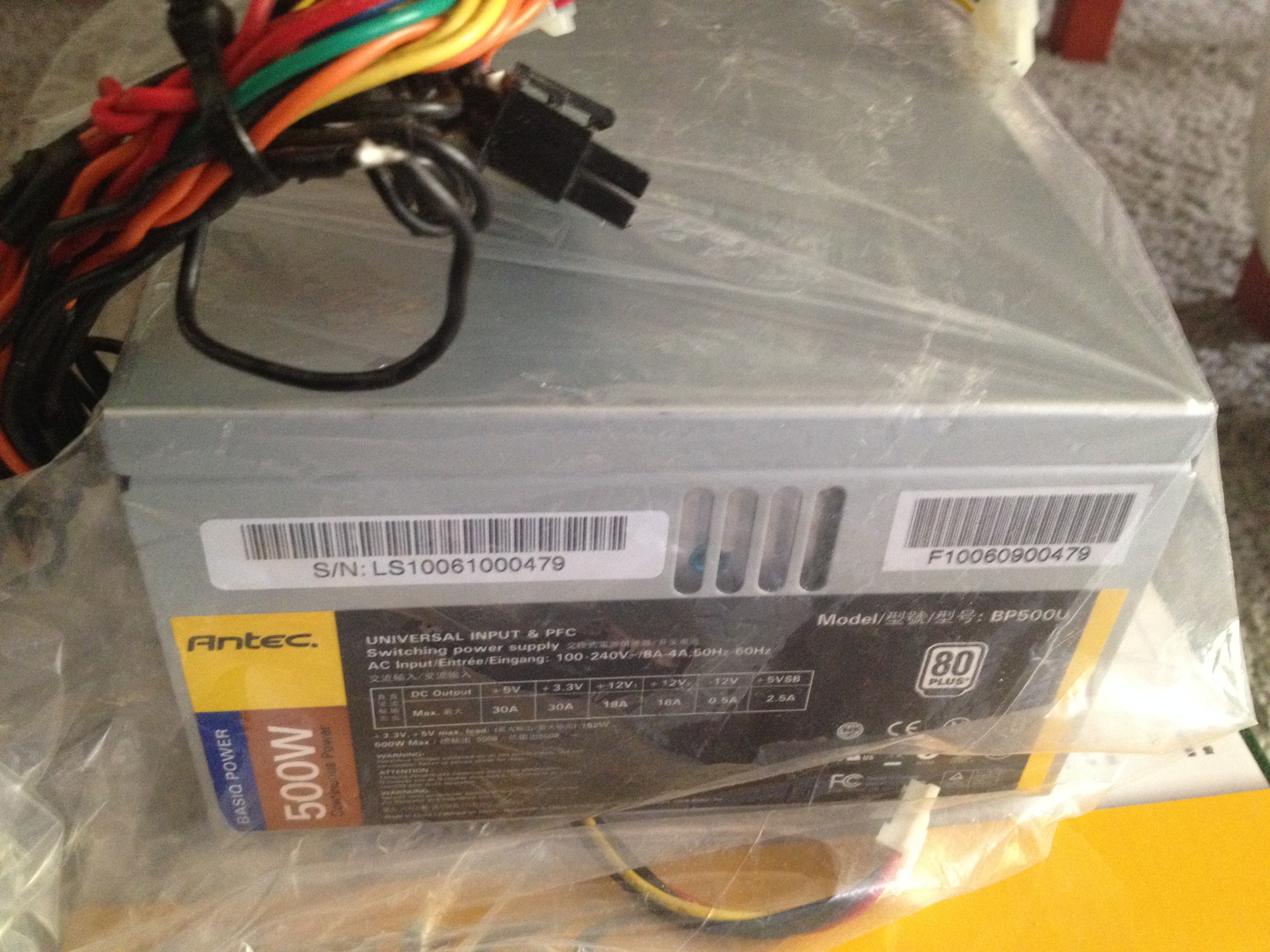

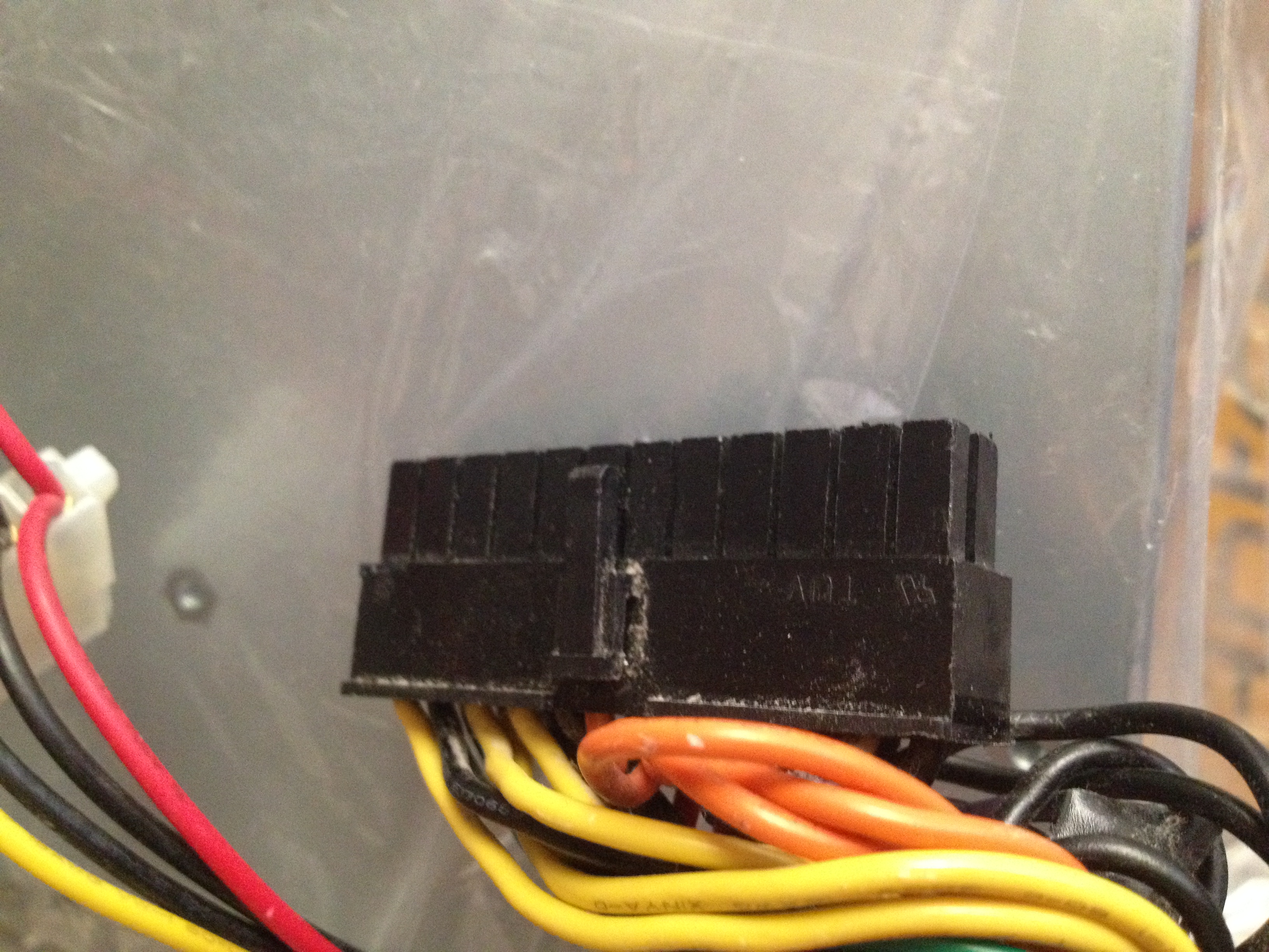

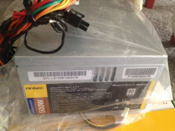

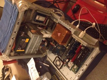

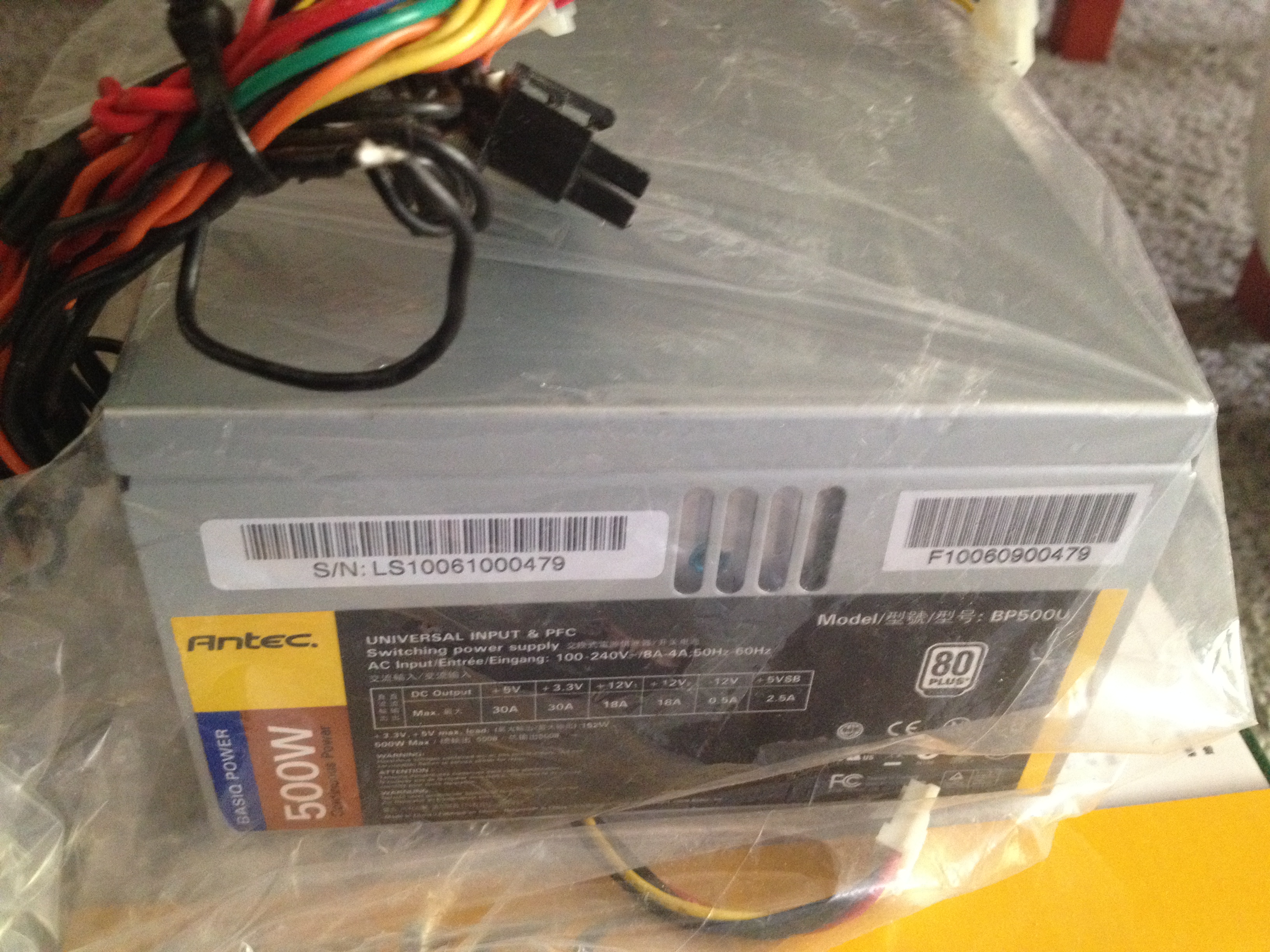

@for this: "My MDD didn't recognize all the RAM, and often had KP/erratic boot when the power supply was bad."
Power Supply is brand new (pic below). It's only 380W but that should do easily for a simple MMD setup (media player). Note that the newer 430W and 500W P/S from Antec do not have a dorsal fan (only a side fan) and it makes for a difficult install in an MDD.

With that said, since it KPs on the install disk also, that makes me think it's most likely a hardware problem.
Also, you mentioned that you've taken it down to two 512mb sticks of RAM, but it's entirely possible that one of those is bad. MDDs will boot with a single RAM stick(unlike G5s) so I'd try taking it down to a single stick and trying each in turn absolutely eliminate RAM as a problem.

@ mikiotty: "Was that pic taken before or after the troubleshooting you did?"
The picture was taken before disassembly. It was included to show the P/S. The unit is down to the Graphic Card, the OWC SSD and 1GB of Ram.

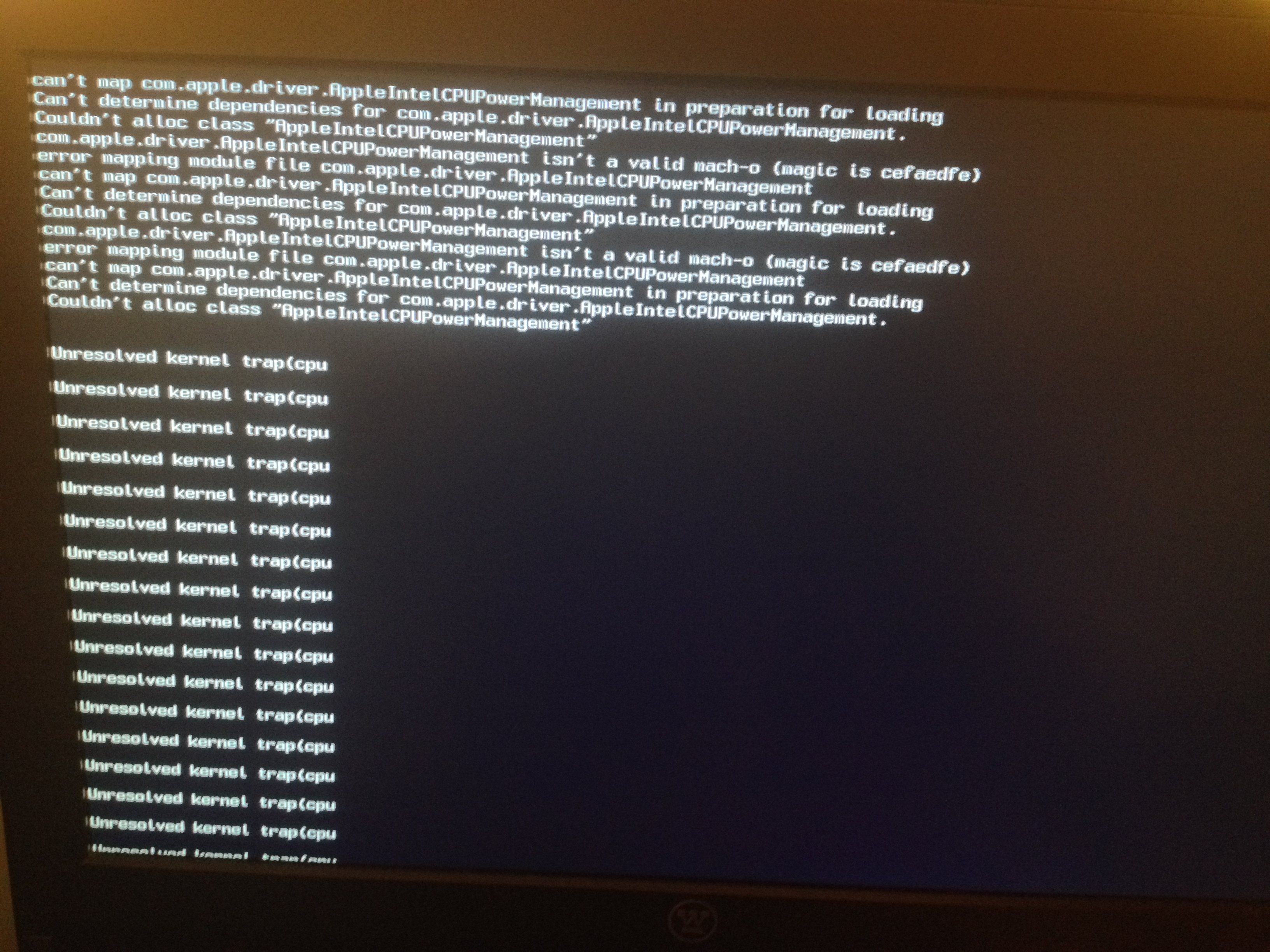

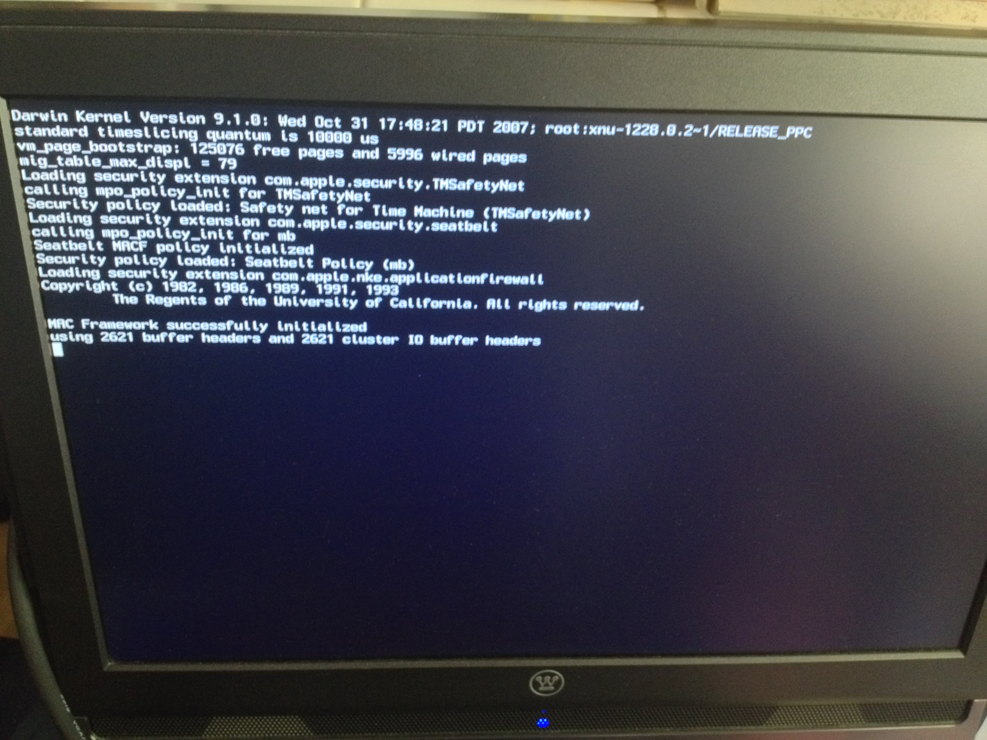

Single User Mode
bunnspecial: "2. Boot the MDD into single user mode(command+S). If it boots, it will boot to a command prompt. Once you see this, type /sbin/fsck -fy . It will take a few minutes to run. If, when finishing, you get the message "FILE SYSTEM WAS MODIFIED" run fsck again and keep doing so until it doesn't return this message."
Hi Bunnspecial,

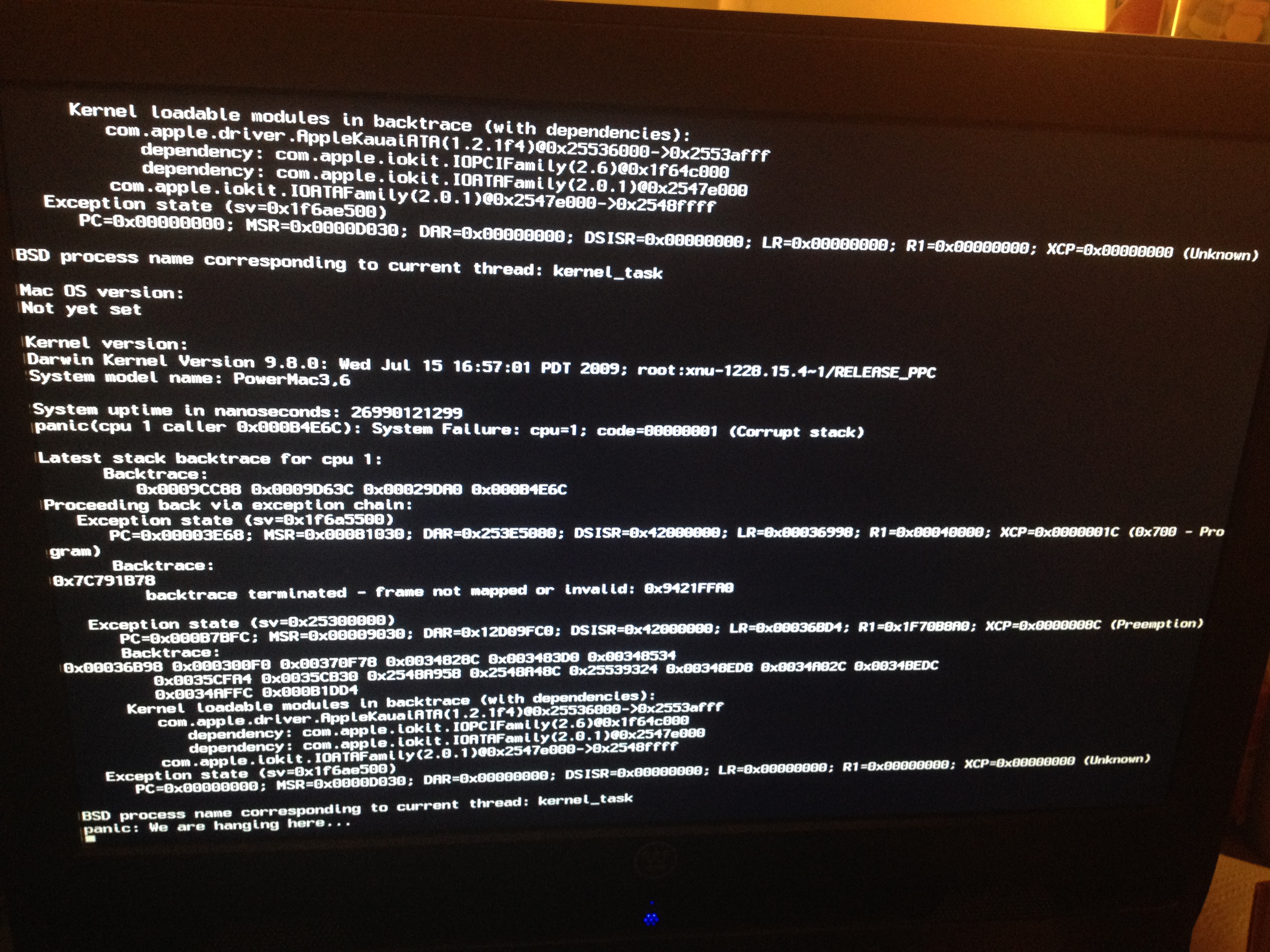

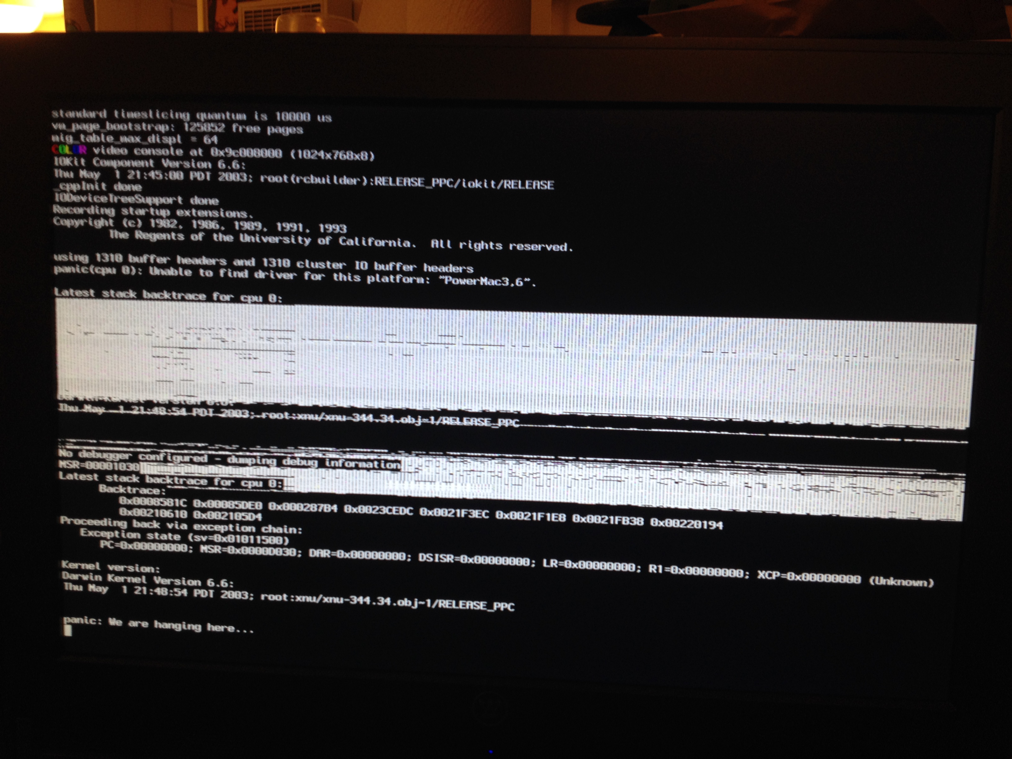

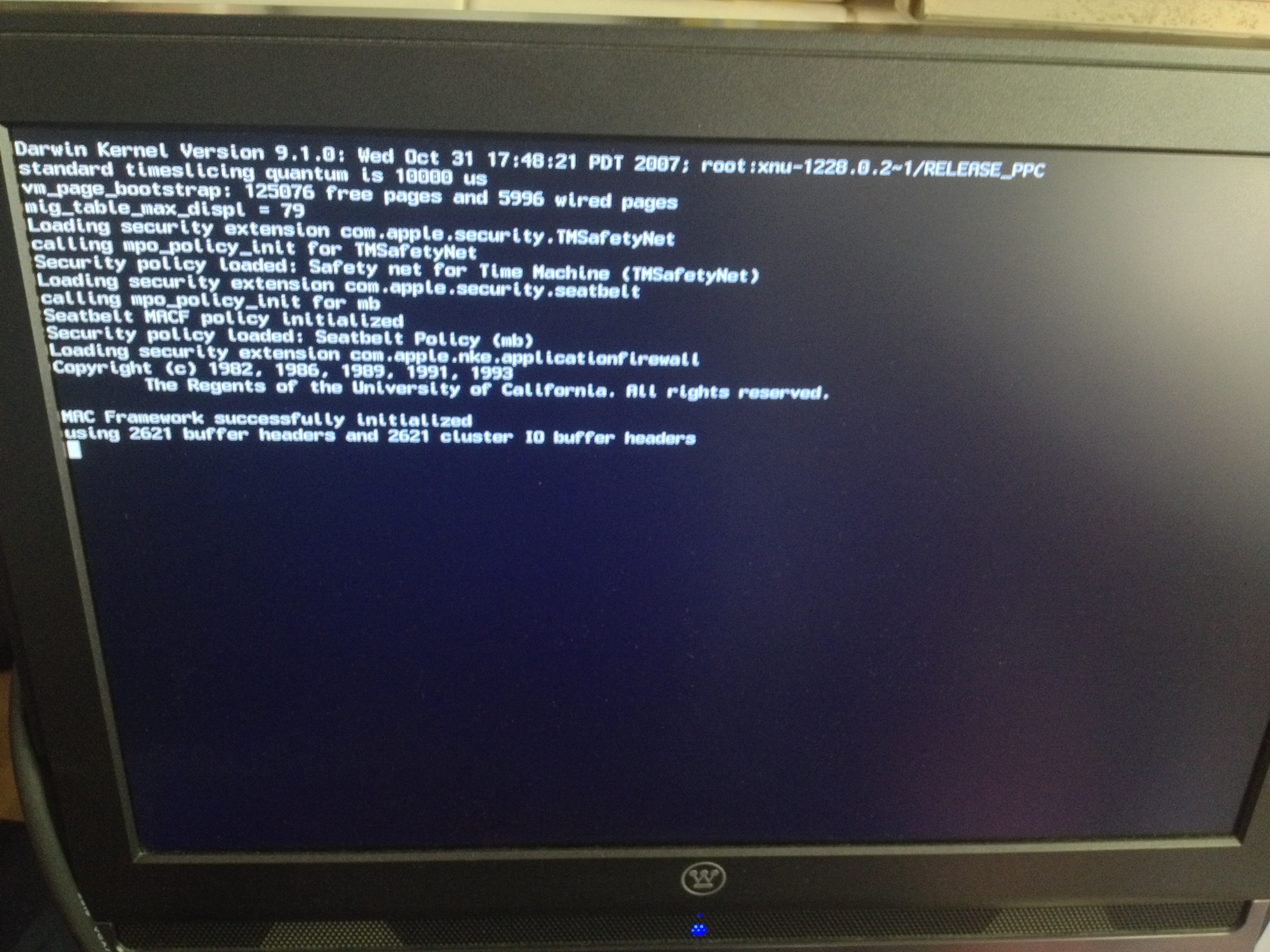

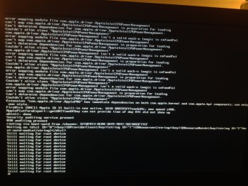

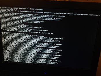

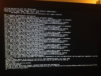

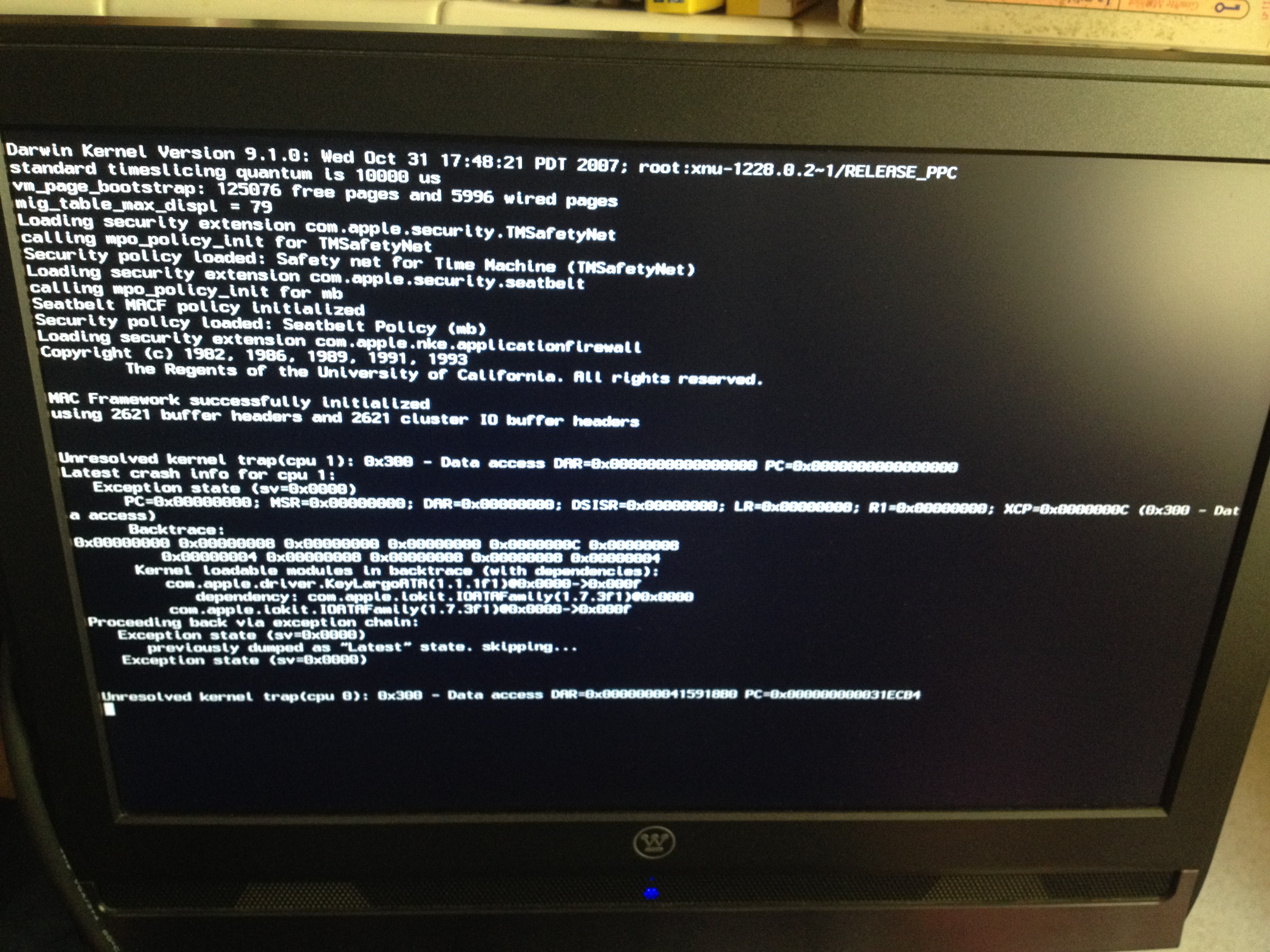

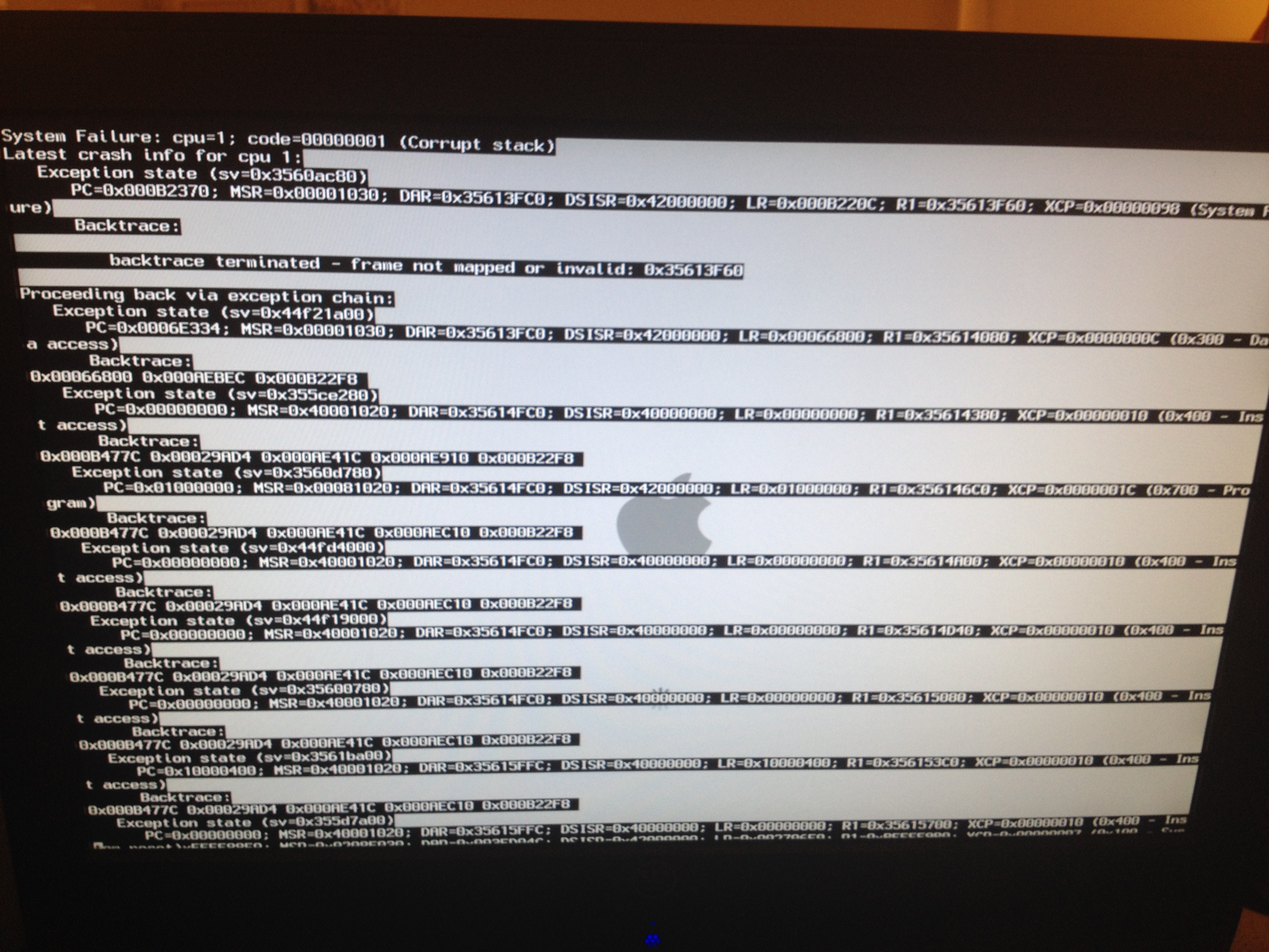

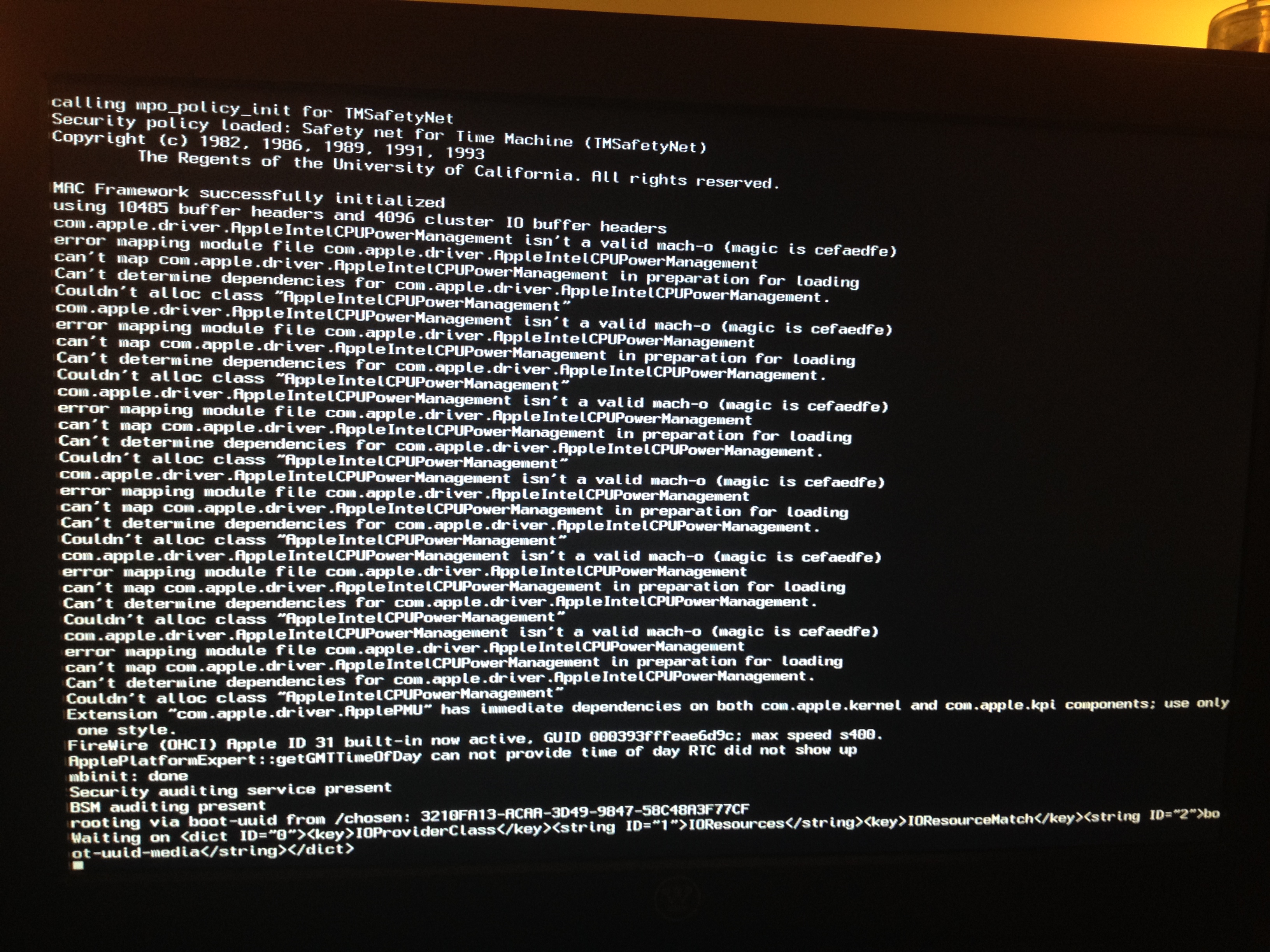

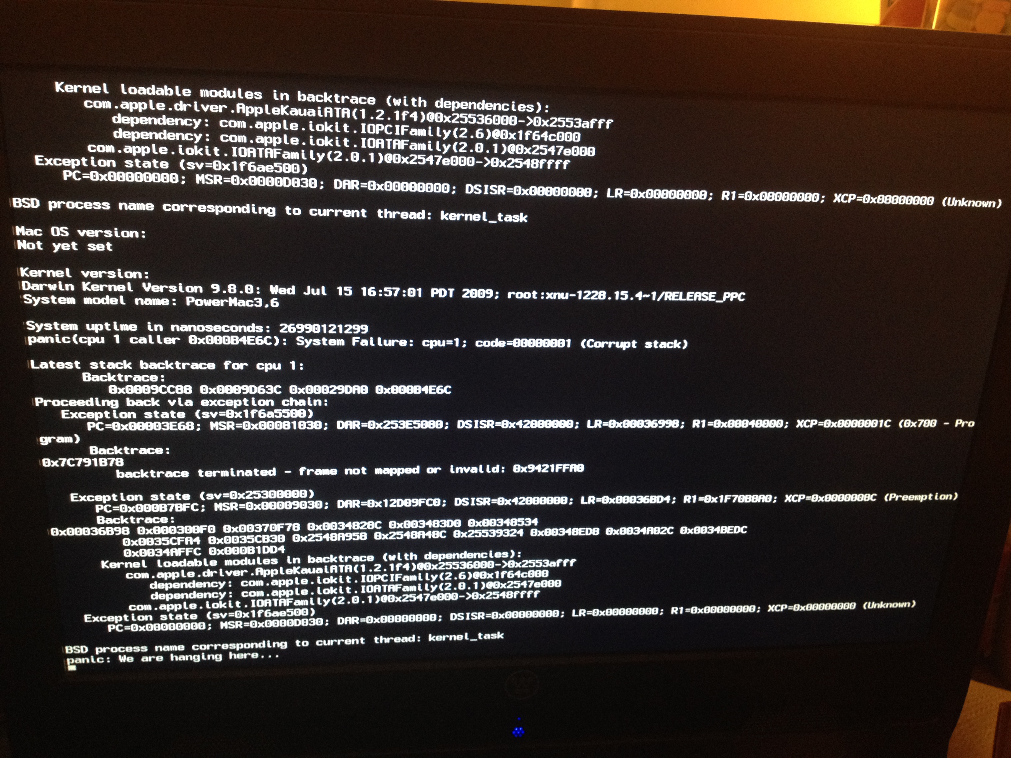

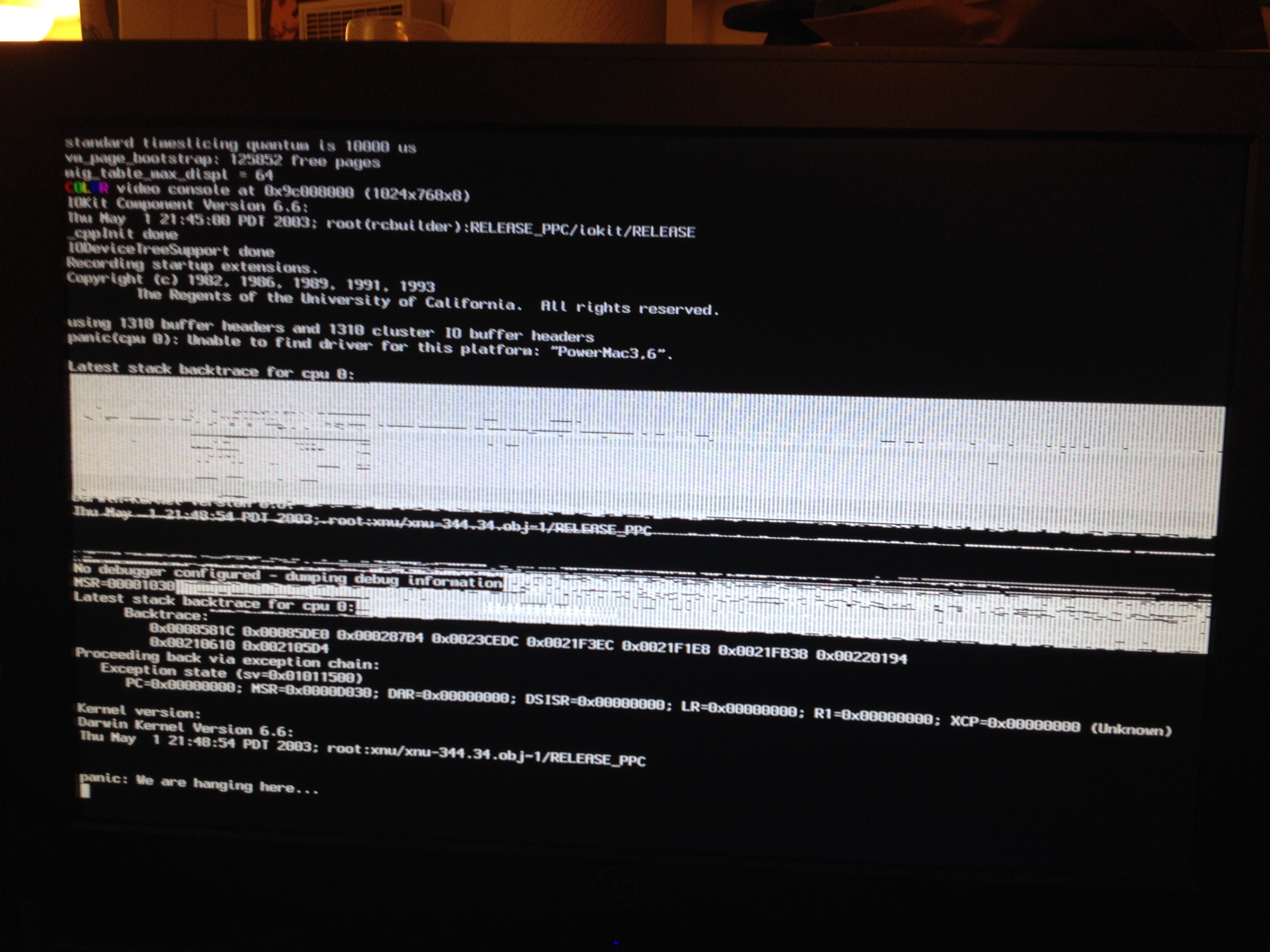

I got some new, new ram from OWC yesterday (+ retroverted to the RADEON 9000) and attempted to log into Single User Mode but it's again total fail. It either freezes or brings a Kernel Panic. I actually had some success earlier this week booting from the OWC SSD and the LEOPARD DVD but KPs happened within minutes. At this point, I'm waiting for a new Dual processor in the mail and see how it goes from there.
Pics from Single User Mode are below.

from what I can tell looking at your kernel panic Leopard is crashing on your ATA bus... so It would seem something on your ATA bus is causing issues (not the first time I have seen an MDD with a dead ATA bus) and I see still waiting for root device. this means OS X cant find the HDD its booted from... make sure all your Jumper settings are correct and you don't have a broken ATA cable.
Need help diagnosing MDD issue
Better yet, OP, Try switching the HDD to a different drive Bay and see if it works there as opposed to the one it's currently in.
Gamer, I don't think that G4 towers have slots like the mac pro with an equipped sata connector, especially since this is IDE.
Do you mean moving the connector from one HDD to another.
Also, try another IDE cable.
MDDs have three ATA busses.
The "main" bus is ATA/100 and the cable is normally routed to the cage under the PSU.
The secondary bus is(I think) ATA/66 and is routed to the hard drive case under the optical drives.
The third is ATA/33 and goes to the optical drive(s).
This allows for a total of 6 installed ATA devices.
The computer will boot off a drive installed at any position in any of these busses, so the suggestion to move the drive to one of the others is a good one.
What Bunn said above is what I was referring to.

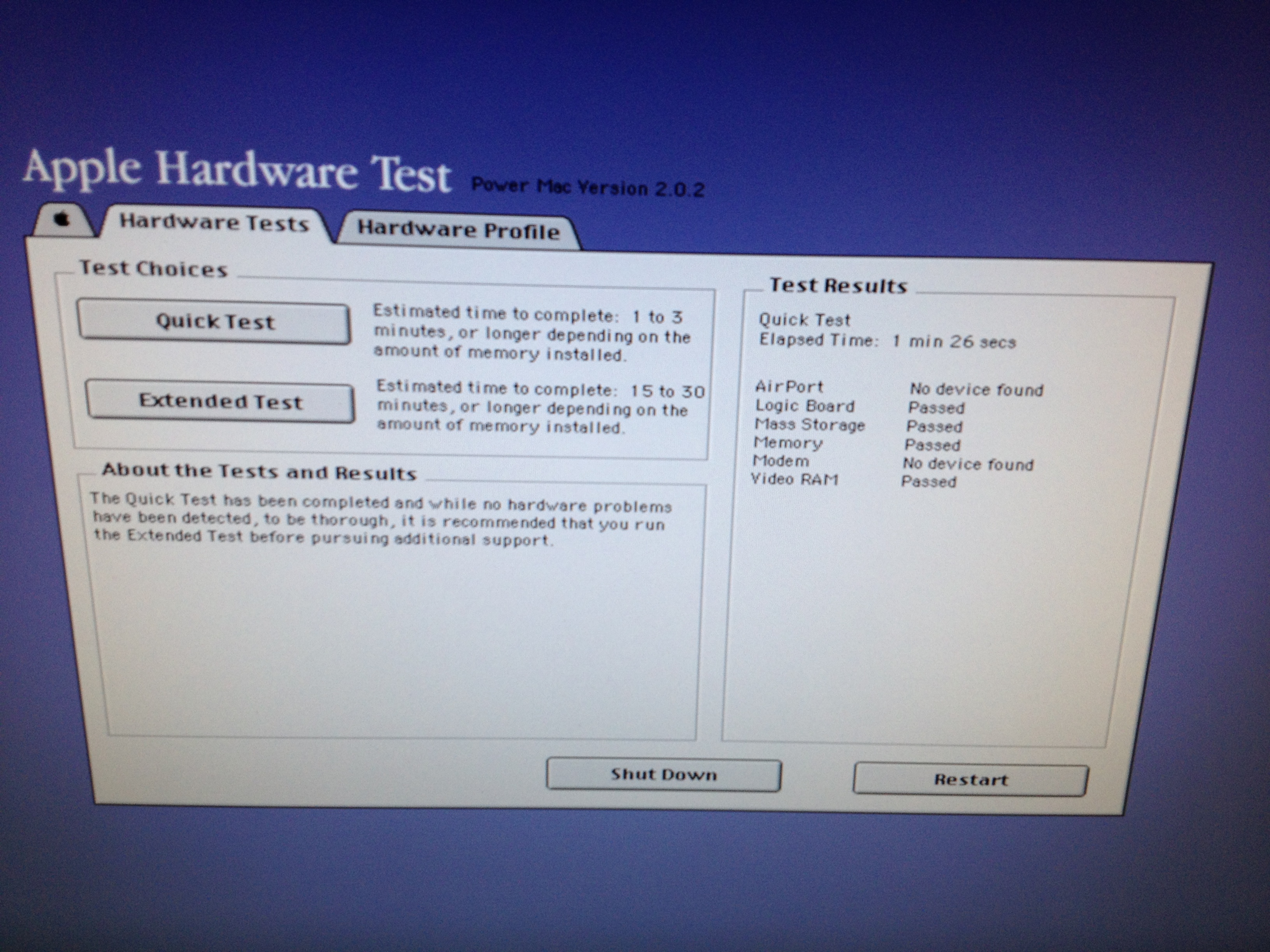

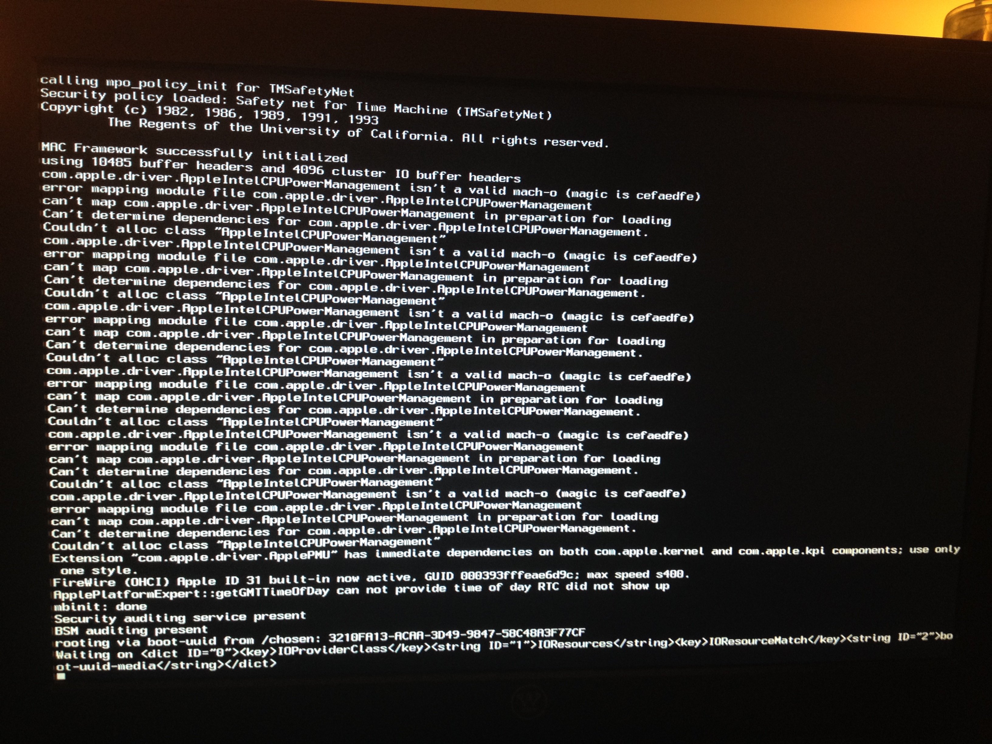

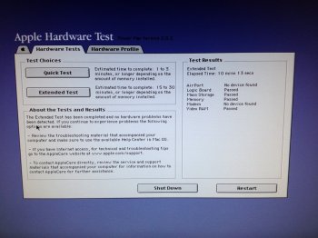

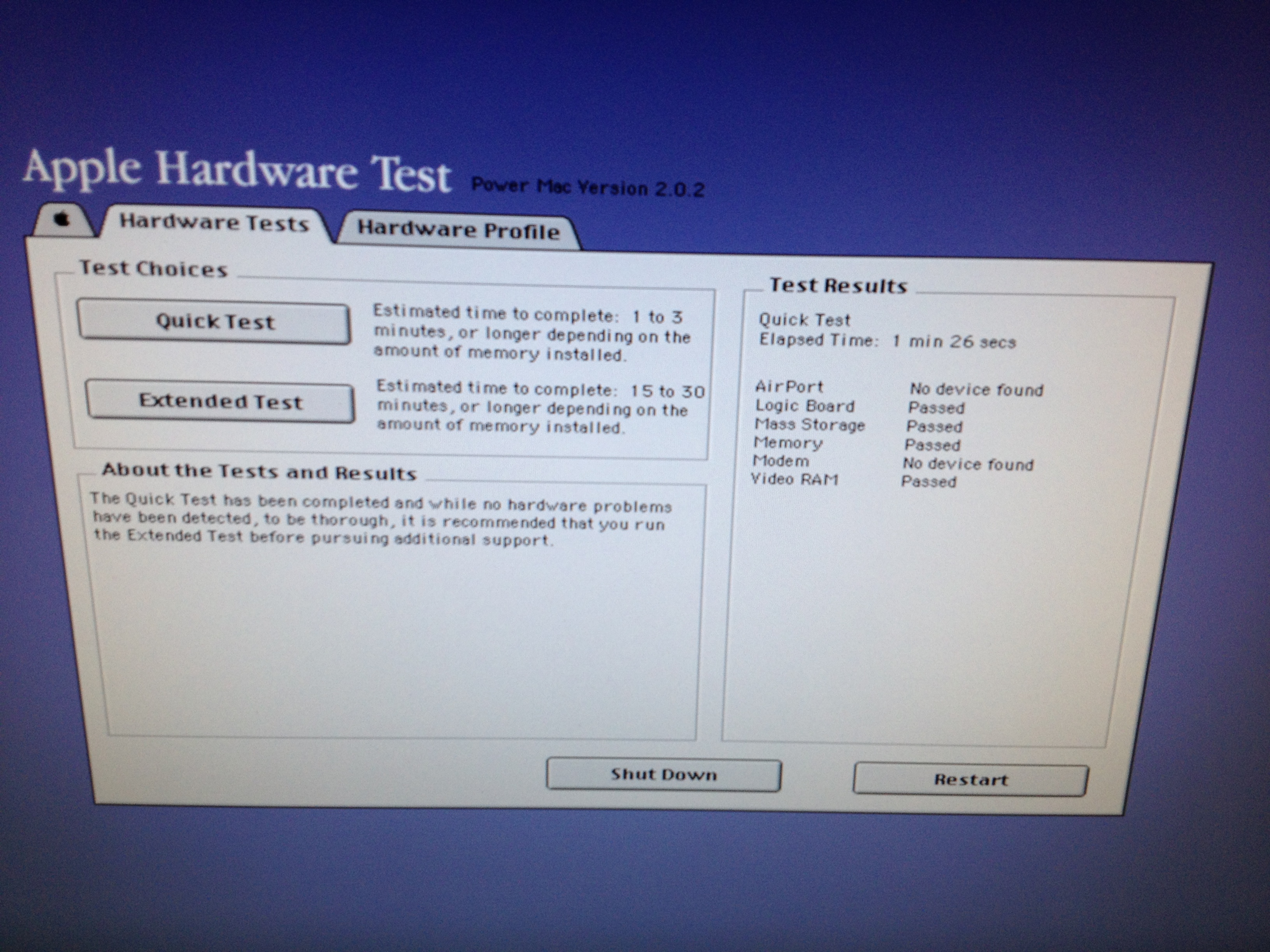

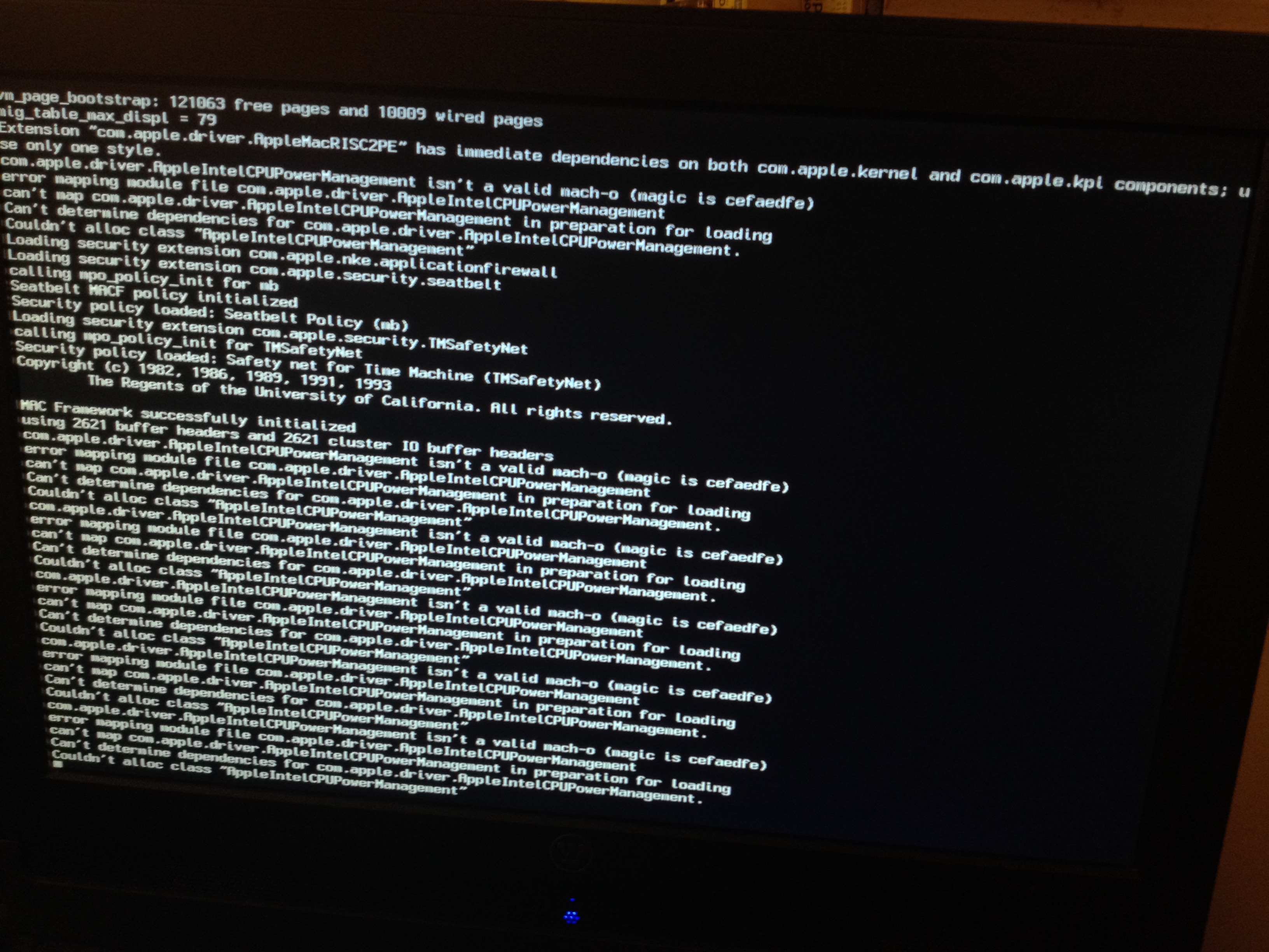

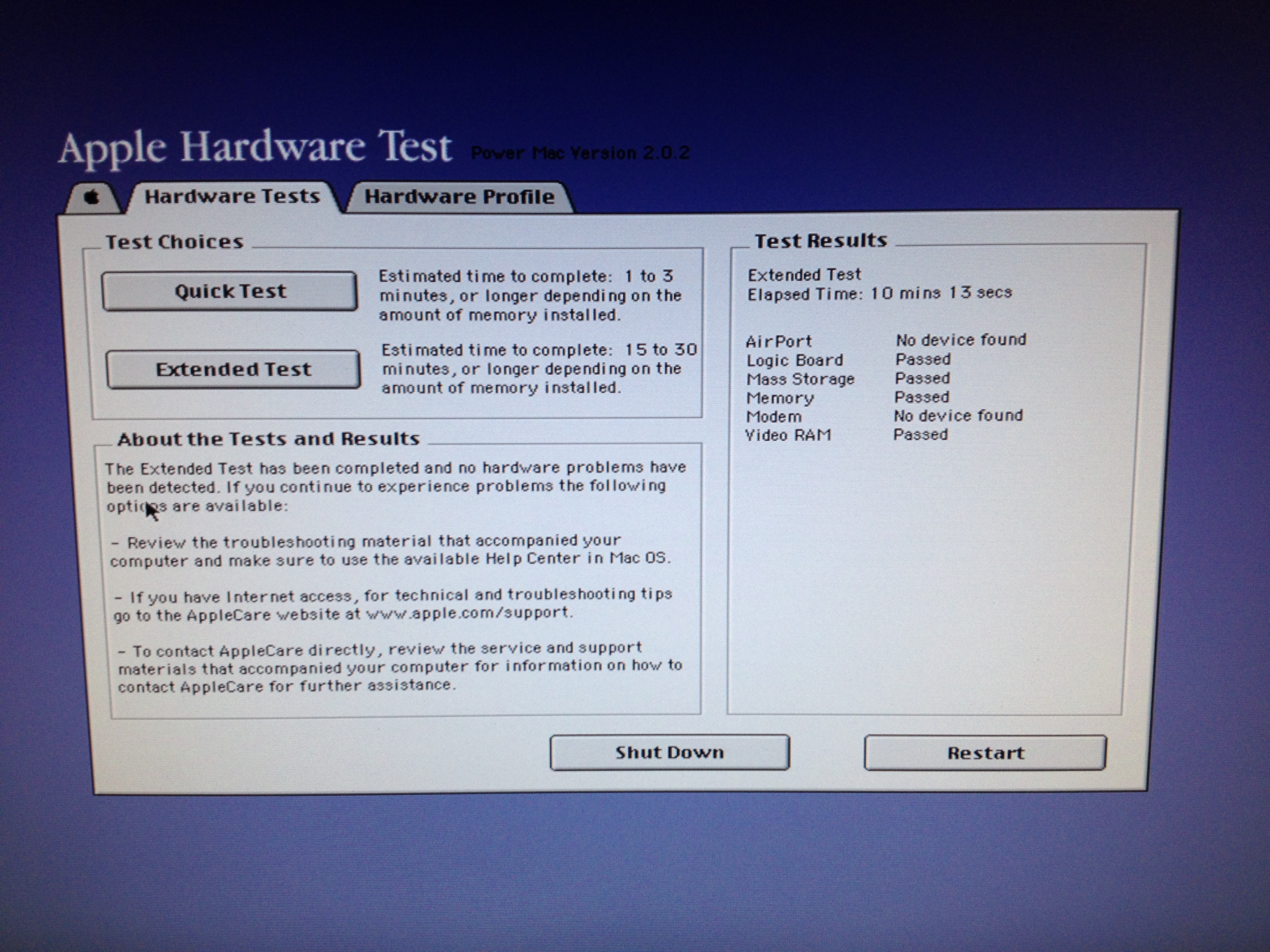

Hello everyone!
I was able to boot from the AHT disc and ran 2 test (long / short). In both cases, the motherboard seemed legit. When I tried to boot into my original MDD Install Disc (same as AHT but this time I booted into Panther), I again went into total KP land. Note that I swapped the boot drive from ATA Bus to ATA Bus with no success. I just got a used dual 1.25 processor in the mail yesterday. Will install it today. In addition of the fresh new ram, that should hopefully resolve the situation.
As always, I'm including a few screen captures (AHT test results + safe visual boot mode) for the curious.
Cheers.

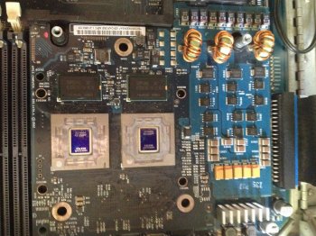

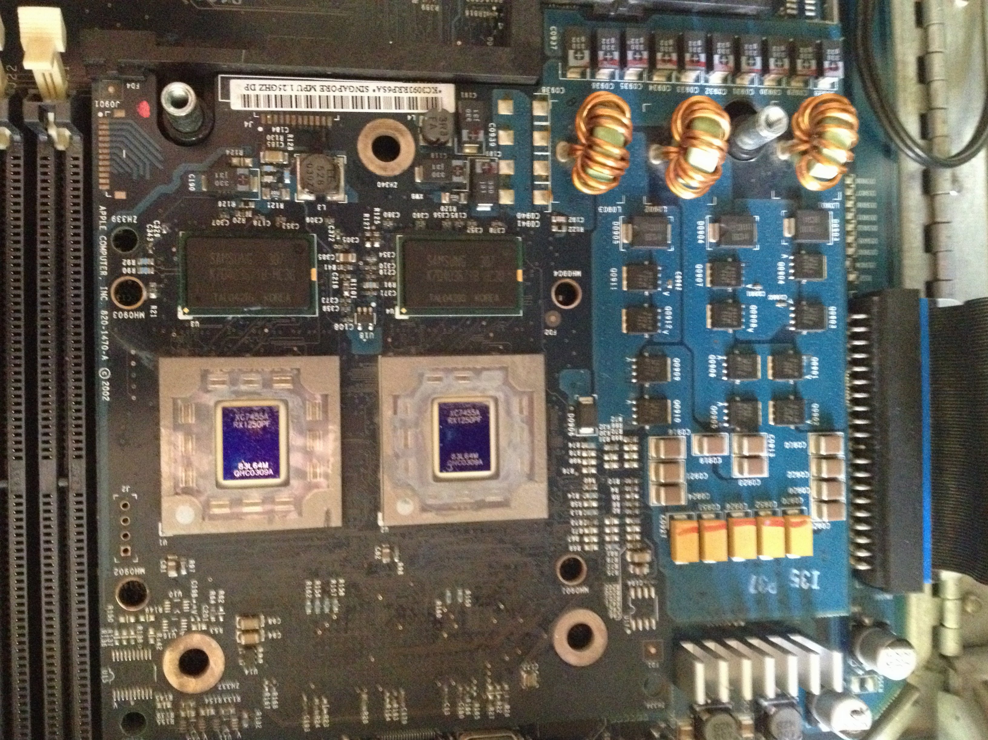

Hello everyone! I installed the new processor last night (picture below) and it seems to work so far. 🙂 Never thought a processor would die before a motherboard... I will post more pictures once I'm done with the (re)build. If anyone needs an MDD P/S, I'm getting rid of the previous ANTEC 500W I was using on this build. It's using an MDD connector so works out of the box (it needs a little love - some of the solder joints are showing their age). PM me if interested.

@abbotkinneydude In my Dell Dimension XPS T500, the old ZIF-type Pentium 3 died before everything else in the computer did. Luckily, I found a Pentium 2 with the same slot connector, so the computer now works again 🙂
Hmm. Interesting. I wonder if it overheated. My QS will not chime at all i wonder if the 1Ghz DP is dead...?
