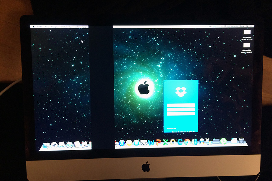

Hello! yesterday I changed to an ssd disk on my Imac 27" A1419 late 2012. I was extremely careful through the whole process. Anyhow after putting everything together i now have a 2inch wide black vertical line on the Lcd. Initially the dead bar was gray an after a while it became black an has been so ever since. The black bar come up immediately when booting. Anyhow the picture is good when connecting to an external monitor. I guess that excludes a GPU problem.
Judging from the attached picture what do you think? is it the LCD or the LVDS Cable?
I'm wanting to say bad LCD. Typically the the LVDS cable goes, the whole screen goes, not just one section of it.

Yes, something happened, but damn i didn't expect the LCD to be that sensitive. As i said we were extremely careful!

Ill try replacing Lvds cable first, its worth a try!

First off, try reseating the LVDS cable, and check the connector on the MLB for damage.

I already tried to re-seat the cable twice, no success. I also inspected the connector and everything looks ok.
While changing to SSD we carefully put the LCD on the couch. (Two persons lifting)

Nope not yet checked the connectors and replaced the LVDS cable without any success.
New LCD is on its way, I should receive it within 2weeks and I really hope it solves my problem.
