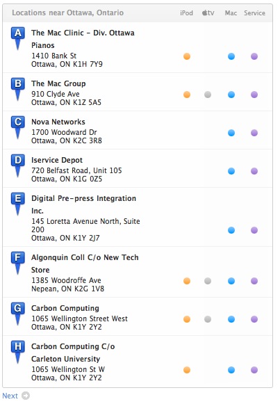

Authorized Service Centres
Well, how about these service centres?
I'm sure you have your receipt. Anyways your computer is less than a year old. Just do a little research about which one is better with mac stuff. They will help.
Good luck
btw, it is www.apple.com/ca/support
I don't have one in my university, not that I know of.
By unreasonable crap, I was relating to issue that happen without a reason, which we, ex-windows users, probably are well aware of.
I guarantee you have a tech shop on campus. As far as "unreasonable," all computers have hardware problems. I'm sorry Apple's marketing department convinced you otherwise.
