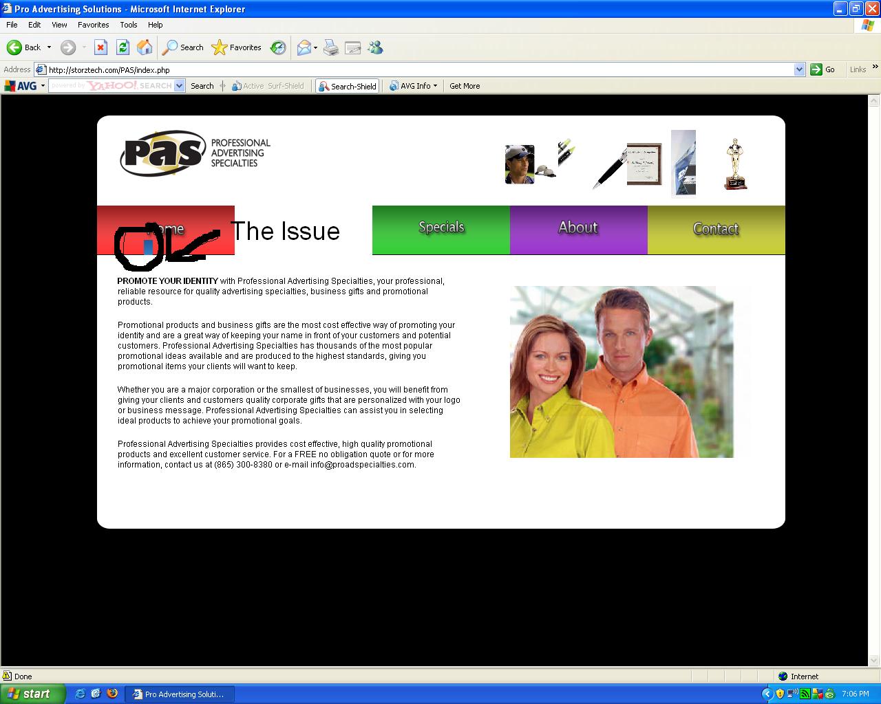

Ugh... I really don't like IE6. It works in every browser except IE6. Here is what is wrong.
I am creating a horizontal navigation bar out a styled list, with a different background gradient on each button and on top of it is a PNG that has the text on it. That PNG has a script that increases the margin on it to make it move onmouseover and a script to fix IE transparency issues.
All of that works, except for the fact that in IE6, the 2nd of the 5 buttons gets wrapped below into the first button and the first button is having issues because of that. The other buttons work great.
Here is the URL: I made a redirect page for this to hopefully avoid Search Engines from crawling this page. I doubt it will work, but oh well.
Here
I'm going to edit this post with a print screen in a minute.
EDIT: The print screen is attached.

Your redirect page didn't work (error 404, page not found) so either include a working link or please import the scripts in question so we can looksee.
Ah, much better.
I don't have IE6 but I believe ya that it renders oddly. I am pretty sure I know why, here is the relevant page source, copied verbatim, look carefully at the end of the 4th line:

Look specifically at the "</" just before the closing div. This typo is fudging up MSIE 6.0 which parses differently than other browsers for this situation (incompleted closing tag). Fix that, it is apparently supposed to be a closing anchor tag, i.e. </a>. Typos will get ya, every time. I know, I've made this kind of mistake a million times, so have we all.

Please note for the record the typo I found is at the precise location between first and second button the OP described the problem with MSIE 6.0 as follows:
...2nd of the 5 buttons gets wrapped below into the first button and the first button is having issues because of that. The other buttons work great...
I am not saying there aren't issues beyond this, or the JS plays a role, but when you say, "Its your javascript" please consider that I checked the JS code (FFox with the web dev add-on, those who use it know what I mean) and it does not target a specific content element by ID, otherwise all the png's would be affected and not just one or two. The OP also uses the popular MooTools library used for a slideshow integration, based on the code comments, FYI.
No harm, no foul, just noting the problem stated was asked and answered correctly (syntax issue with anchor tag), I'm pretty sure at this point that has to be fixed first before debugging further.
-jim
