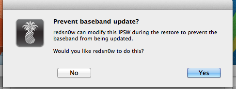

I tried to restore but when I selected my ipsw file the following window popped up -
what to do? yes or no?

For the preserve BB select YES
