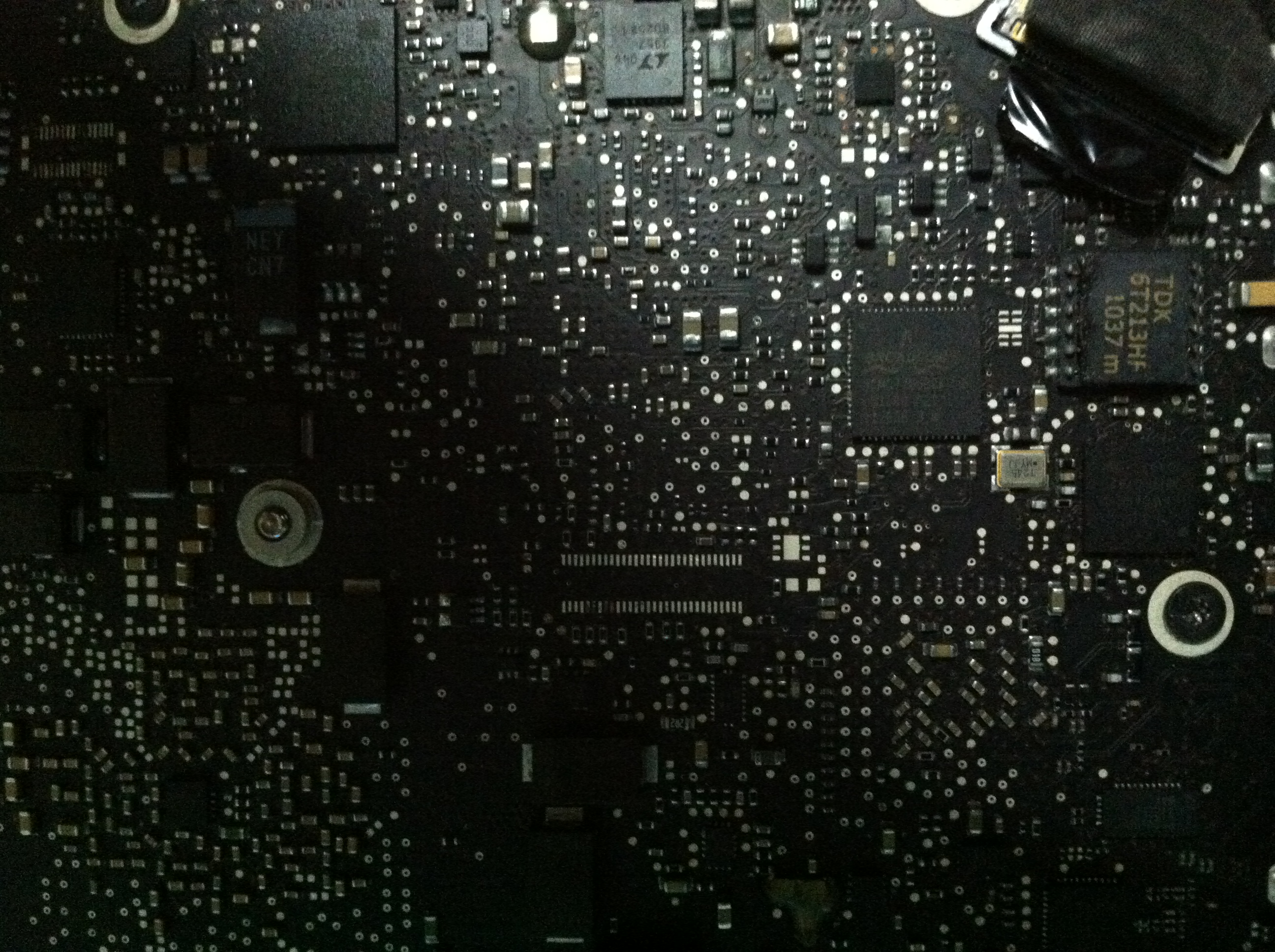

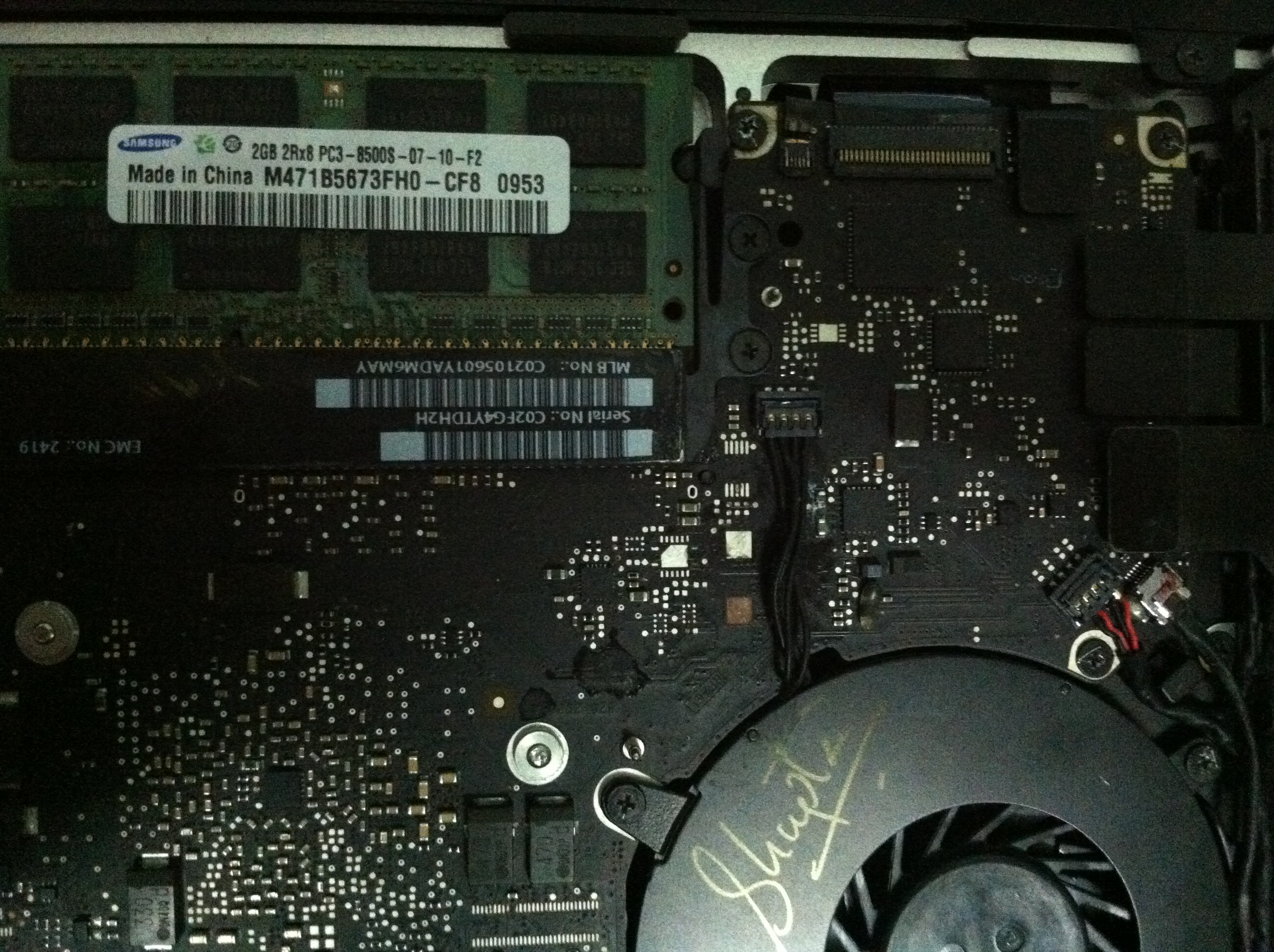

Heres whats corroded
i see this part corroded and the other one
seems to be water damaged and the first one when earthed shows a voltage of 13.1
battery Pins 3-6 Also Give 12.8 V without magsafe and even with magsafe.
