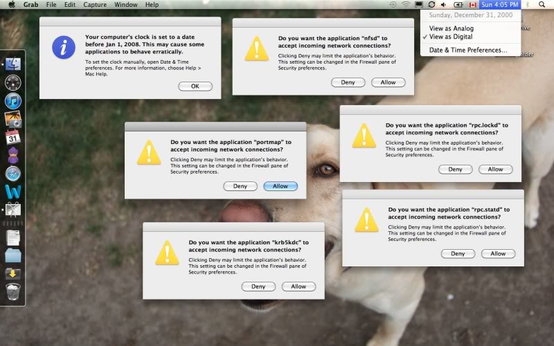

When I started up my MBP this morning I got a series of pop up windows that made me a little uneasy. Since then they have been unceasing and disappear before I can click deny. I have since shut down my computer and am resorting to using my boyfriend's PC...
Any help would be appreciated. It looks like someone may have hacked my computer or something...

Some more information is needed. If you could get a screenshot of these pop-ups, or maybe even tell us what these pop-ups are asking we might be able to help you.
Those are notifications from your firewall, asking if you want different apps to accept incoming connections, and blocking your date from being updated. Try rebooting. If it doesn't clear up, look at your firewall settings.
Look like you have the firewall enabled.

Those look like notifications from your firewall, asking if you want different apps to accept incoming connections. Look at your firewall settings.
They aren't website popups.

There's the image as it should have been. There's a link on PhotoBucket for IMG code, off to the right, which you can just copy-paste right into the forums for next time, btw.
Looks like at a bare minimum you may have trouble with your battery, causing the date popup. The others are from the built-in firewall, I don't recognize all of the processes, but they look fairly normal to me. Someone else here may have a better idea.

PRAM has nothing to do with the battery or power. That's SMC. The date issue is from the firewall blocking the date from being updated.
The date is from the firewall, as well. See my earlier post.
It should still display the correct date as it was when the computer was last powered on, even if it can't reach the update server. I suspect there's still a potential problem with the battery. Depends on how old it is, I guess.

I just tried that. I don't know when the pop-ups are supposed to stop but I still got all of the same initial ones so I don't know if it helped or not.
Another thing I haven't mentioned is that my internet connection has been inconsistent. I keep losing my connection when I'm trying to do stuff while the boy's PC is connected perfectly fine to the same internet. I get all of the pop-ups the moment I reconnect to the internet.

Why are you choosing to ignore the questions about your firewall settings? Your pop-ups relate directly to your firewall. Not your battery. Not your user account. Not PRAM. You need to look at your firewall settings and tell us exactly what is selected. That is the source of your problem.

So going into advanced under firewall...
I have "automatically allow signed software to receive incoming connections" checked and everything else unchecked. And in the list of applications everything is set to "allow incoming connections" except the initial pop-ups that I got and immediately clicked deny for.
Because I misinterpreted "disable" as turning it off and I wanted to avoid having to turn off my firewall.
Who said anything about disabling it? I just asked what your settings are. As it says on the firewall tab, Mac OS X normally determines which programs are allowed incoming connections." You can select specific apps to allow or block receiving incoming connections. For most apps, it's fine to allow. Don't block an app, just because you don't know what it is. All the processes listed on your screen shot are valid components of Mac OS X and should be allowed. Go back to the ones that are blocked and unblock them.
