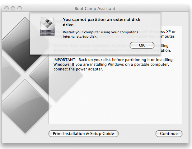

Hi all first excuse my english, so heres my problem, when I try to use bootcamp I receive this Cannot partition an external drive but this is not external.

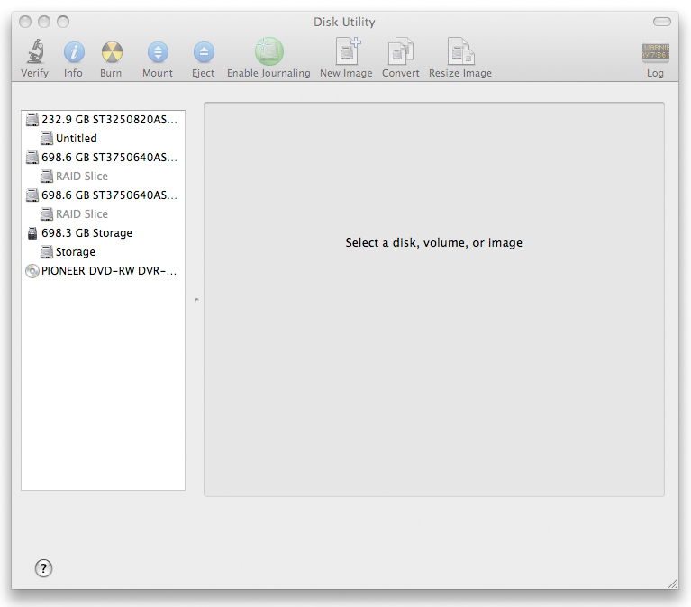

So to help you understand the setup I have include a jpg of disc setup on the computer i think there is a mirored disk cause if I start with the option key I have to disk storage 1 and storage 2
I just want to boot windows to ru my rc flight simulator but now its looking complicated 🙂 or just tell me how to remove that duplication
so please I need help on this

I'm afraid, if you have your Mac OS X installation on the RAID array, that you only have 2 options:
1. Make your startup disk not part of a RAID array by moving it to a non-RAID disk then booting from that.
2. Dismantle the RAID array.
I have found the way 🙂 i had put another hd in my computer and boot camp has start

how do you dismantle the raid array if you have a raid card... is it possible? I have 2 drives using raid, the other 2 drives (bays 3-4) are not in raid but still do not work with bootcamp
