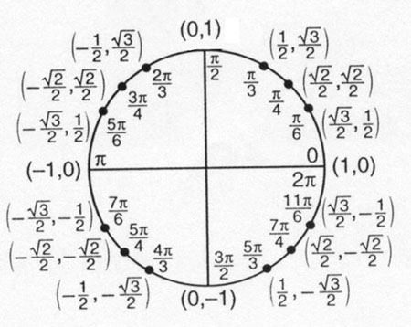

or you could ask where cosine is equal to zero on the unit circle.
the x coordinate on the unit circle is a representation of cosine.

cos(Y) = 0 when Y is an odd multiple of pi/2 that is when Y = (2i - 1)*pi/2 where i is any integer.
thus in your problem cos(2*pi*x) = 0, x = (2i-1)/4 where i is any integer
